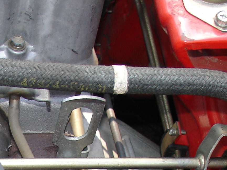

Randy, I thought that white ring was a piece of cloth tape - I guess I'll need to look at mine a bit closer. Can't tell for certain from this close-up, and don't have the car with me today.

Arne. You are correct. After 40+ years the tape on my hose disintegrated and some melted into the weave. I thought it was paint, but after speaking with Jay last evening he also informed me that it was tape. Mystery solved. Thanks Arne.

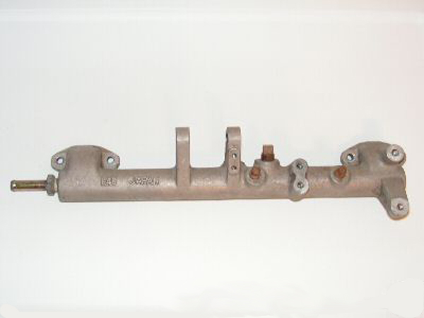

Here is a picture of the E46 balance tube with the connection on the end. I think the e41 type balance tube has the connection on the top? Or both end and top?
Edited by 26th-Z
Thank you for the picture. As it is shown, E46 on Most Series 1 car have inlet on the side. E41? Series 2 and 3 have inlet both at the top and side.

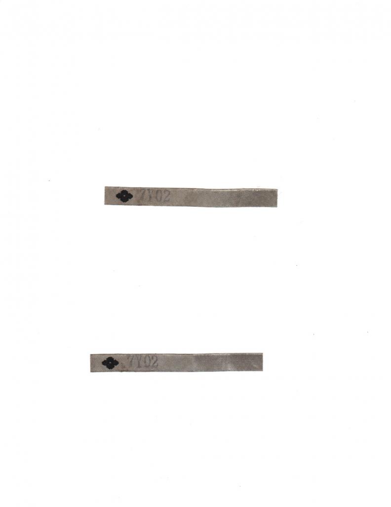

Arne, Ive got some cloth tape tags that came off of OEM NOS Nissan braided fuel line. I would like to upload a scan of these from my PC, but have not got a clue how to get this scan into my photo album. REALLY GETTING **%$^&*@#$%$#$$FRUSTRATED!!!!! This new format just isn't working for me. Can't find anything. CR*P!
Well, got that out of my system.
Dan
Thanks, Chris. I'll give it a shot.
What-da-ya-know......It woiked.
These cloth tags that I have appear to be a soft, shiny silver, silk fabric with an adhesive on the back.
Dan
Thanks, again for the great prompts for my pics, Chris. Just took a close look at my balance tube and found "E46 JAPAN" cast into the underside. When compared to your picture, Chris, this would be found on the other end and opposite side of the balance tube. Needed a mirror and flashlight to see it as it is on underside as mounted in the car. The other difference is, it has both hose connection locations, top or end. The end port in mine has a threaded plug, and the check valve to balance tube hose is connected at the top location.
And, again, my car is one of the very last series 1 cars (vin# hls30 20419).
