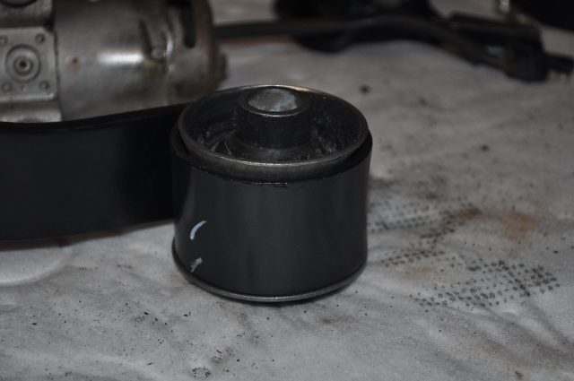

In short, they solved my problem. They actually made the correct tool (cone shaped flaring tool) and them pressed the flare into the bushing. It is not actually flat against the mustache bar, but there is no way that it is going to separate.

Mike.post-19584-14150814310419_thumb.jpg[/ATTACH]
I have done it with a hammer on several times and I doubt you could spot the difference. And then there's the fact that those surfaces are hidden once installed.

Would like to add my experience with replacing the OEM bushings in the mustache bar. Mike was kind enough to loan me his bushing tool and it worked great. I acheived the flare that I wanted with the bushing tool. I also used the "drive" end of a 2 1/2 inch socket to continue the flare down more. Once I did this, I used the other end of the 2 1/2 inch socket and continued to flatten the bushing all the way down. I am very pleased with the results. All of this was done using a 20 ton press. Ride is great and rear end noise is 100x better than with the urethane.
