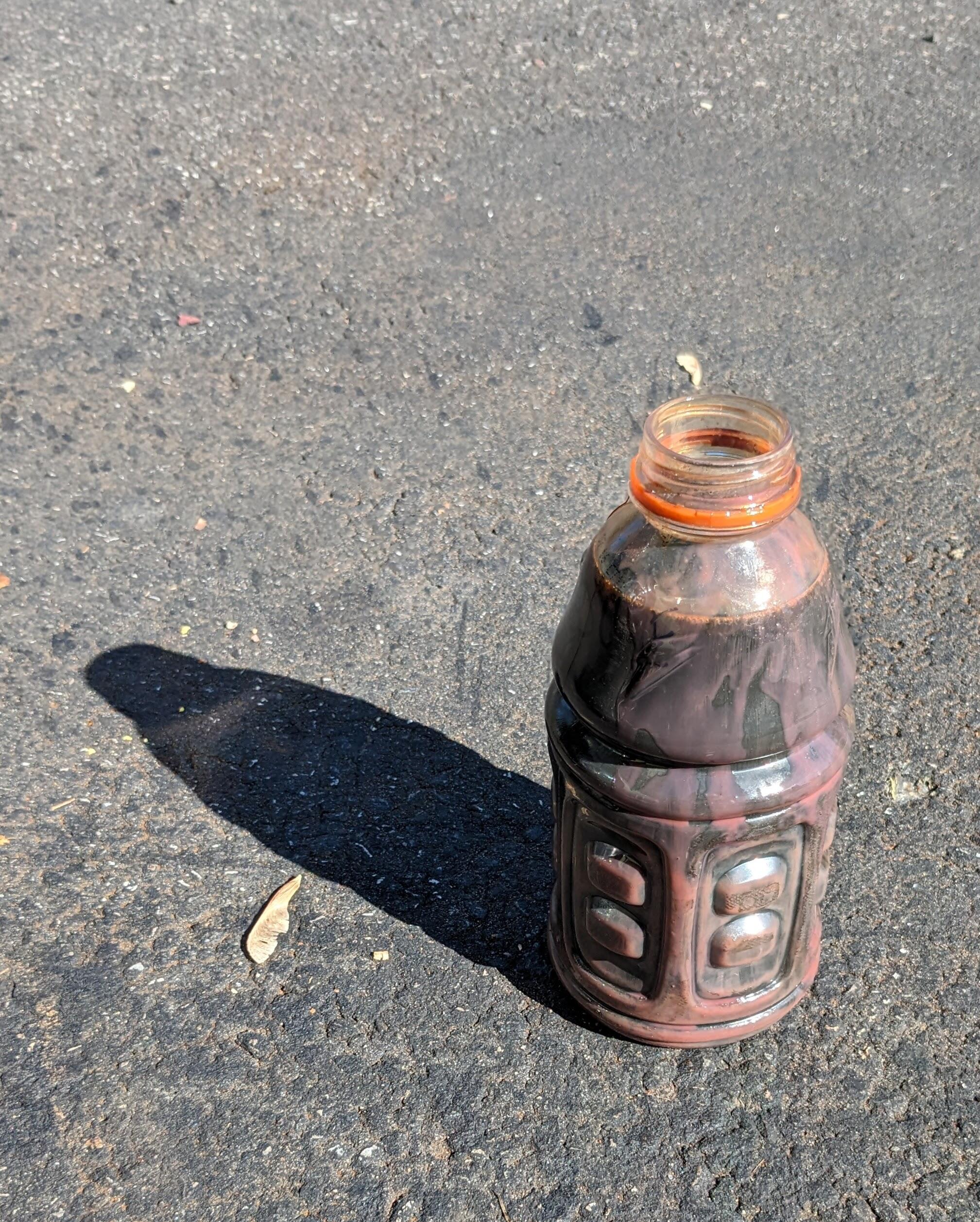

A heat gun for a few minutes then 11/16's open end wrench tapped with short sledge hammer got the fill plug loose. It held 1 and 1/2 qts. Redline 75w90. The old looked like Sunkist and Coca Cola mixed coming out, kinda rusty brown. Thanks for the help.

My old fluid looked like Sunkist and had about the same consistency. I'm sure it was low but everything under mine was dry. It'd just been sitting for 10 years.

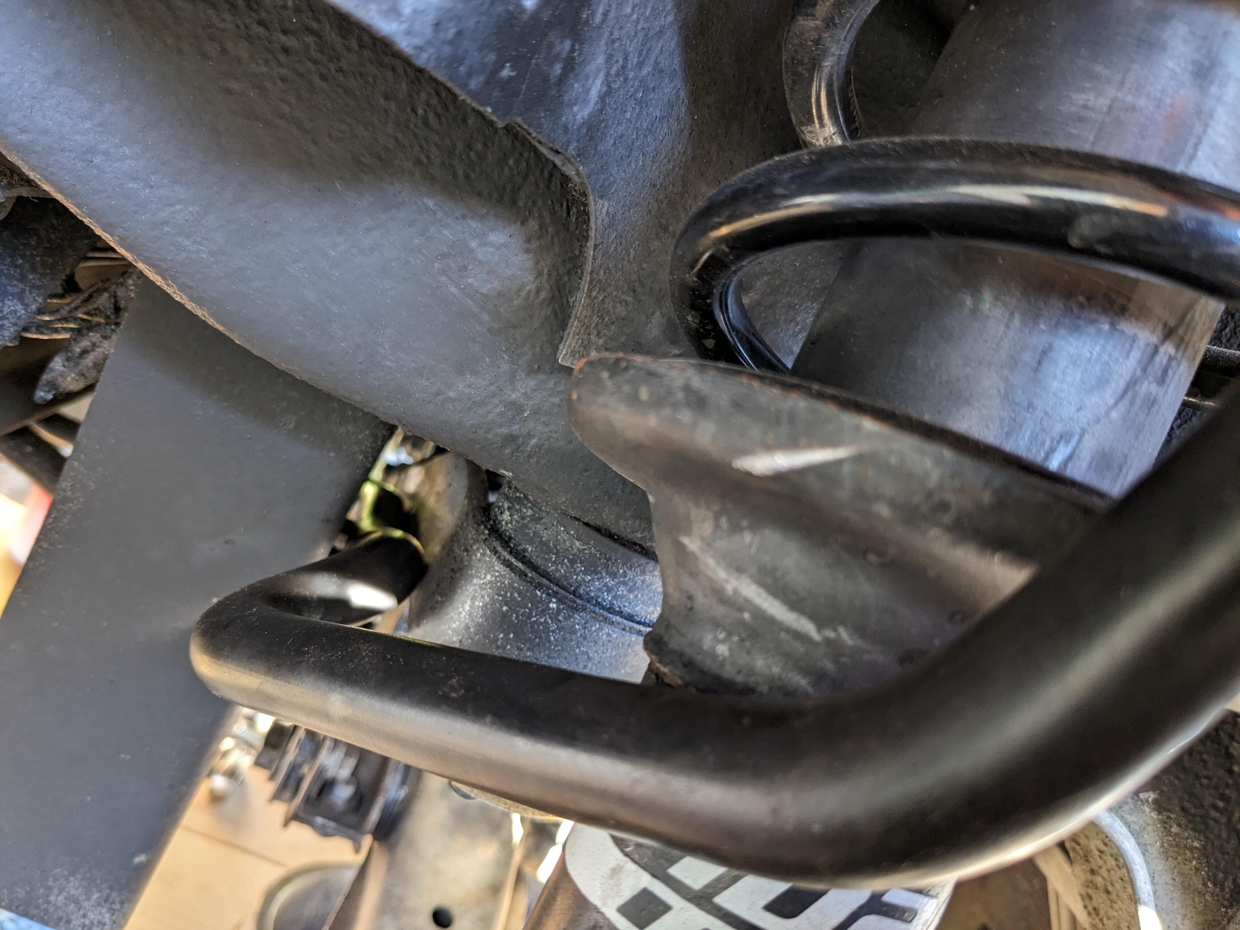

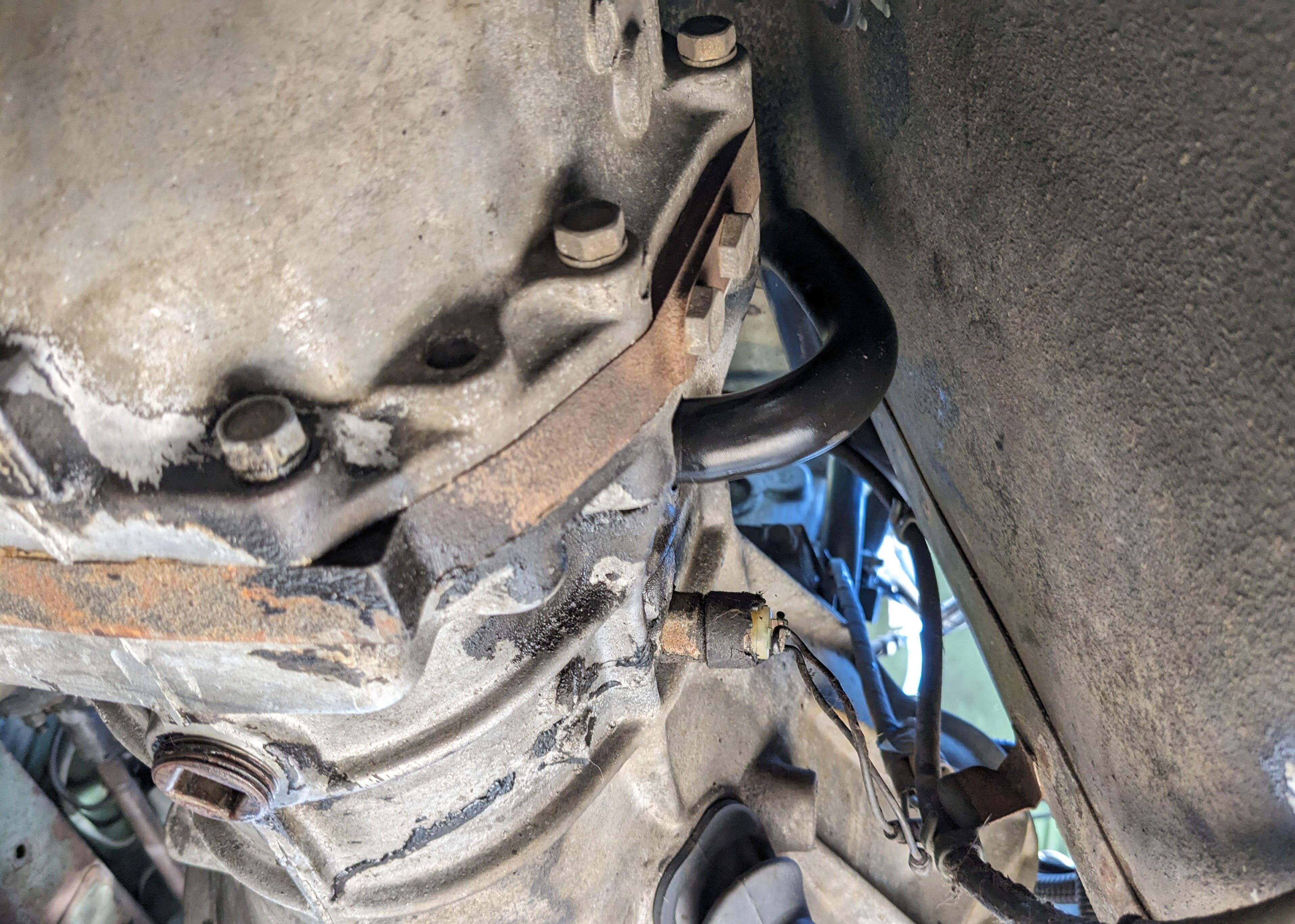

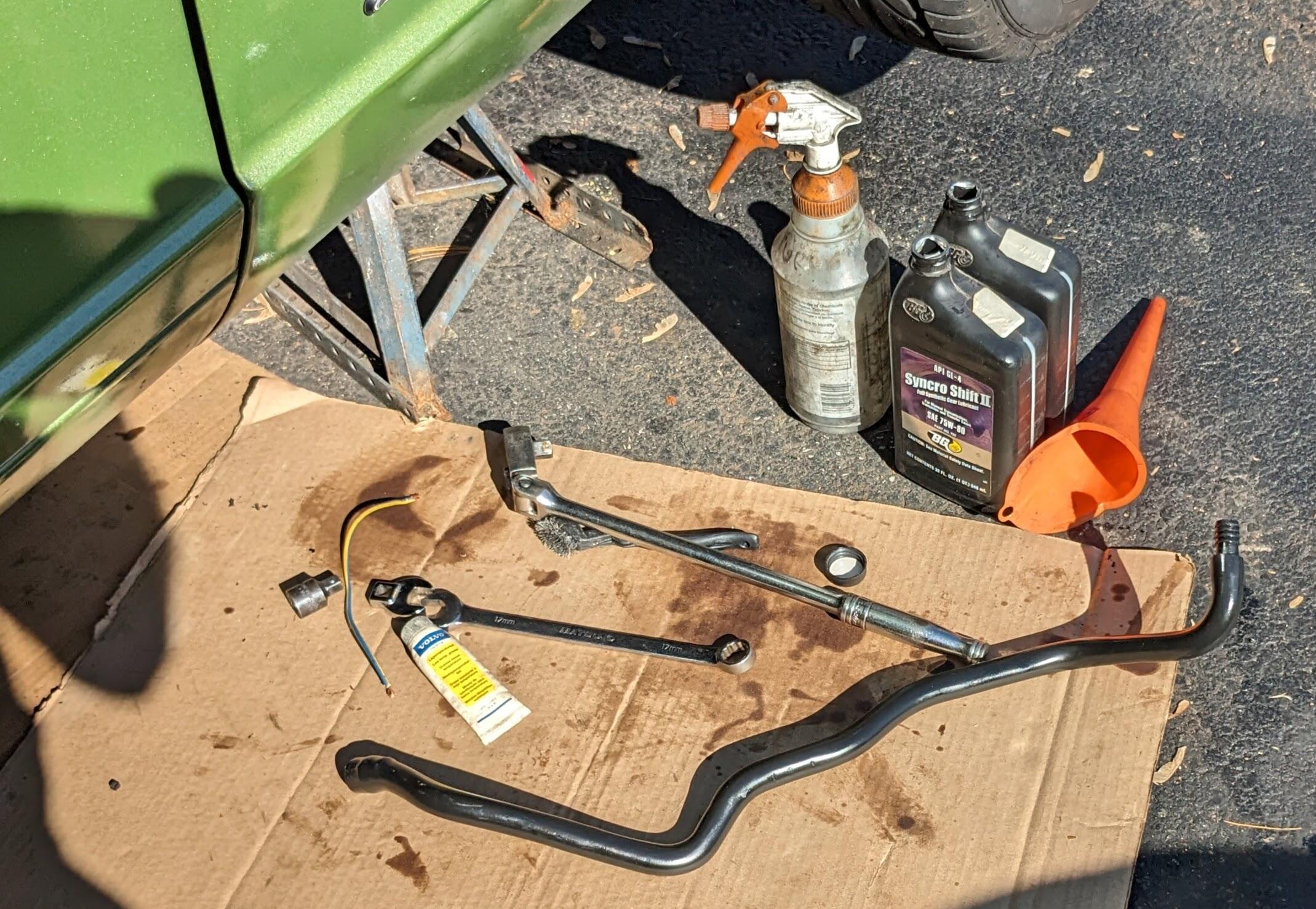

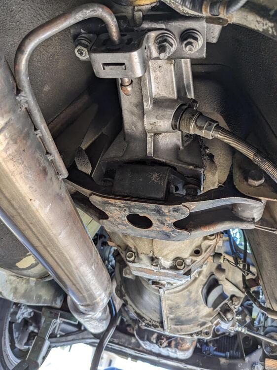

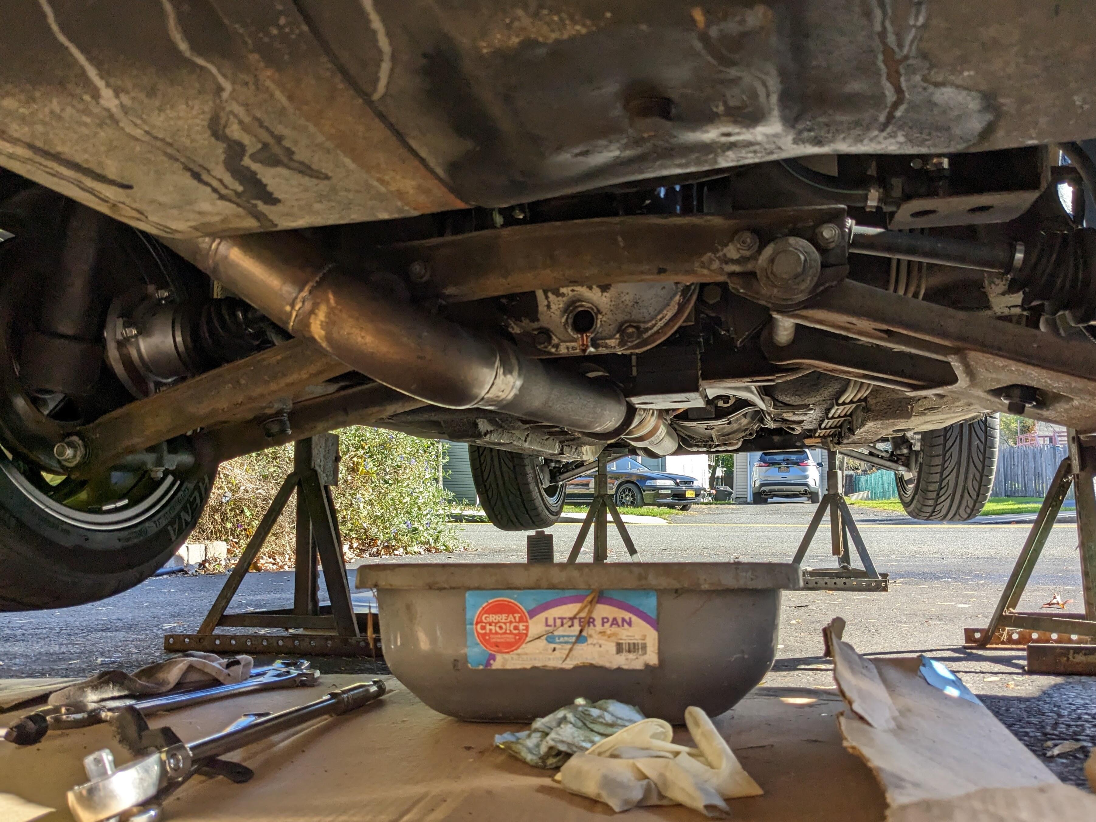

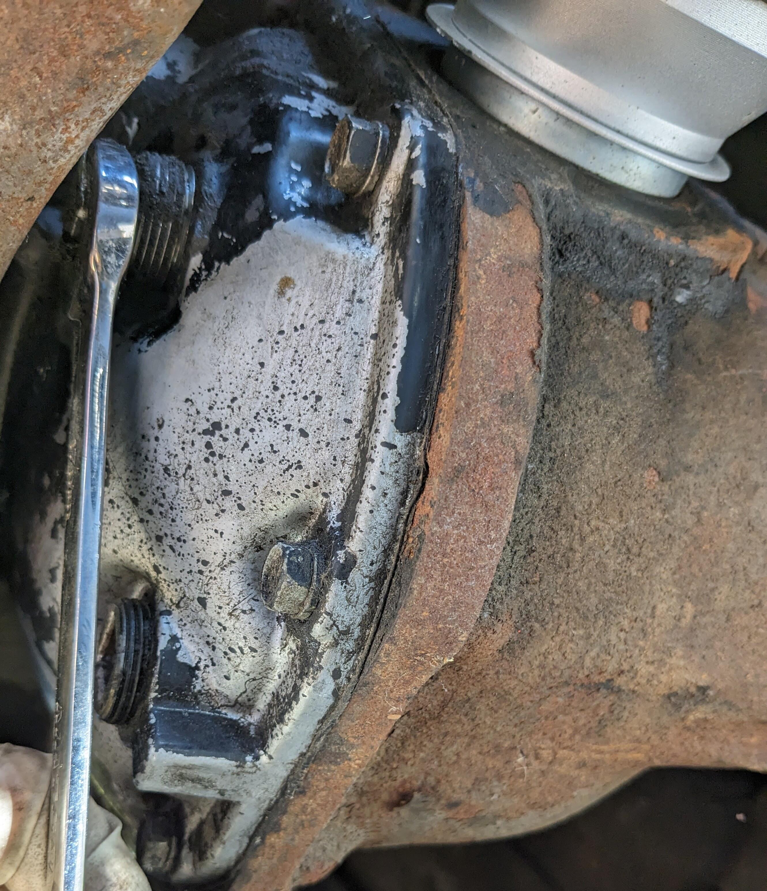

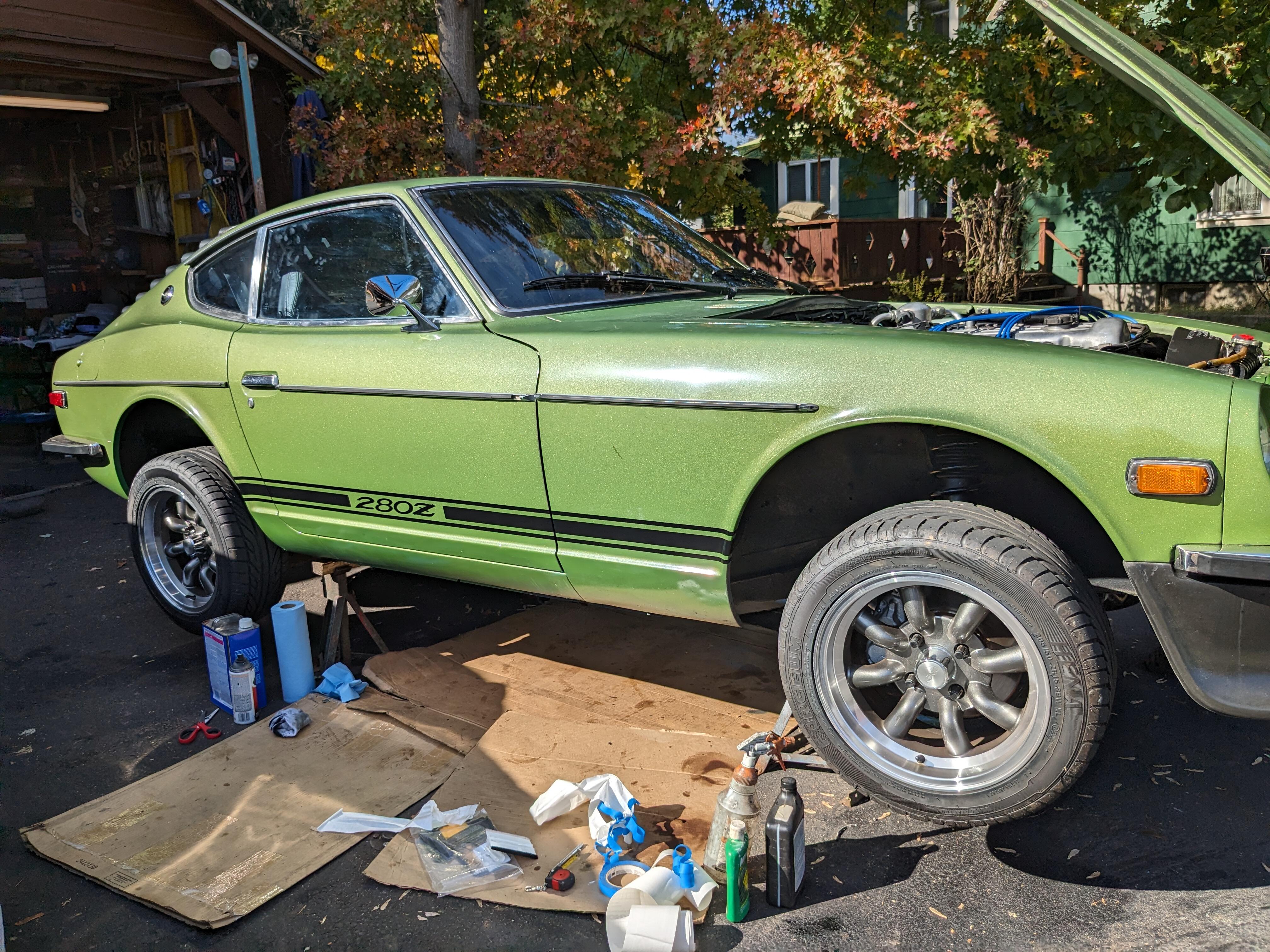

I was nervous about doing this today - given the posts talking about difficulty of removing the plugs.

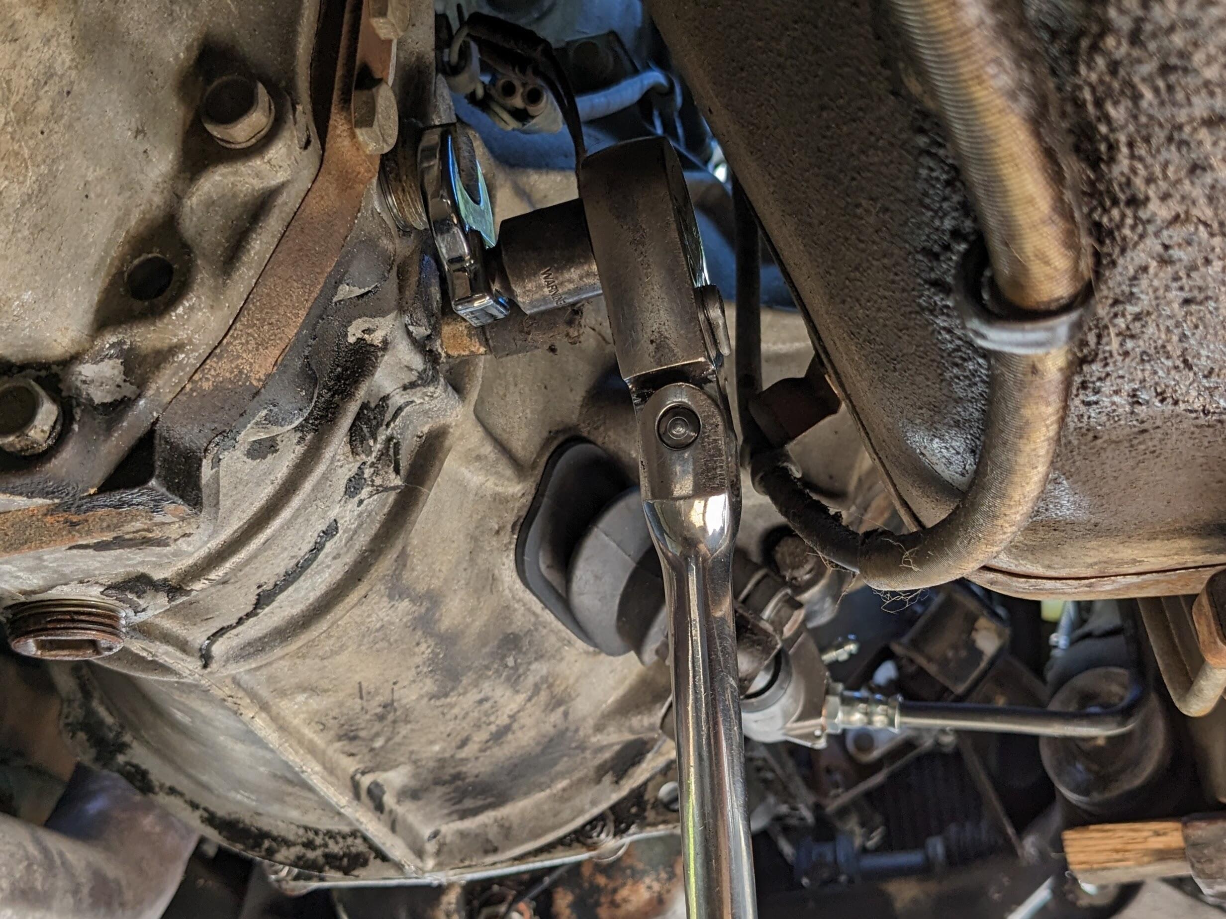

I used a 17mm crow foot w/the 1/2 drive ratchet on the trans, 17mm wrench with another wrench hooked over it for leverage. Both came out without any real drama.

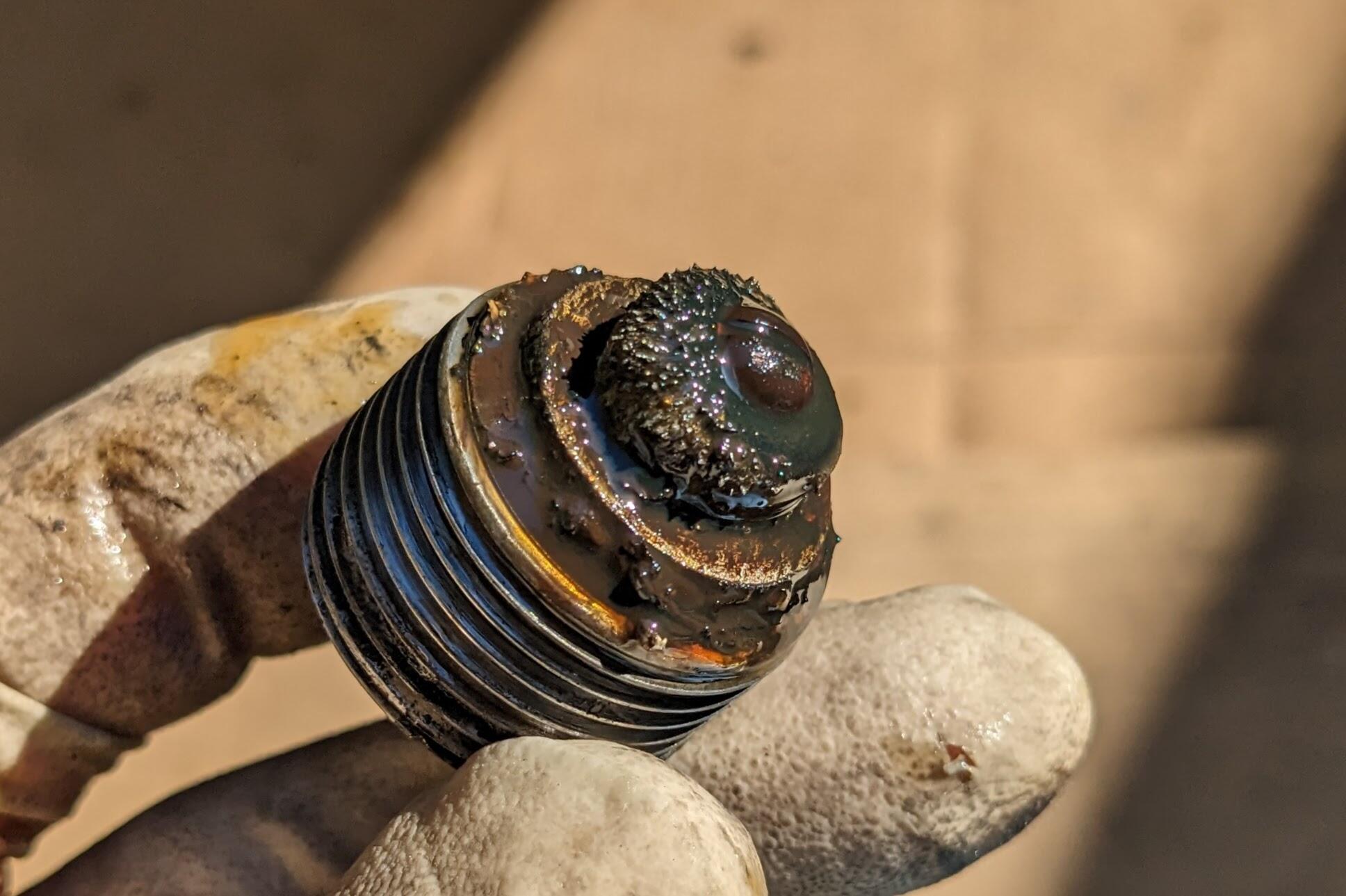

diff drain - some metal particles

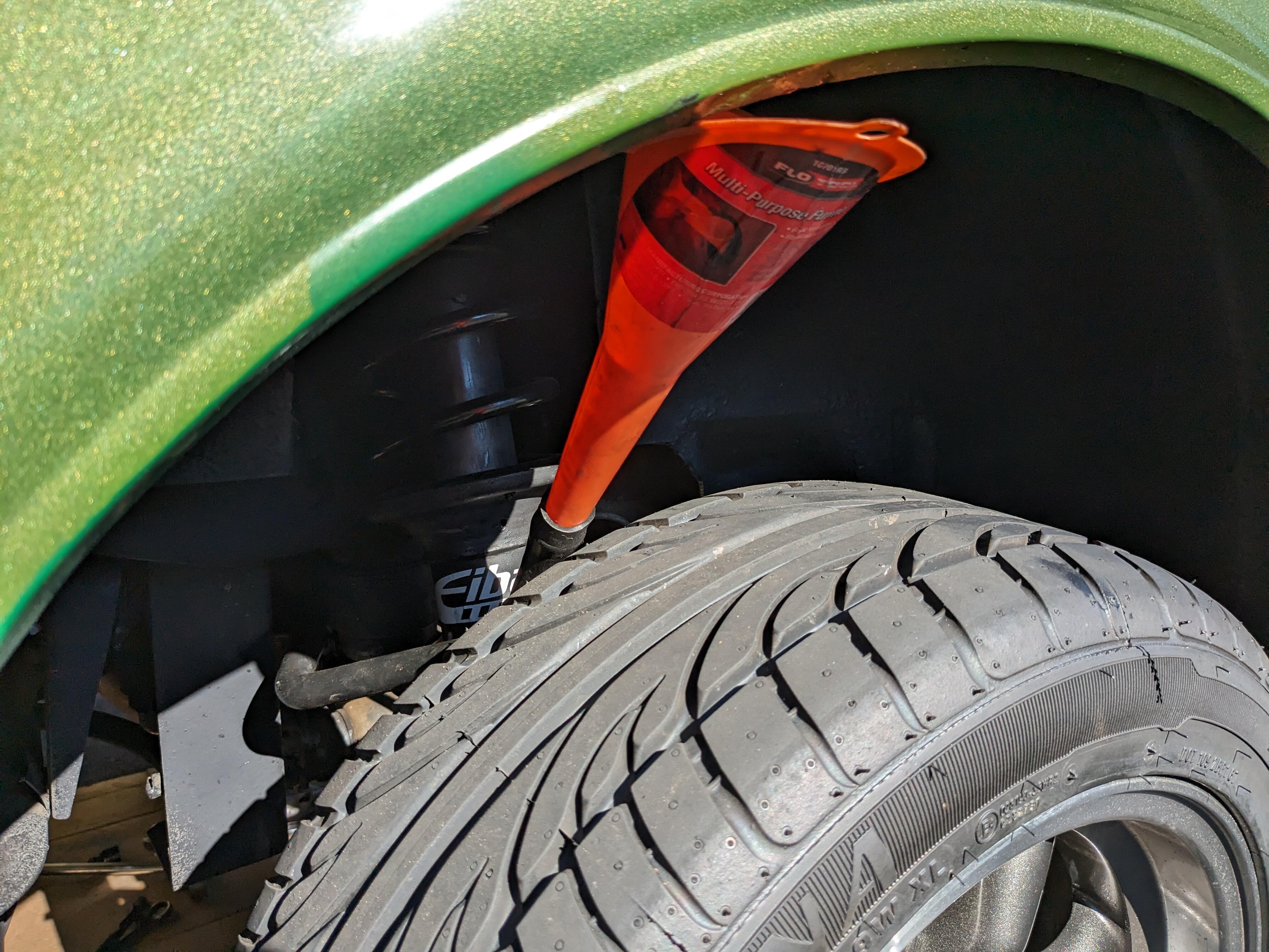

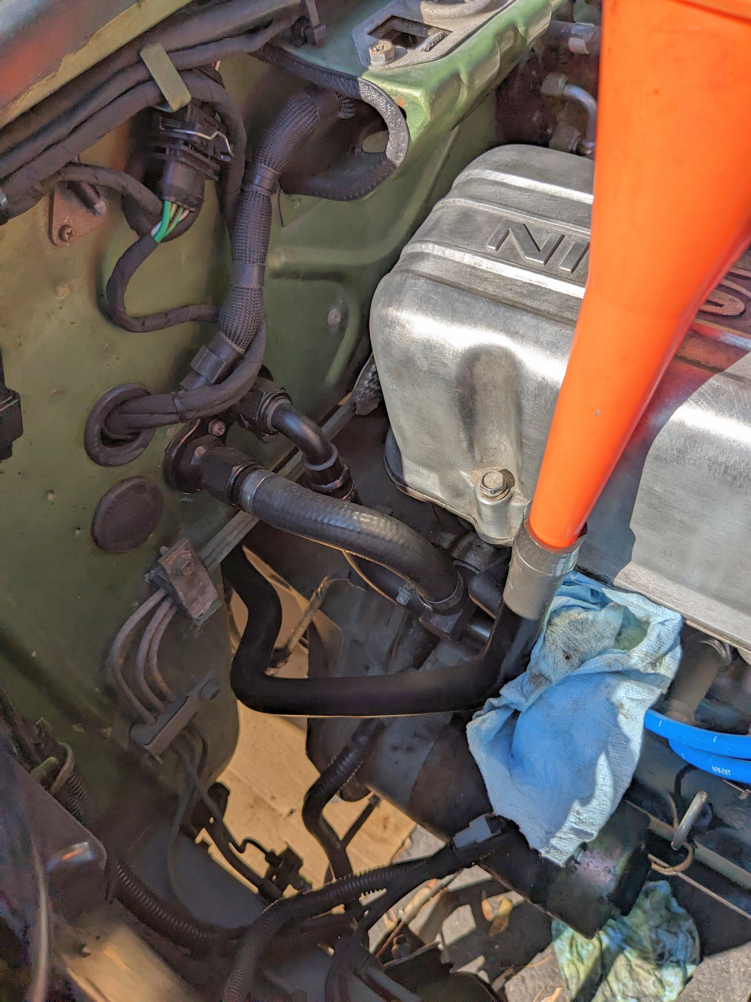

I used my trusty transaxle fill tube- it's a crankcase breather hose from a 90's Volvo
Diff took about 1.2 quarts (GL-5) before it started coming out the fill plug
trans
Trans took 2 quarts (Gl-4) - just started dripping out the fill plug with that
only got one quart out of the trans
Found that the reverse light switch is dead - easy to test since I had it in the air

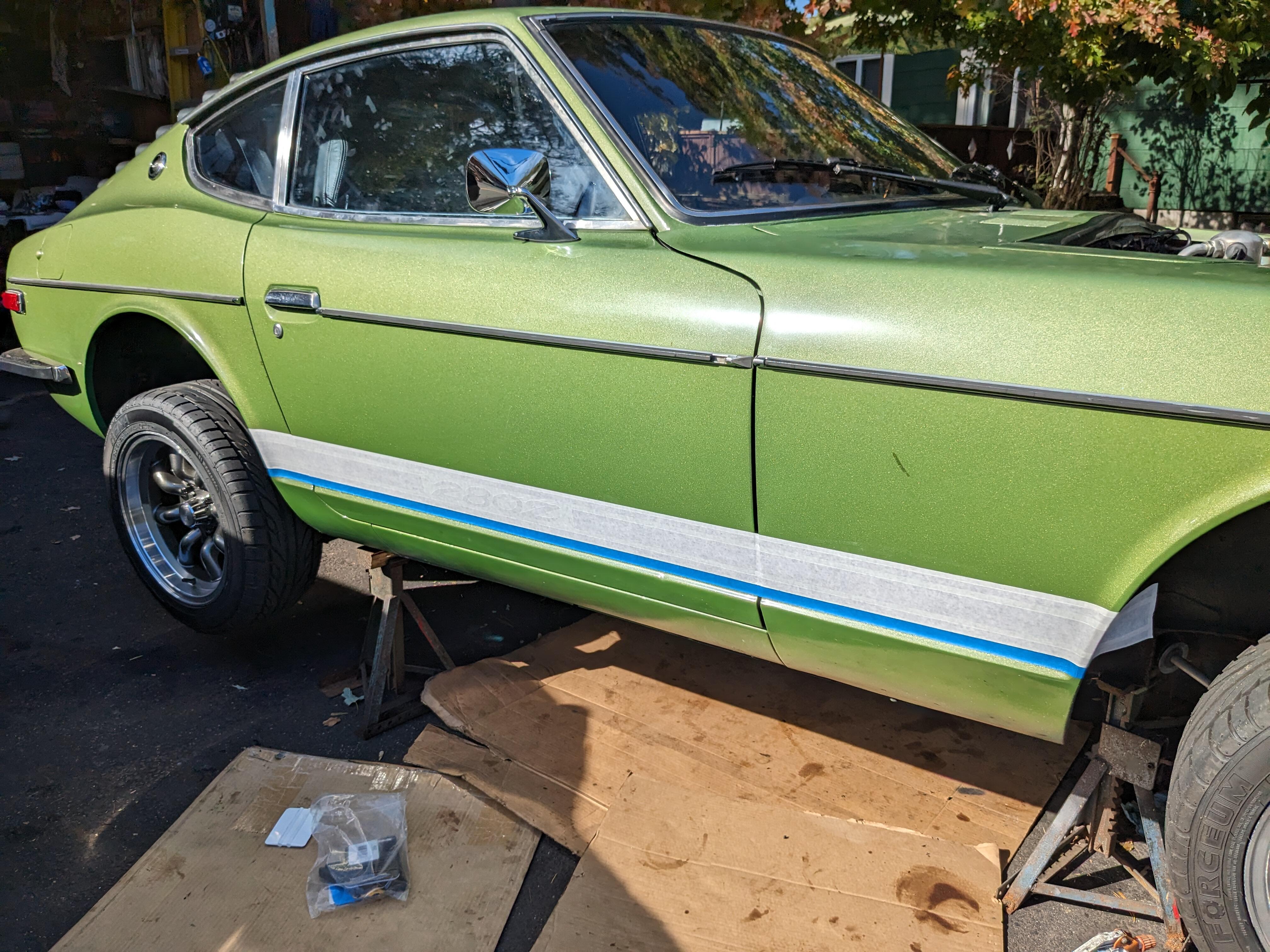

While I had the car in the air, and the temps are back in the 70º range,  I got the side decals on.
