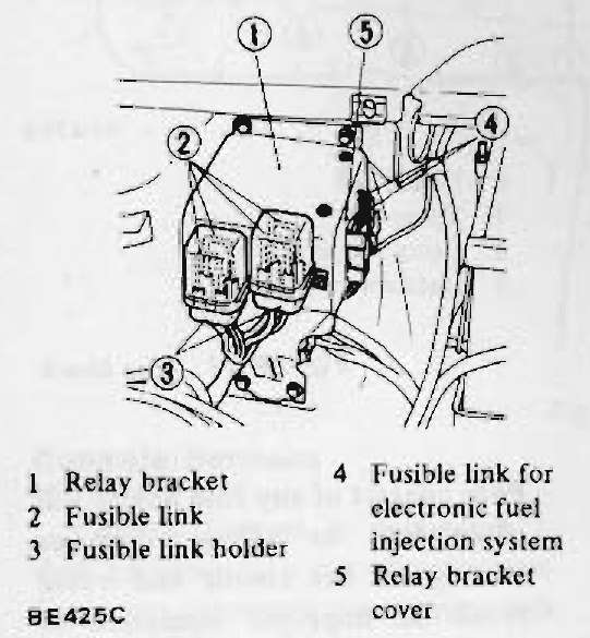

That would lead me to guess that you're talking about the holder for the fusible links. (See the attached diagram.) If you are talking about the holder, I haven't tried to glue one back together. You could probably get a used one from Z Barn. Heck, you could also probably talk me into helping you swap it out.

Steve, sorry about that, it's a 1978 280z and I'm talking about the fusible link holder. How do you swap the holder out, aren't the wires encased in the holder? I'm heading to Gainesville tomorrow afternoon to pick up a set of mags. I'm in Braselton.

To be honest, I've never tried to take apart a fusible link holder. It shouldn't be too difficult with a reciprocating saw. ;) There is probably a barb on the terminal that locks it into the holder. With a little work, you should be able to push it out.

Replacing the stock one with another stock one requires you cut and splice the wires. The base has molded in contacts. The high currents carried by these wires require that you do proper solder connections and properly insulate the exposed wires or you'll be doing this all over again real soon.

As Jim pointed out, with the moulded case we can't just push the wires out. Given that, the maxifuse mod may be a better solution since there wouldn't be splices involved.
