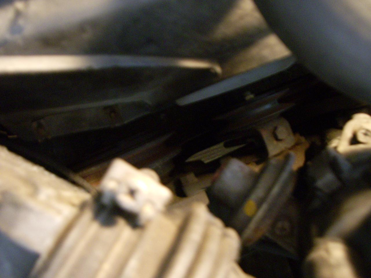

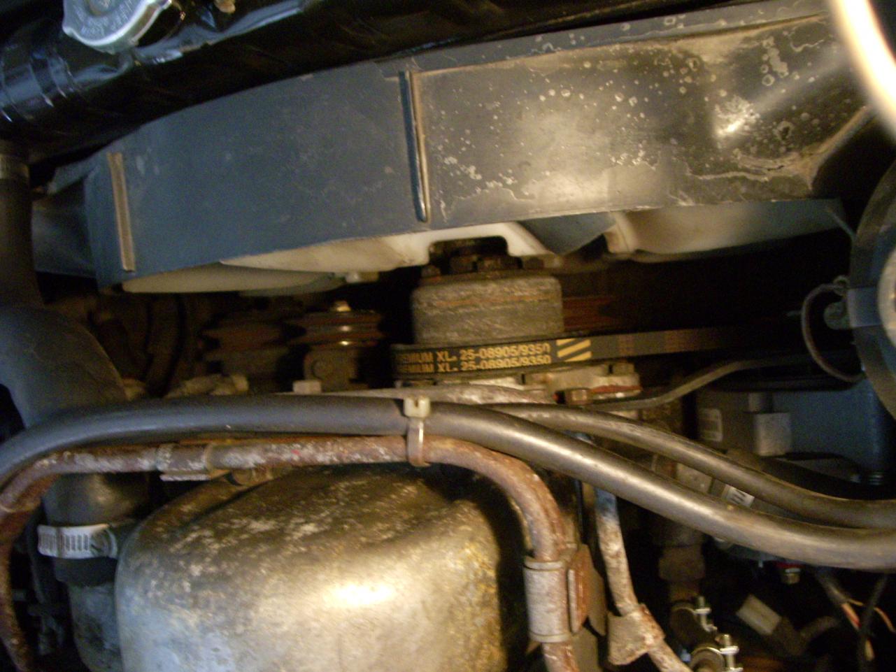

Took a picture of my belts...or lack of belts. I think its a loose belt - It squeals when I press the gas but has nothing to do with clutch movement.

By the looks of your picture you have no A/C belt. From what you stated above (or what I got out of it anyway) is that when your car is cold and you start it it makes a squeeling noise. If you seem to be loosing power it could be that either your water pump and/or the alternator bearing is seizing.
This is my way of figuring it out. If Z's are anything like all the other cars I've worked on you should be able to run your car without the belt for a few minutes. (or seconds as that's how long you said it lasted). See if you hear the sound with no belt.
