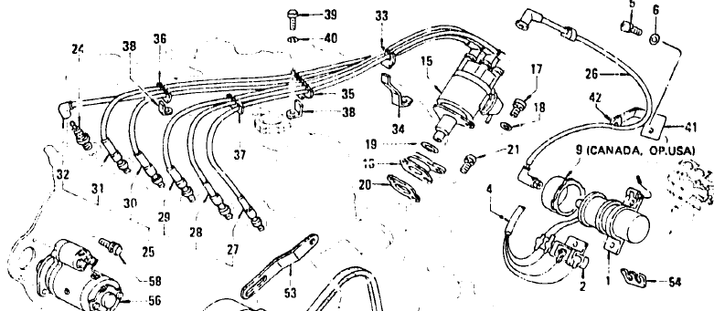

Searched many ways for this info and can't find it nor the brackets on any of the popular parts sites. I got the new (4) plastic clips that hold the plug wires and then realized I don't have brackets for two of them.
I have the rear bracket thats screws into the valve cover that the three wire clip slides into, but missing the bracket on the valve cover that the 6 wire side-by-side clip slips into, and the last bracket that holds the 6 wire clip (two rows of three) not sure where it mounts to, even after looking at many engine photos. I know the three place floater doesn't need a bracket..
Am I missing something on the parts sites? It's easy to find the plastic clips but can't find the brackets! Thanks!

Try a Nissan dealer.The one that bolts to one of the thermostat housing bolts (#34) is part number 22473-N3000. The other two (#38) are number 13241-65000. It looks to me like the small ones are still in stock in Nissan warehouses. The larger one might be NLA, so you may have to find a used one.
Edited by Arne
Forgot the attachment
If you have a vice, a file, power drill, pliers and a hack saw, you can easlily make one if you can't find the bigger one.

Thanks all, I could fabricate one for the valve cover since I have one of the two and a patern to work off, but the larger one that attaches to the T housing, I'd rather have an OE one, or at least a good idea of what it looks like.
Diseazd, I can't find it on the MSA website but will give them a call. Then I'll try Nissan dealer, then used, then fab if all else fails.
I'm replacing the therm housing (stripped threads for the cover) so wanted to get the bracket that bolts up with the housing so I can get it all buttoned up... and try to start it for the first time!
