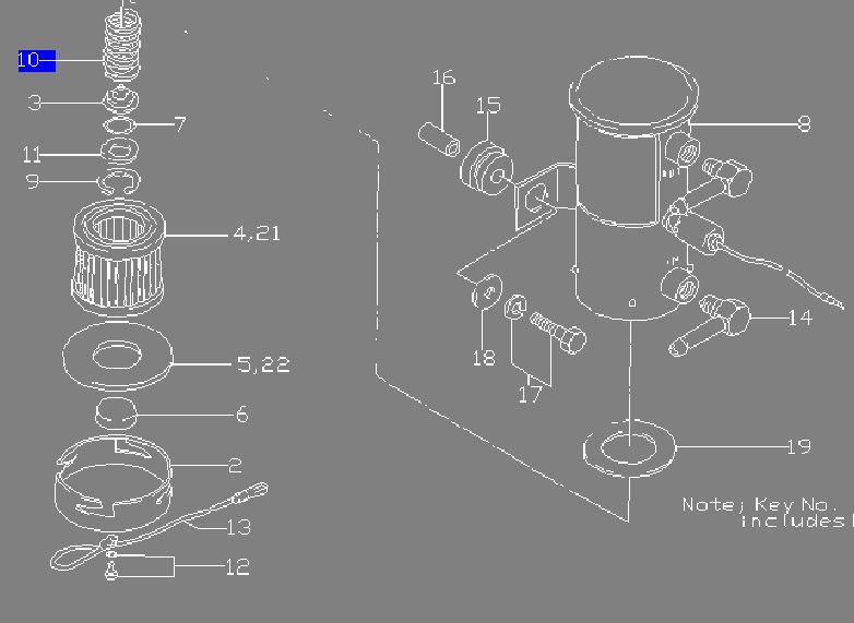

I'm not sure if you mean the fuel filter or teh fuel screen in the pump.
Fred
Assuming the elec fuel pump looks like the one in the attached pic, the bottom just twists off. Try hitting the joint with some penetrant to loosen things up and apply force with a strap wrench or a pair of channel locks if you don't care about the finish. You can also try tapping the base with a small hammer to break it free. I recommend removing the base while still mounted to the car and DO NOT recommend placing it in a vise.
Thanks for the tips and diagram guys. I am in Alexandria and my nephew (and the Z) are in DC. By the way, back in '71, I tried to test drive a Z, but they were so in demand in my hometown in Ohio that there were none in the showrooms. You had to put down a whopping $100 deposit (don't laugh, that was serious cash in '71) and give them four color choices. They'd call you when your name came up. They also arranged with a few previous purchasers to come in on weekends and paid them to give test drives to prospective customers. Never did get my Z. Maybe my nephew will let me drive his.

Fred -
We managed to remove the electric fuel pump, but couldn't figure out how to remove the filter for cleaning and inspection. With no direction in the manual, we didn't want to force things and break the pump.
