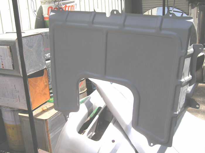

If you want the silver look then Eastwood makes a paint called Tank Tone that really gives it an original look. It comes in a spray can and is easy to apply. It dries to a more of a flat finish than a gloss. Generally you will find that the original color on the pans that were installed at the factory were a silver color and the black ones are the ones that were replacement parts from a Datsun dealer.

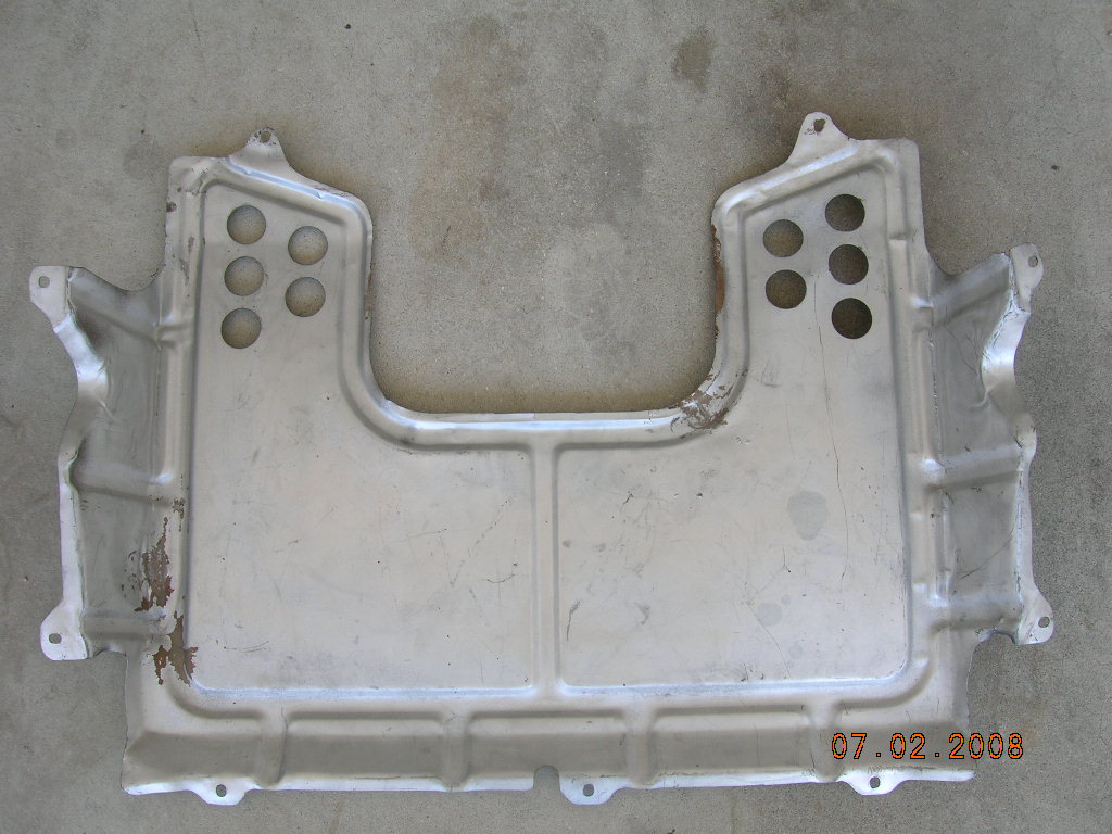

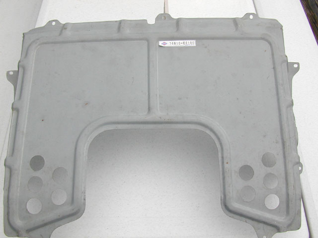

I agree that the ones from the factory were silver/grey. #237 still has its original one and it is that color. I think some of the earlier replacement parts were also silver and then they changed over to black at a later date. I have seen that with other parts like exhaust parts as well. See attached pictures of two NOS splash pans from prior threads. I would guess that someone painted one side or the other of yours.

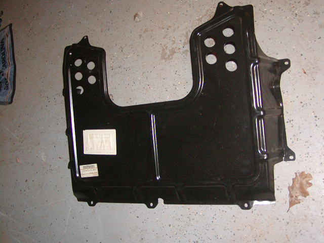

Thanks All. I think I will go with the silver/gray matte finish. Here's a picture of the splash pan that I just bought. I also heard from the guy I bought it from that someone is making fiberglass replicas.
