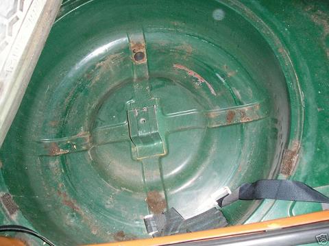

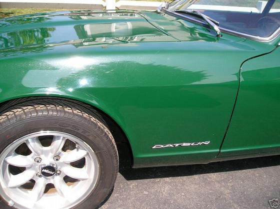

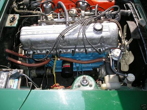

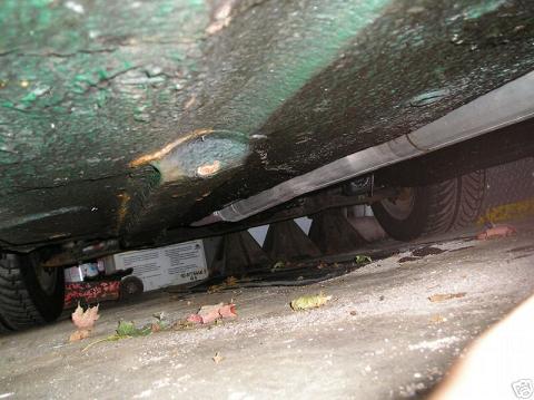

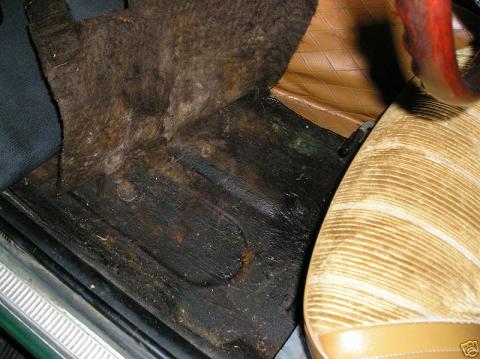

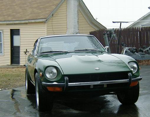

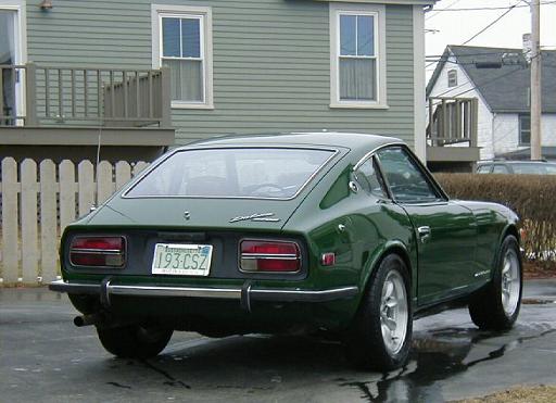

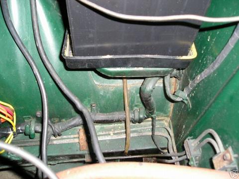

Hey Brian,
Here are the pictures from the PO who sold me the car, I won't have it until late next week or the next....more like the next.
I have been looking for an original Green FOREVER, and so I decided to take a chance on this one. From talking with PO it sounds like it's in pretty decent shape. He states very minor rust, surface only.....well see, and great running condition, althought it needs vent hoses.
It was "restored" by a nissan dealer in 1987 I believe, but hasn't really been touched since then.
I'm excited about the car, can't wait till it gets here. My Orange 73 will finally have a Big Brother.
Let me know what you guys think if you see something out of the ordinary...I have thick skin, so let the comments fly.....

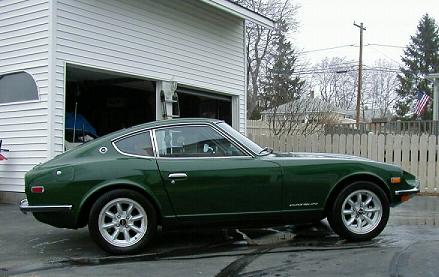

My 71 (see sig) with 2/71 date also has the round vents in the side, and none in the rear hatch. So when they say "early" they mean really really early :laugh:
Actually I think it is the series 1 cars that have the hatch vents and 240Z side emblems. The switch to series 2 was made between January and February 71 or there abouts.
