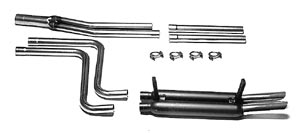

I like the period look of the Jag dual muffler system, but not at that price, and the tube diameter is too big. Instead, what would the feasibility & practicality be to use two glasspacks with a sort of Y-pipe as the mufflers? The only limiting factor I can think of is the length of the glasspacks, but my exhaust has about 28 inches for the can, and another 8 or 10 inches for the tailpipes.
I think a connecting strap would be needed to attach a hangar hook, and just clamp the whole mess on to see how it sounds and if the engine likes it. If so, remove, blast clean & coat with something.

that would be pretty cool i suppose. just as long as you get the non-restrictive ones and you might want to run a third one inline as a resonator; otherwise it would be too loud
On my first 240Z in 1972-73, I had a 3 into 2 header with dual pipes and glasspacks on it. The exhaust system came from BRE and it sounded awesome! The main down side was they used glass packs that looked like cherry bomb mufflers of which were mounted along side the driveshaft. I had to watch speed bumps etc or they would scrape, especially with a lowered suspension. But again since it sounded so good I was willing to put up with the low clearance issue.
My first 72 had the same configuration, a 6->2 header, then dual pipes (over/under at the tips) with 36" long small diameter glasspacks tucked into the tunnel beside the driveshaft.
Best sounding Z exhaust system I've ever heard, by far. As smooth as the best sounding Jags.
Mine were made by Cannon and discontinued in the mid 70's. The BRE system looked identical and disappeared from their catalog at about the same time.
My 71 also had the BRE dual exhaust when I got it 30 years ago and I loved the sound. When it got rusted and started to leak, I replaced it with similar glass packs and pipes from a local muffler shop. The replacement setup sounds as good as the original BRE as far as I can tell. As Zulaytr mentioned the center clearance is a little tight and you need to watch out for high spots even though my car still has the stock suspension.
