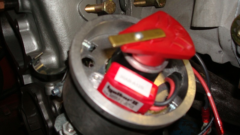

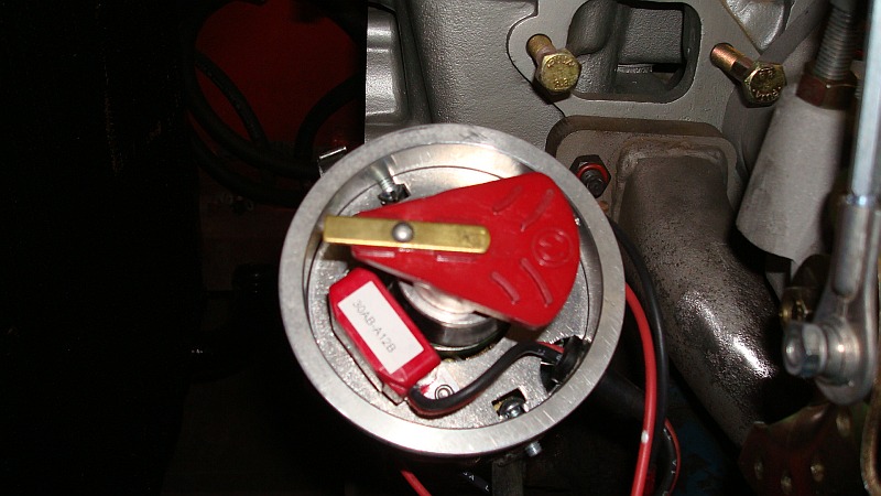

That's what I love about the Unilite, Even if the bearings get wobbly, there is NO gap or dwell to worry about. The infrared LED's allow it to either make or break the contact. No 2 ways about it.
Optics rule,
Dave.
P.S. Having the Mallory Promaster coil with the MSD 6A and the Unilite distributor allows me to expand my spark plug gap to .065 instead of the typical .032 . This set-up shoots a bolt of lightning. I screwed up by having my key to the "ON" position when I plugged in the Distributor once, It shot a stream of lightning 7" away and into my arm, that was obviously TOO CLOSE to the coil. I did'nt have the coil wire on so it was free to go where ever and ended up trying to give me a fricken Heart attack. I thought someone had shot me.

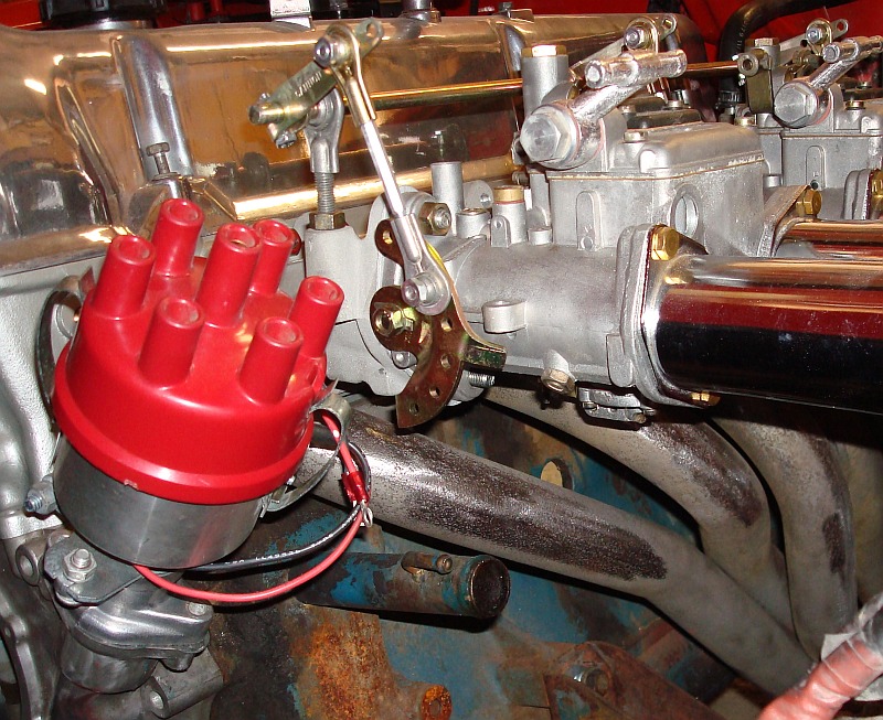

I have a 72 240z with an L28, Performance Cam, not sure which one though.
N42 head, ceramic coated header into 3" pipe, Has 240z distributor with eletric conversion, MSD Blaster 2 coil Has NGK Iridium Spark Plugs gapped to .045" I Just put on tripple webber 45's which don't have any provision for the vacume advance on the dist. I know MSA offers a Mallory unilite dist. But I really don't wan't to spend another $600-700 I am wondering if there are any other Fully mechanical distributors that would work, or if it is possible to modify the 240z dist. to a full centrifual advance.
Can any body help me?
Here's a used Mallory Unilite on Ebay. The same seller has a ProMaster coil and Hyfire IV spark box listed.
http://cgi.ebay.com/ebaymotors/Datsun-240z-Electronic-Distributor-Mallory-Unilite_W0QQitemZ260223571296QQcmdZViewItem?hash=item260223571296
If you want precision, heavy duty, solid performance, get a Mallory. They make them with the Unilite module and with dual points, with and without the vacume can. Triple owners can use the non vacume. The dual point ones are cheaper and you can find them on Ebay for a good price. I got a new one for $120 last year. You can also set them up with a Pertronix module. They have both Pertronix 1 and 2 for the Mallorys. My feeling is the Unilite can (if you get an electrical spike) blow out and a magnet can't. I ran a Pertronix 1 on a Chevy truck for 6 years and never had to open the cap. I did replace the cap 1 time but never had a problem with the module.
Optics rule,
Dave.

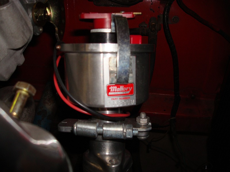

Hi Dave, I found this older thread from a while back and have a question.
I am debating on whether to add an MSD 6A CD unit to my current Ignition and Distributor setup. I've got the Mallory Unilite Breakerless Distributor with a Mallory Unilite Promaster Coil & 700 Ballast resistor hooked up such that my Stock Tach on the 240z works fine. I used this installation recommendation from Carl Beck : http://www.zhome.com/ZCMnL/tech/UniLiteWire.jpg
and it works terrific.
My question and any advice from other experts as well needed is:
1) Would the MSD 6A 6200 series make much difference on overall performance and starting?
2) How would I install the MSD 6A 6200 series given the setup I have so my stock tach will still function properly?
