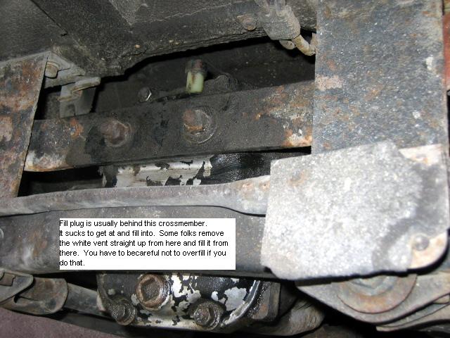

Here's a picture of my differential. I can see the drain plug. It's at the bottom with the square indention. I'm not seeing where to refill it at unless it's that tube at the top? I need to jack the car up to get under it better but if not for refilling what is that tube for anyway?
I filled mine by removing the spare tyre from the well and removing the grommet that is in the front part of the well, when viewed standing at the rear of the car. I got a piece of clear plastic tube, largest diameter that will fit into the fill hole and placed it through the hole in the bottom of the well and routed it into the fill hole in the diff. Less than a metre of line was used.
Have someone pour the oil in through the top of the tube and you get under and watch for it to fill. It will run out when full. Replace plug and drive.

OK the fill plug came loose easy. No problems there. I give up on the drain plug. How do I get that out? I don't have any square tools.
A long 1/2" breaker bar works well! As you may know, the square drive end of the breaker bar fits nicely into the drain plug. These plugs can be very tight and require some effort!
So if I got a socket wrench with a 1/2" drive that would work? Please forgive all my dumb questions. I'm still pretty new at working on cars, especially Z cars.
You could try it in the first instance but I wouldnt go forcing it if the plug is too tight, you may damage your socket drive.
Best bet is the breaker bar. Try impact blows with a lump hammer to loosen it.
