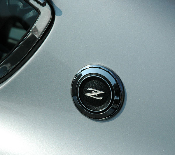

Clarification: Not JUST the 432s, but ALL the Japanese home market models had a round pillar emblem with the 'Z' mark in the centre. This emblem is often mistaken for a 'vent' type emblem, when in fact it is solid, and mounts on the two small holes in the quarter panel.
Home market cars switched over to the same 'vent' style emblem at the same time as the Export cars.
Pic of earliest home market pillar emblem for reference ( notice its round, solid, and not vented ):

On my '73, the vents look like they go nowhere. Was Nissan going to put something there later? I also have the emblem with the "Z", but it is not solid. (has 4 cutouts, one top, 2 side and one bottom.) What is the real "Original" one?
The vents actually open towards the top. What you have sounds original.
