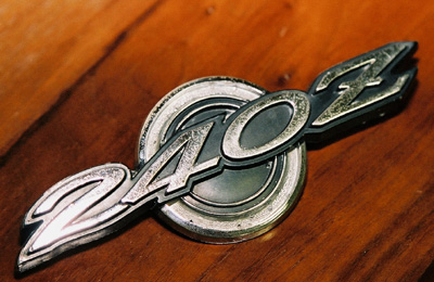

There have been discussions over the "240Z" on the hatch and the quarter panels. We commonly see the Z filled in white. Early emblems came in metal with white Zs, but the earliest Zs were chromed. The emblems are also hollow cast and kats does a great job describing the different castings. I have one (the only one I have ever seen) quarter emblem 240Z that is solid cast.

Here is the solid quarter emblem. I got into a big eBay battle over this baby.
