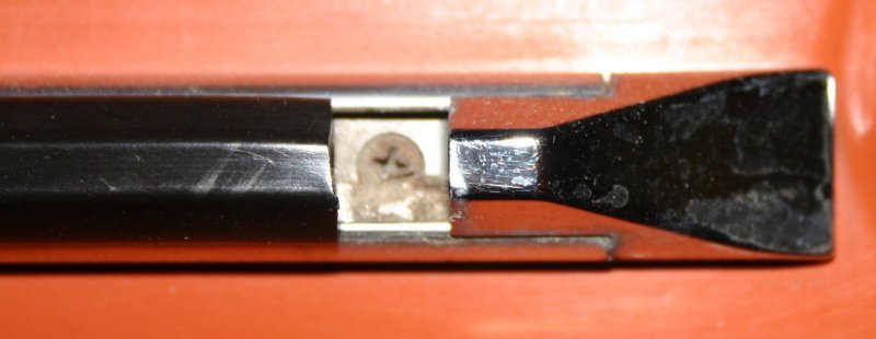

April 6, 200421 yr Author comment_75741 Ok, I've worked on this a bit and have some pix to share. The first is a pic of how these are mounted to the car. Link to comment https://www.classiczcars.com/forums/topic/11112-door-ding-preventive-strip/#findComment-75741 Share on other sites More sharing options...
April 6, 200421 yr Author comment_75742 Next one is after removal...note that not only were these attached with one screw at each end but also with the 'tape' running the full length of them. Link to comment https://www.classiczcars.com/forums/topic/11112-door-ding-preventive-strip/#findComment-75742 Share on other sites More sharing options...

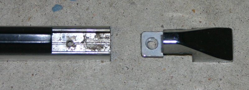

April 6, 200421 yr Author comment_75743 Now for those interested in the pieces themselves, here's a shot of the pieces after removal. Link to comment https://www.classiczcars.com/forums/topic/11112-door-ding-preventive-strip/#findComment-75743 Share on other sites More sharing options...

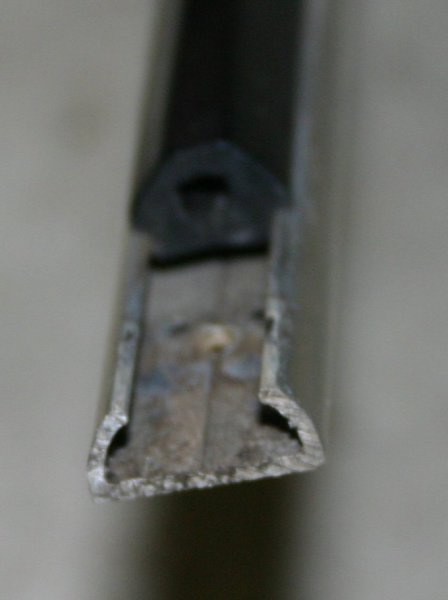

April 6, 200421 yr Author comment_75744 And one last one because someone mentioned the type of channel, so here's a shot of the channel after removal. Link to comment https://www.classiczcars.com/forums/topic/11112-door-ding-preventive-strip/#findComment-75744 Share on other sites More sharing options...
