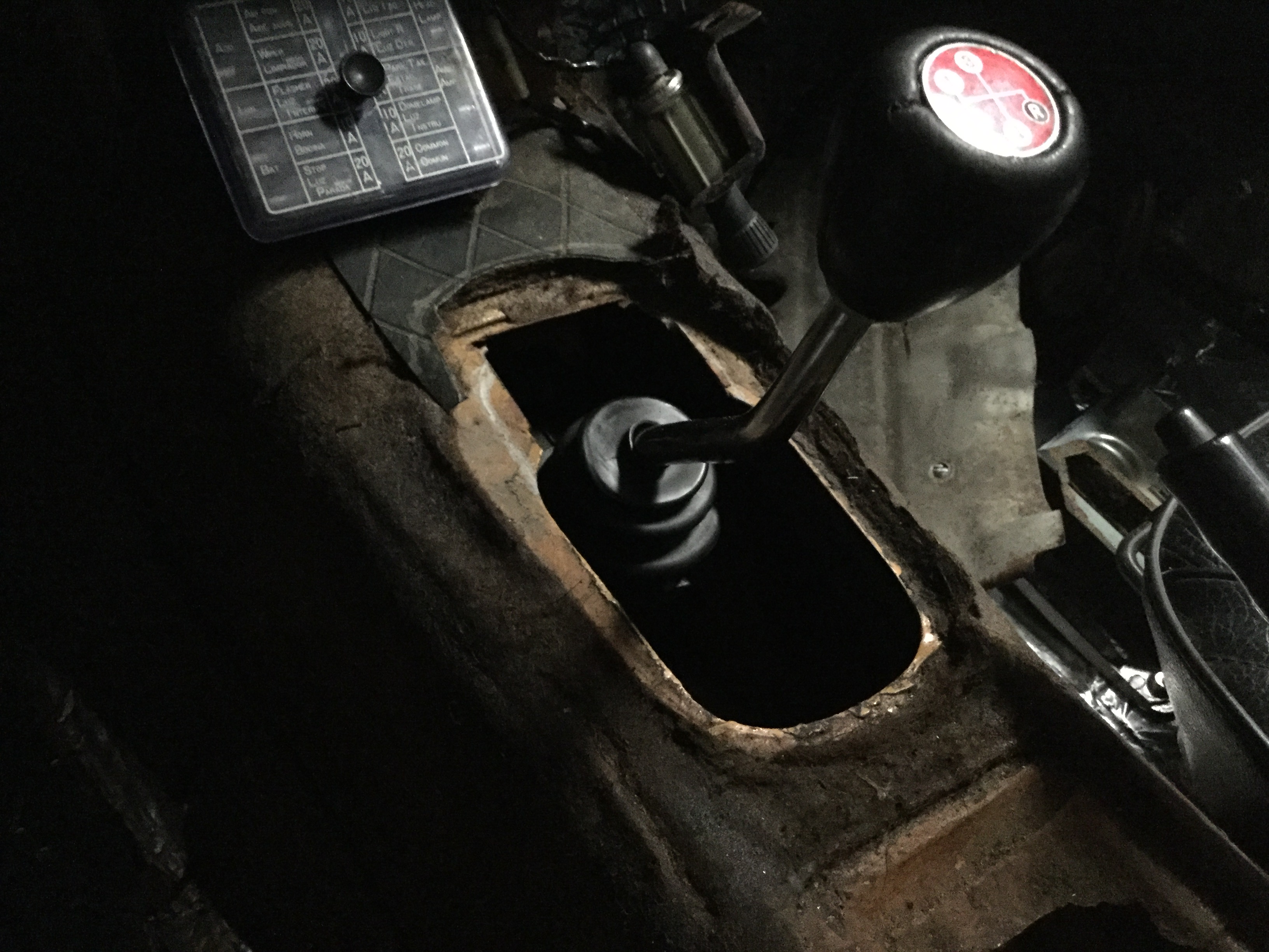

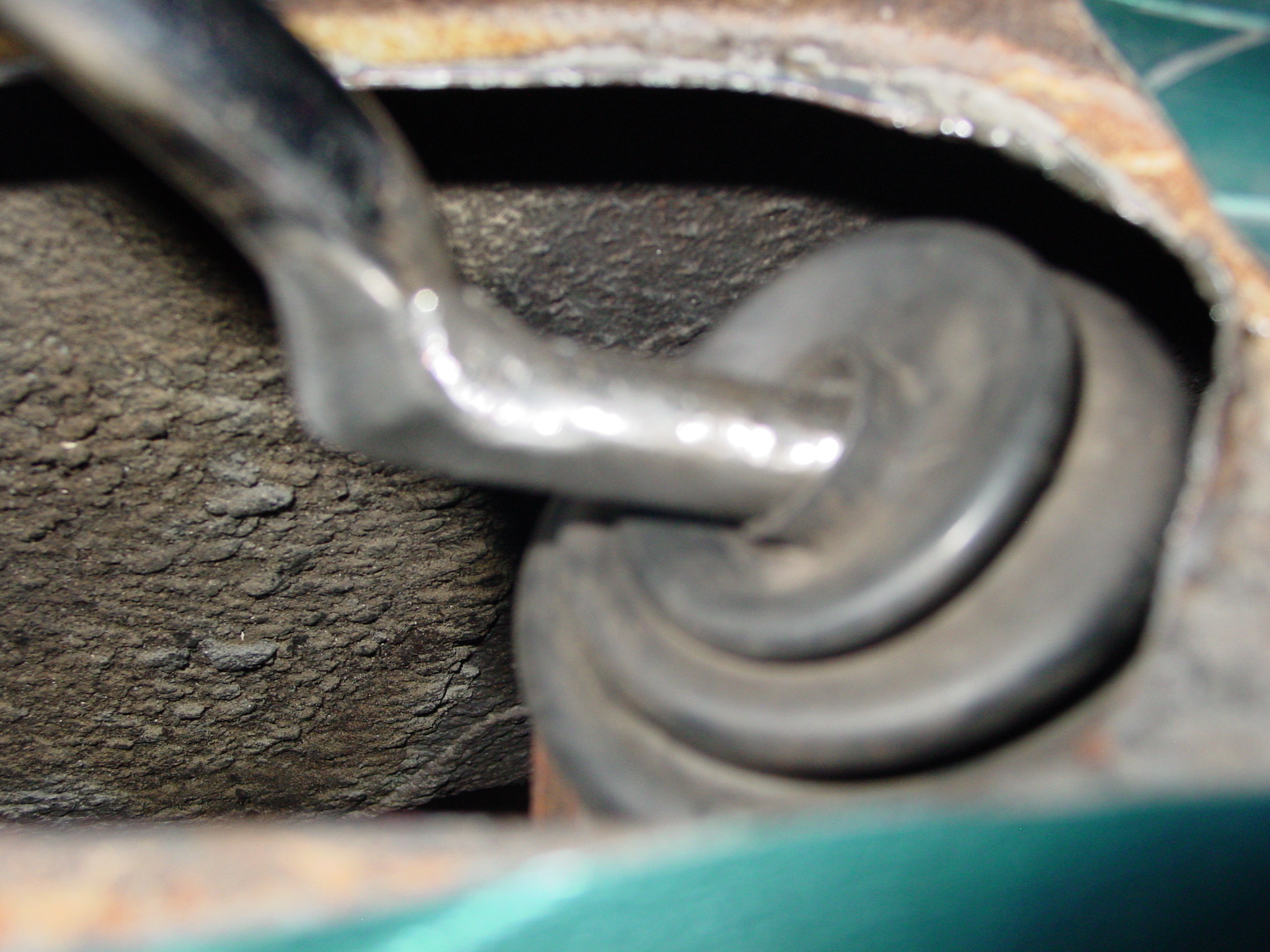

JSM Posted January 16, 2017 Share #1 Posted January 16, 2017 I have an 8/71 Z. Looking to replace the inner shift boot (mine is missing completely). Learned there is a difference but from the pics I can't really tell what the difference is? That aside, I have a later 83 ZX 5 speed in my car. Do I even need the correct 71 boot? Plus I think my car was originally auto too. Link to comment Share on other sites More sharing options...

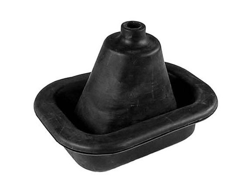

psdenno Posted January 16, 2017 Share #2 Posted January 16, 2017 When I updated my 4/71 Z to a later model 5 speed, I had to enlarge the shift boot hole in the floor panel and use the later style rectangular boot that is held in place with a screw down metal frame. All easy to do and the boot will keep the interior of your Z clean, dry, and a little more quiet by blocking road dirt, water and noise. Dennis Link to comment Share on other sites More sharing options...
JSM Posted January 16, 2017 Author Share #3 Posted January 16, 2017 Ah ok thanks that makes sense. This ebay link shows as a 71 which is the boot I currently have and won't fit to small: My tunnel hole has been enlarged and I should use this now correct: Link to comment Share on other sites More sharing options...
psdenno Posted January 16, 2017 Share #4 Posted January 16, 2017 The bottom picture looks like what you need. The metal retaining rings show up on eBay from time to time. For mine, I traced a pattern, including screw holes, using the boot at a guide and had the retaining ring made by students at the local high school metal shop class. Dennis Link to comment Share on other sites More sharing options...

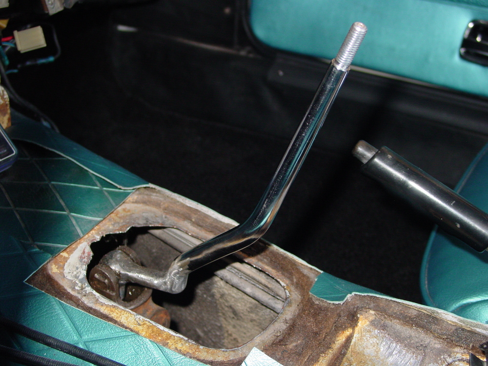

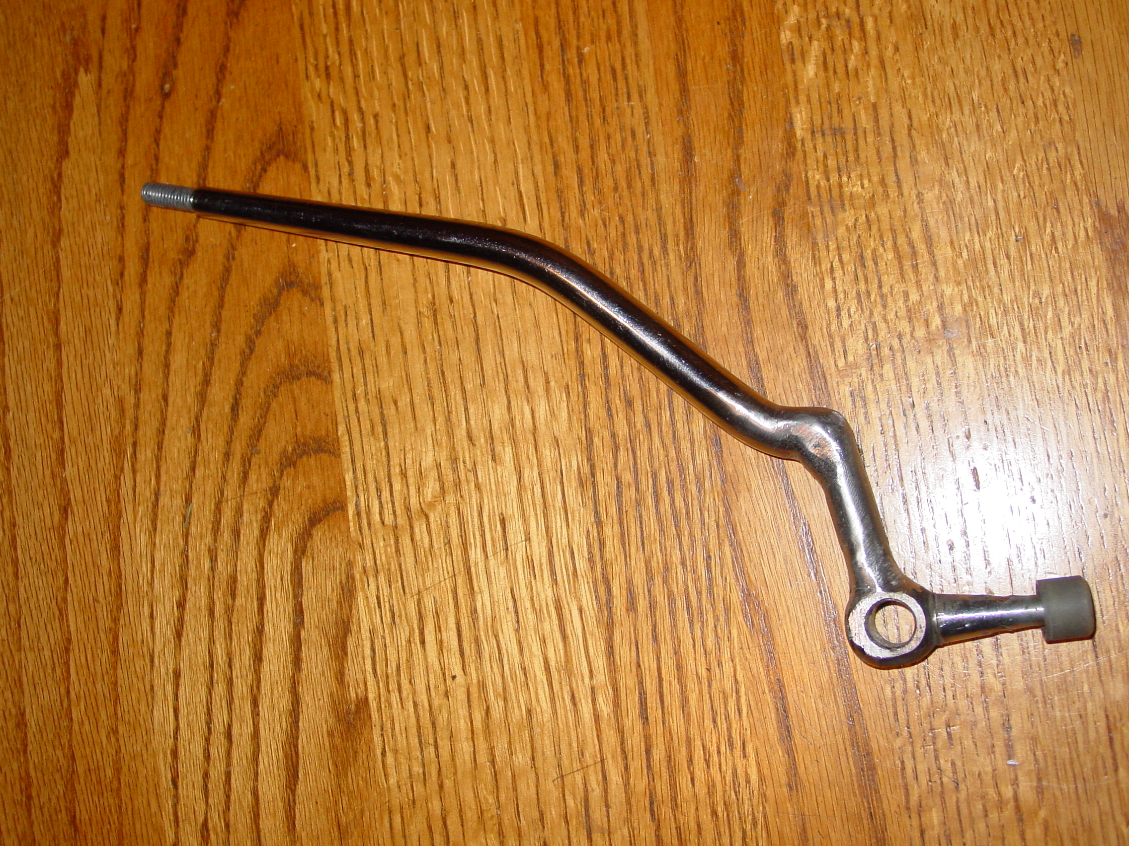

lonetreesteve Posted January 17, 2017 Share #5 Posted January 17, 2017 (edited) JSM, You may also need to have your 5-speed shifter modified as well. That's what I had to do with my former 8/71 a few years ago when the original 'Type A' transmission went bad and I replaced it with a low mileage 'Type B' 4-speed out of a '72 that I had in the garage. My body & paint guy modified the type B shifter so that it would work better in the '71. I have attached the pictures. Edited January 17, 2017 by lonetreesteve Link to comment Share on other sites More sharing options...

lonetreesteve Posted January 18, 2017 Share #9 Posted January 18, 2017 JSM, For the amount of metal that you cut out, you may not need to modify your shifter. As Psdenno mentioned, you may want to try shifting with your console in place. As you can see in the picture below, I didn't cut out much of the metal and before my shifter was modified, it would pop out of both 2nd and 4th gears when the console was in place. After the shifter was modified, it shifted great with absolutely no issues. Link to comment Share on other sites More sharing options...
