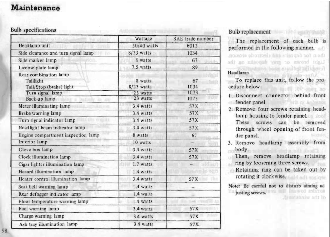

Just for fun, here are the bulb specs from the Owners Manual.  Can you show a good picture of the type label on one of your bulbs?  Just curious.  Today's 57's seem to be slightly larger than yesterday's and don't fit the space very well.  I don't think that 57X is available if I recall correctly, except for NOS eBay stuff.

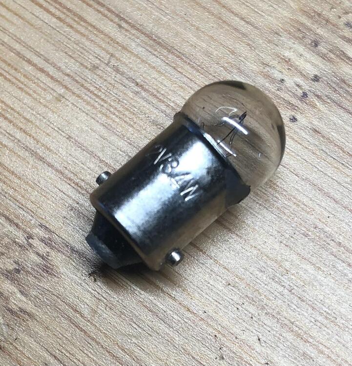

No. Just bare incandescent bulbs whose light is turned a green color by a green plastic "lens" inside the gauges.
If your bulb glass was tinted green they were replacements for the factory clear bulbs. (I say "clear" but anyone that's looked at stock bulbs after 40 years knows they're anything but clear - mostly smokey brown or charcoal)
I don't see the point unless the green plastic lenses were damaged or removed from the gauge. I don't really see the point of green on green (green tinted bulb or green LED inside a green plastic housing) but whatever floats your boat. I know some people got away from the green entirely by removing the green lens from the gauges and using orange or blue LEDs (again, not my thing (bought a Z, not a ZX...) but...).

3.4W... There is a "." there, it's just hard to see.
No one wants a 34 Watt gauge bulb.
Well, you wouldn't have to worry about being blinded by oncoming headlights. The gauge lights will have already blinded you. Maybe not. The parking light fuse would probably blow first.
