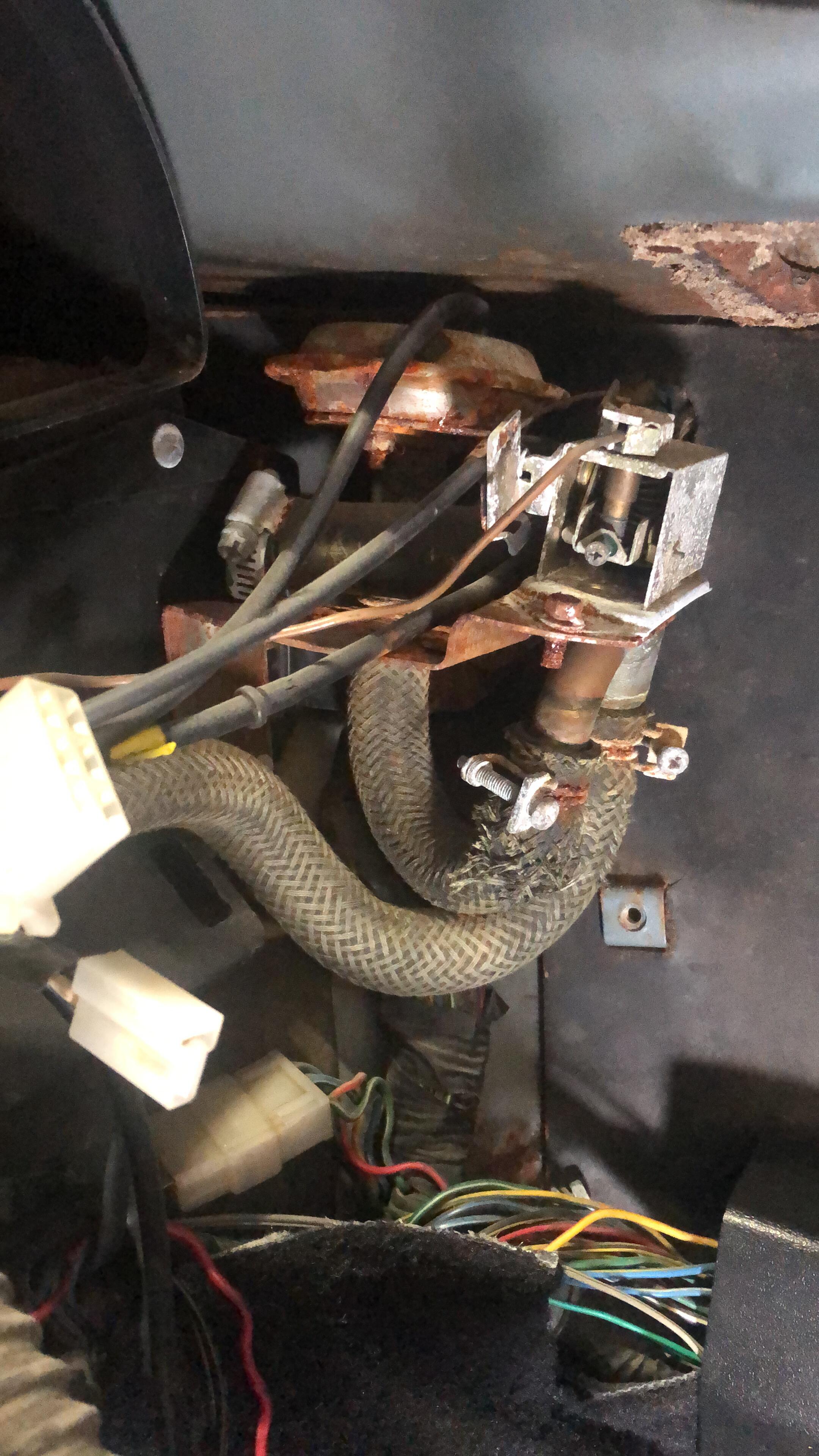

Guys, dumb question ... do i also need to unplug the harness around the steering column for the dash to slide out?

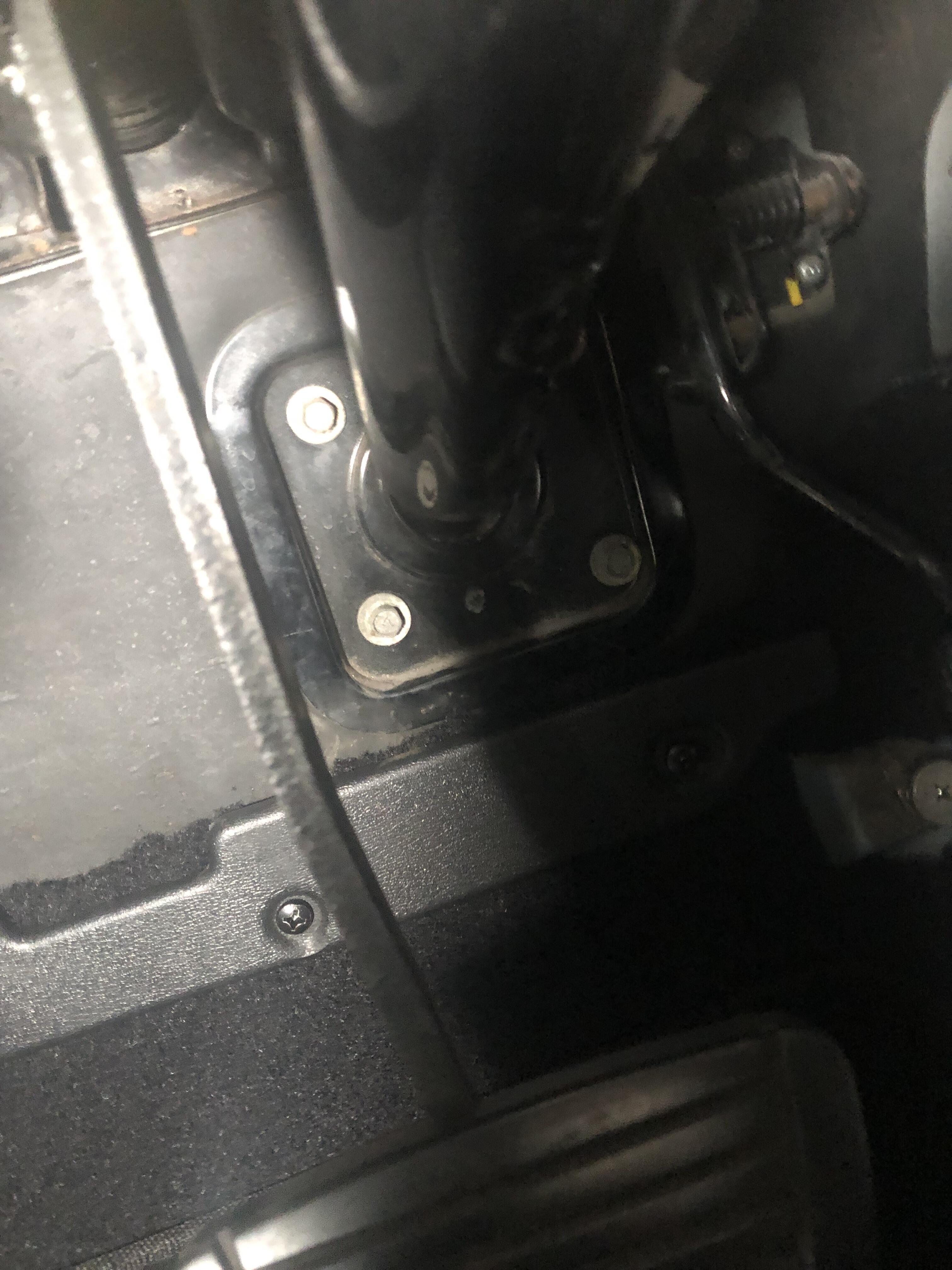

After removing the two steering column bolts the column has hardly moved. Is this because of the harness around it holding it in place?

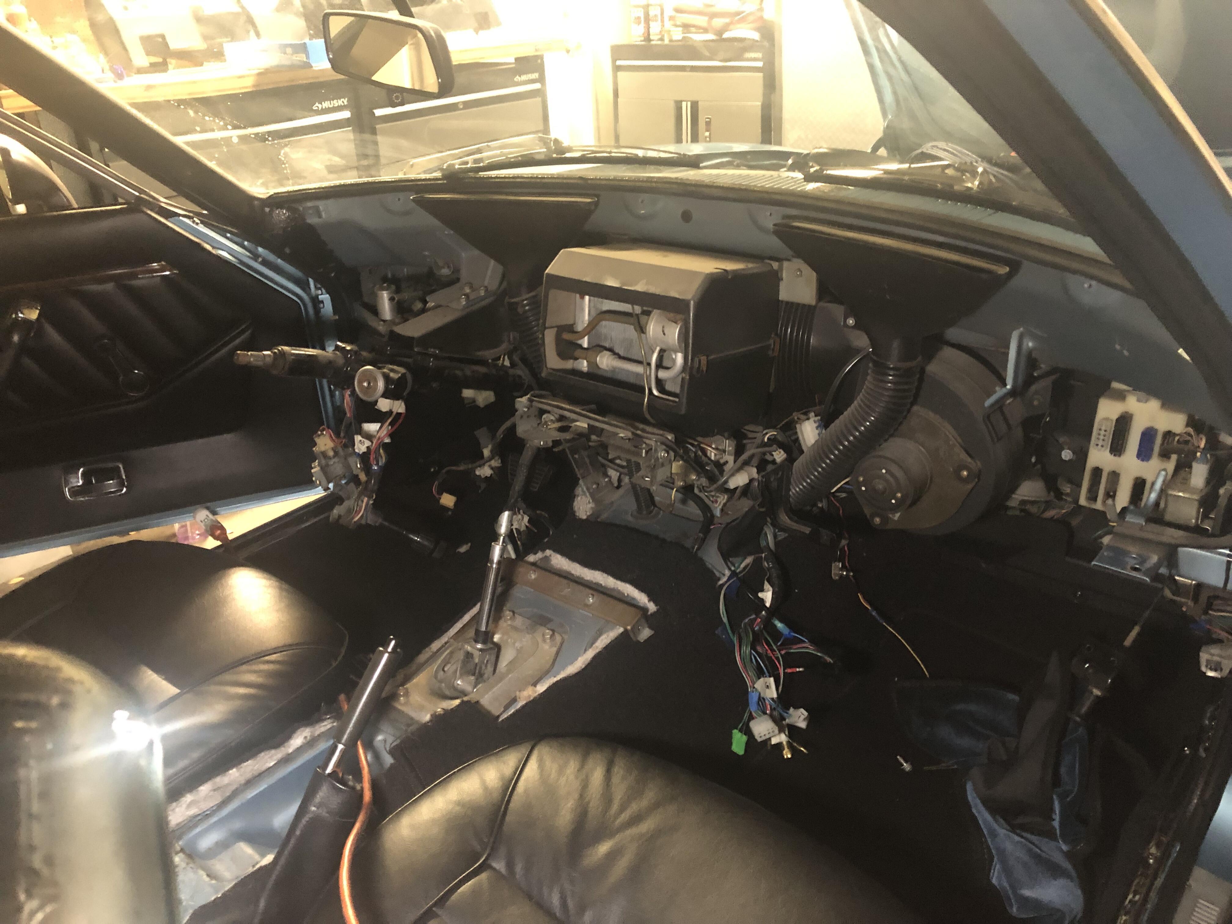

I am done with:
- remove center console
- remove windshield finisher 4x screws
- remove front instrument panel (also removed 2 screws holding the bracket for two center air ducts)
- removed 6x dash bolts near firewall
- removed 4x bolts near trans tunnel (2x each sides)
- removed 2x bolts facing up, one on each side near the vent manual lever
- removed 2x 12mm bolts holding steering column

Here are the bolts you’ll need to remove. Just did this job. All are 10 mm except the steering column.
-6 near windshield under finisher. A 1/4 socket wrench with short swivel extension worked best .
- there is one bolt on each side near kick panels. One next to hood release, screw upwards towards roof. And same on the passenger side
- 4 (2 per side) where the dash frame bolts to trans tunnel
- Speedo cable (what Captain Obvious said)
- 2 x 12mm bolts holding the steering column. They help lower the column so you can get the frame clear.
- your probably hanging up right around the steering column. Where those two 12mm bolt screw into. It’s a flat plate that the dash frame has to be lifted over.
The dash comes out easier if you rock the bottom upwards towards tje windshield and the up and out .
Don’t forget the 3 wire harness connections that going in to a panel in the passenger side firewall.

I believe there are four bolts holding the steering column up. The dash is pinched between the steering coulumn and a bracket welded to the firewall. If the column doesn't flop around, its not loose yet
Do I need to remove these 4 bolts holding steering column to firewall?

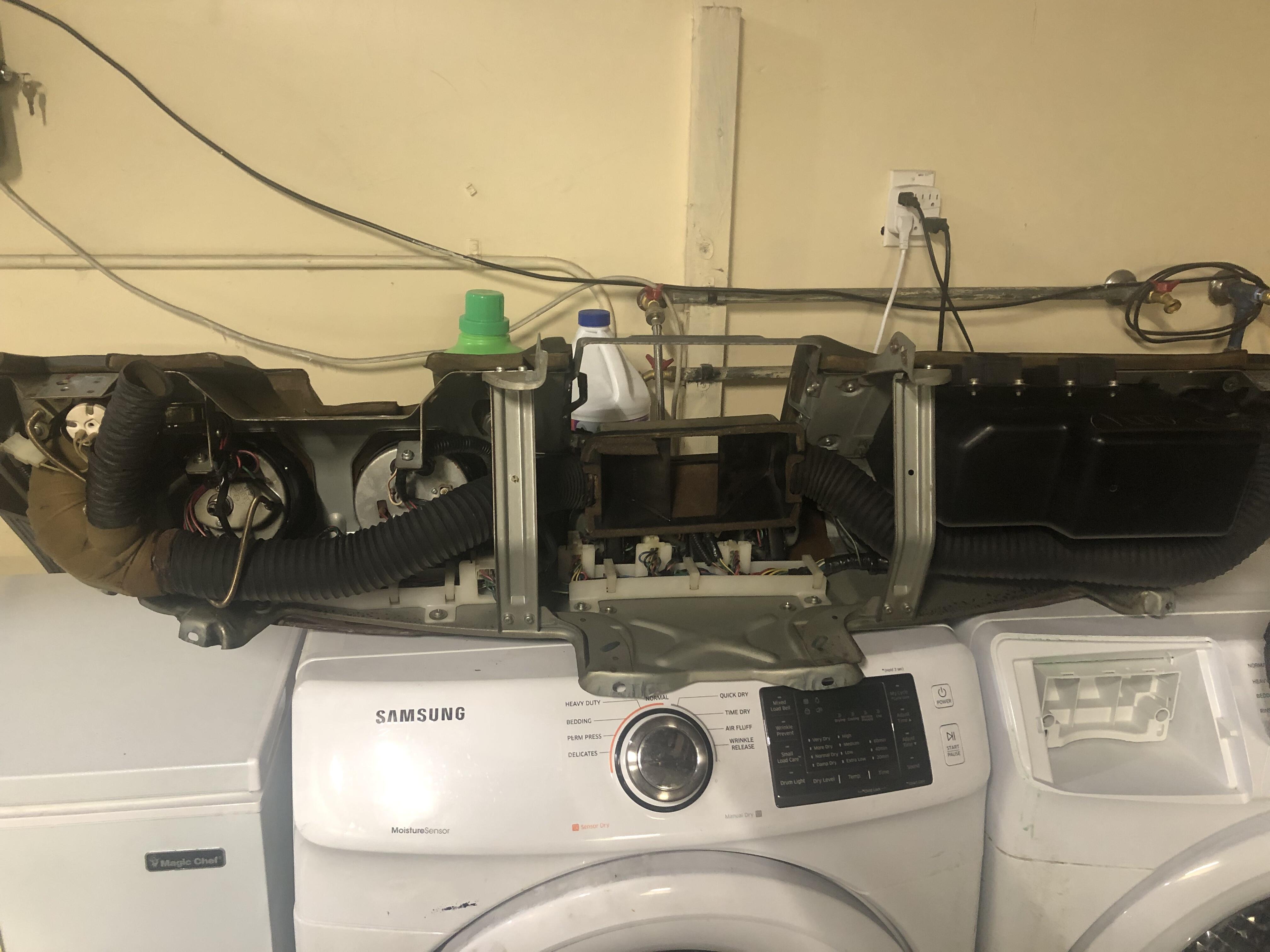

Decided to just decouple the turn signal switch and it gave enough room to lift the dash. Took only Speedo cable out from the back. Didn’t had to take any tachometer wires!!!
