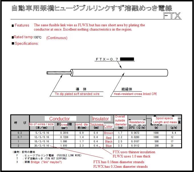

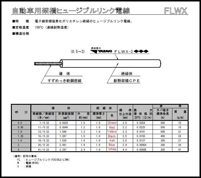

So for some additional info, I couldn't stand it anymore so I started playing around with some of the on-line translators. Everyone likes info, right? Here's a probably correct interpretation of most of the pertinent info on those Yazaki fusible link data sheets:
The only thing I can't figure out is exactly what is the difference between the FLWX and the FTX series. It clearly has something to do with tin-dipping. My guess is that the FTX series uses smaller individual strands and then they tin dip the strands a second time once they are wound together. Might make them more accurate or have a sharper melt characteristic?
Anyway, here's some datasheets. FTX (this is where the 0.3 brown comes from):
And the FLWX  (this is where the 1.25 black link comes from):
I got the impression that they were localizing the melting to a small specific spot, instead of the whole wire, for FTX over FLWX.  Based on your translation.
I wonder if a good meter could distinguish between red and brown links.  They supply resistance numbers.
I got the same impression about the melting spot as you did, but here's the rub... They clearly do the tin dip before they put the insulation on. And Yazaki don't know how long the end user is going to cut the length of wire. So if they are tin dipping just in select spots, they won't know where that dipped spot will end up (or how many will end up) in the finished product. I think the dip has to apply to the entire length.
And as for measuring the resistance difference between the red and the brown, I don't have a meter anywhere near that good. Probably easiest to push an accurately known "highish" current through it and measure the voltage.
But I gotta ask.... Why would you need to resort to measuring the resistance when you can just look at the jacket color or measure the diameter of the conductor with calipers? Based on the thicker insulation of the old style red links, I suspect they are the FLWX 0.85.
