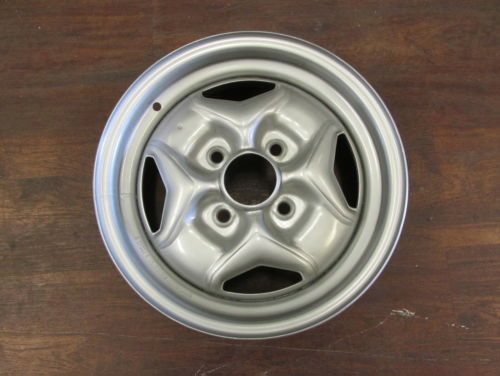

July 7, 20169 yr Author comment_498306 Also, I saw this steel Nissan wheel on ebay from a 1979 Nissan 200SX, which could be pretty fresh if made into a 15x8.5.   Edited July 7, 20169 yr by Matthew Abate Link to comment https://www.classiczcars.com/forums/topic/52645-widened-stock-steel-wheels/#findComment-498306 Share on other sites More sharing options...
