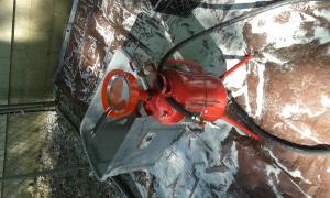

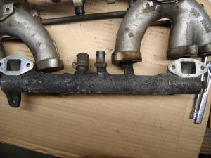

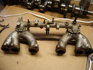

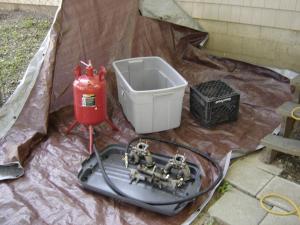

$48 plus $32 for media that I'm reusing. Gotta get it dialed in mo betta but it's going to work good for my minimum use.
EDIT: Sorry for the sideways pics, couldn't get my Bluetooth to transfer pics from my phone to my PC.  That's a problem for another day.  :)
Intakes and balance tube tomorrow.

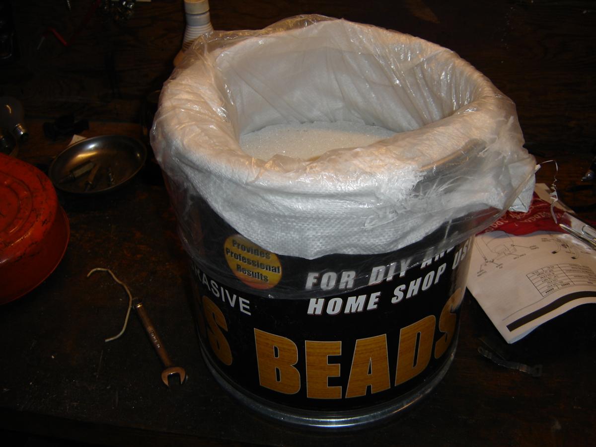

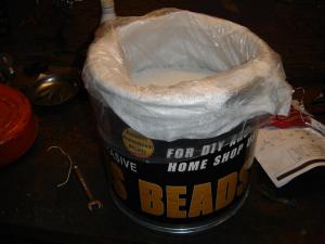

It says glass beads but it's more like pulverized glass, 80 grit.
  http://www.tractorsupply.com/en/store/black-bulltrade%3B-no-80-grit-abrasive-glass-beads

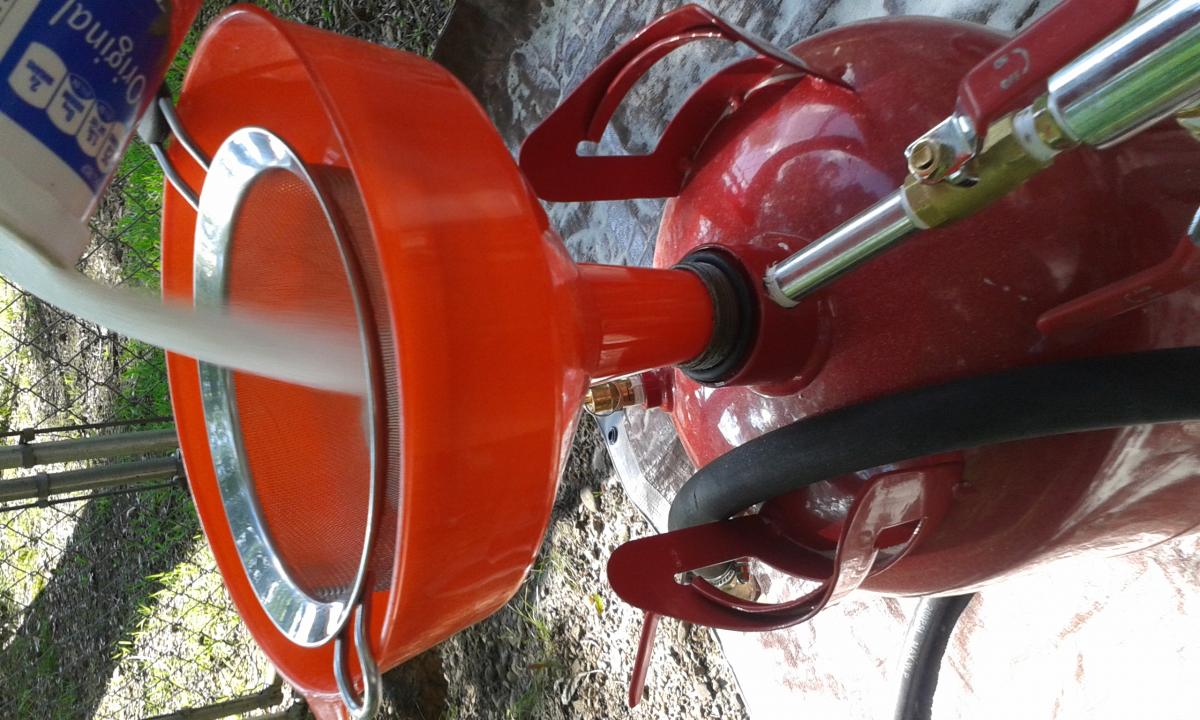

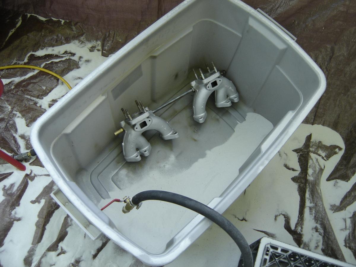

I did it in a big plastic tub and only lost a few pounds.  Did it on top of a tarp too, folded it up and poured that into the tub then filtered it back into the pot.  I think there's a pound in my eyes and hair.  I'll wear the hood tomorrow for sure.
Edited by siteunseen
Looks like you got some pretty great results!  I am looking at buying the same thing for blasting my carbs and a few other parts - I was thinking about using baking soda instead of glass bead though.  I'll probably try to build some sort of makeshift cabinet with cheap wood and sheets of plastic - keep things at least a little tidy :P
I was going to buy a small igloo styled tent, $25 from Academy Sports, and sit inside to keep the mess down but to be honest it's not as bad as I thought.  I'm okay losing a little.
I put the parts inside the biggest plastic storage tub I had and put that in the middle of a 10x12 tarp, fold the tarp and poured that inside the tub.  Scooped it out and put it back into the sandblaster.  The blaster sprays my particular media for about 1 minute, then you just shake it back and forth and it starts right back up.  It doesn't make any kind of "floating" dust, to my surprise.  The heavier stuff like coal slag and sand will wear it out and make a bigger mess.  This one is for parts that'll fit inside the plastic tub.  ;)
I'm using 1 lb Cool-Whip bowls for scooping and figure I lost between 1 and 2 pounds (very little).  So the results minus the PITA, plus I'll have to replace the valves sooner or later, I'll say 4 out 5 stars for the money.  It requires some patience but beer helps.

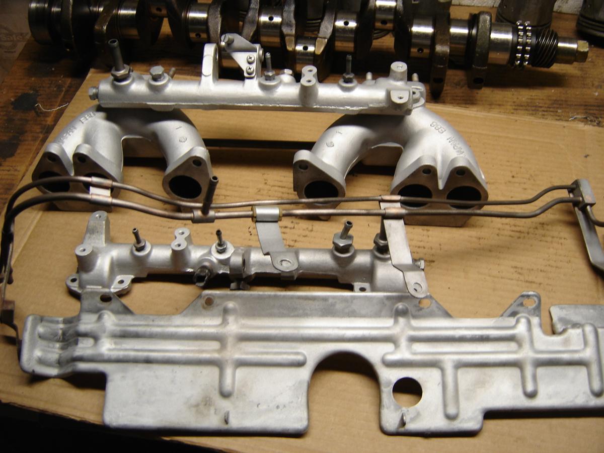

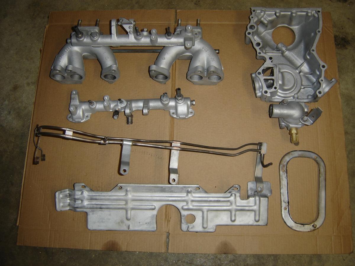

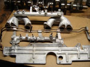

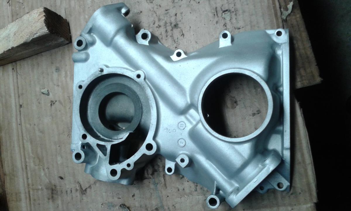

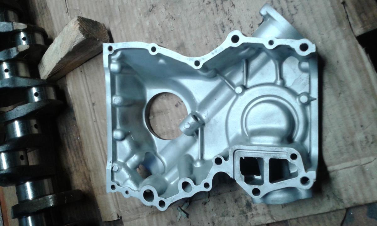

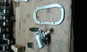

Results:
post-23570-0-23241000-1433611901_thumb.j
post-23570-0-97353900-1433611929_thumb.j
post-23570-0-64901900-1433611963_thumb.j
post-23570-0-42801500-1433611994_thumb.j
post-23570-0-41773800-1433612051_thumb.j
post-23570-0-25619700-1433612093_thumb.j
This is what's left,
post-23570-0-88057100-1433612130_thumb.j
