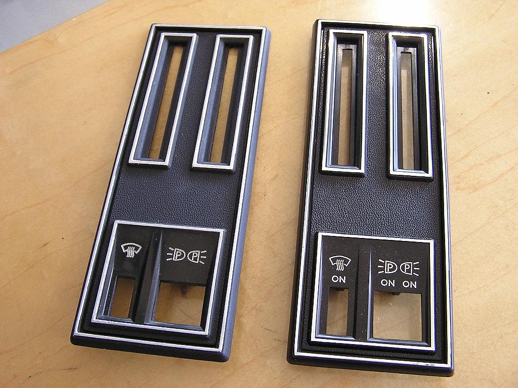

I just looked at my own pictures again and realized I must have replaced the finisher that was on the car after I got it. The one in the first photo has the ON lettering, so that can not be the original version. I have a couple of others without the ON lettering, so I must have replaced it and forgotten about it.:stupid: You could be right about dust in the parking lights symbol looking like white paint.

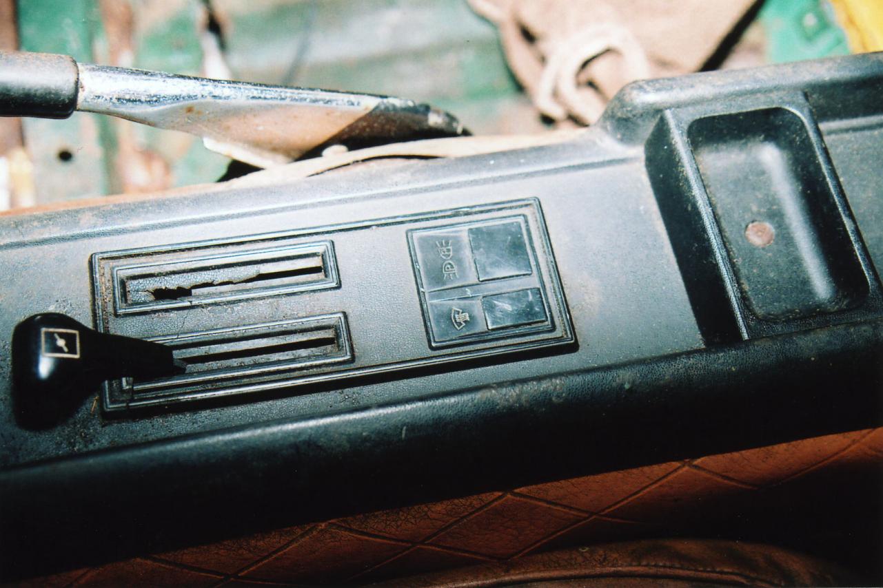

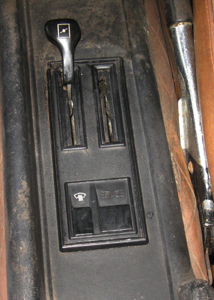

I couldn't get the console off very easily, so I got the big mother flashlight and looked, Kats. It looks like the lever has been removed. I can see the pivot in the housing and it looks like the screw is in there. The cable is long gone however the hanger is on the body and the pedal has the bracket. (Don't mind the rust far up under the dash. The whole car is like this. I call it "patina")
But I got some cleaner and took more pictures of the face plate. The parking light symbol is definitely not painted.

Thank you Mike, Chris, I confirmed not painted on parking lights symbol.
Today I looked an old car magazine again,then I found HS30(maybe Australian 240Z) has a finisher which is painted white for both defroster and parking lights without defroster switch nor parking light switch!!(picture is not good, surely grommets there for both)
As I reported while ago, the HS30 parts catalog indicates 86720-E4600 for the finisher, same as HLS30.So I thought HS30 has a finisher not painted for the parking lights.But it does,so for HS30 , 86720-E4100 was applied just like a Japanese S30 family.

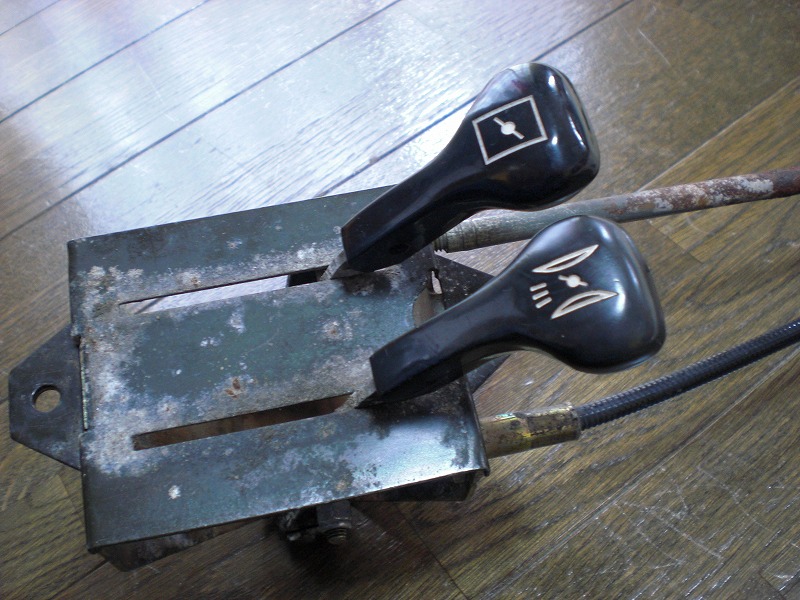

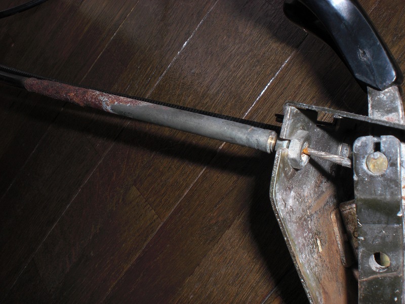

Hi,
I recently have got a choke and throttle mechanism here in Japan.
And I found something unusual of its cable area.
(anyway this mechanism is for a Z432, as you can see the picture it has only one cable for the choke)
Can you see the wire for the choke? It is not solid cable like we usually see.
And there is a very long steel tube for the wire,it seems to me the tube is helping movement of the wire , not to be bend around a basement.
I remember there is a technical bulletin for the changing of the wire for choke mechanism, a former wire was superseded by a solid cable.
Solid cable for the choke, this does not have a steel tube, does it?
So I think this mechanism is the earliest one.How about LOW VIN cars?
Chris or Mike B can confirm their mechanism which has wire or solid cable for the choke.
Also I found a interesting thing, the basement of the mechanism is reversible, for S20 engine and L20/L24 engines.
This Z432's mechanism has a place for L20/L24: two choke cables on the back.It can be used for L20/L24 when it is reversed front and back.
To look carefully into your mechanism(for L20/L24), there is a place for S20 one choke cable on the back.
kats
PS. Please refer post#88, especially the top left two pictures.They have an earliest throttle control mechanism with different apperance of the lever, but the choke cable is solid type,without steel tube.
