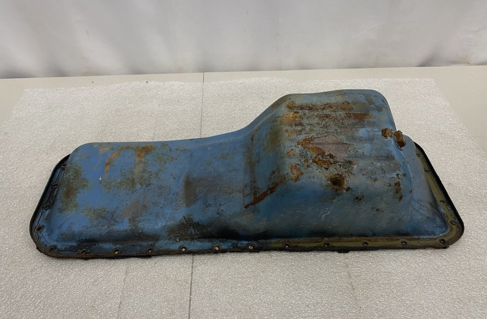

Im trying to figure out if i should change my oil pan out. give me some advice. I have a L28et out of a 83' 280zx turbo car. Im cleaning the oil pan and its seen better days....

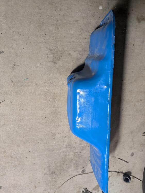

I also have a New old stock L28 or L24 oil pan. I know it will fit, but i dont know if i should use it due to the sump being towards the middle of the pan vs the turbo pan is towards the back of the engine.
I know i will need to modify the pan to add a oil return for the turbo but thats simple enough. And i have spare parts from two L28s i can use the proper pickup tube. I just dont know if i shouldnt becuase of a factor im unawar of.
Pictures are of a stock image L28et pan, vs the newer pan that I own

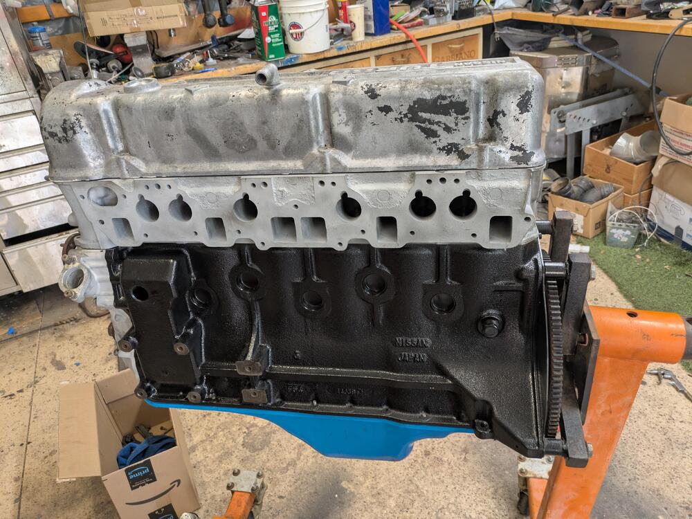

Thank you everyone for the responses. I have tested the fit and it looks like the pick up tube is identical to every other L series motor, just the sump itself it pushed back. I'm going to use the 240z mid sump and install a 10an fitting for an oil return.
Test fitted and looks great!
