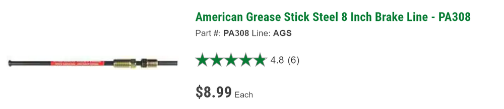

If the length is short it might be worth checking your local auto parts store for precut, preflared, prefitted brake line. I wnt to my local Oreilly Auto and they had a whole wall of different combinations in the back to choose from. Autozone carried a few also.
The straight lengths are cheap. They're in the back.
https://www.oreillyauto.com/shop/b/brakes/brake-hydraulics/brake-lines/b06e09cb5226
Edited by Zed Head
Like this. Edit - messed up the post. But you already know what I'm talking about...
Whoever these guys are, they really screwed up on the company name. "grease stick" means almost nothing. Who cares if it's American. American Grease Stick. Weird stuff!
https://www.oreillyauto.com/search?q=grease+stick+brake+line+repair+hose
