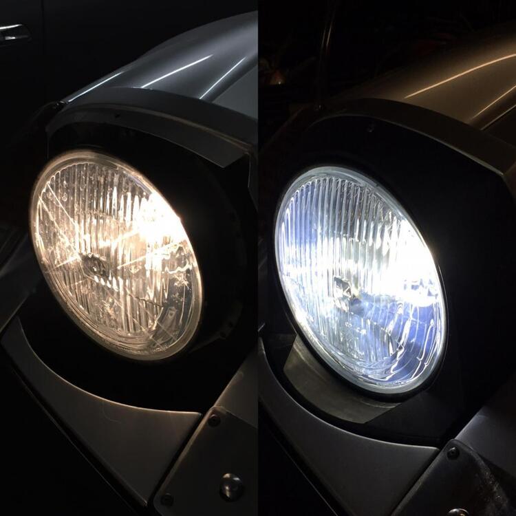

Caveat: I didn’t do this on my Z yet but, I have done it on my 911, 914-6, 944 T. I also haven’t done any electrical testing. The lights are much brighter and there is no effect on the idle when I turn on my headlights which I interpret to mean less draw.
I used different H4 housings (Hella) and just some off -brand LED bulbs. The reason, I hadn’t done my Z was the Datsun way of wiring issue but it sounds like SteveJ has a plug-and-play solution.
These are 914-6 headlights but you get the idea, drastic color temperature difference between sealed beam and LED.
Edited by conedodger
