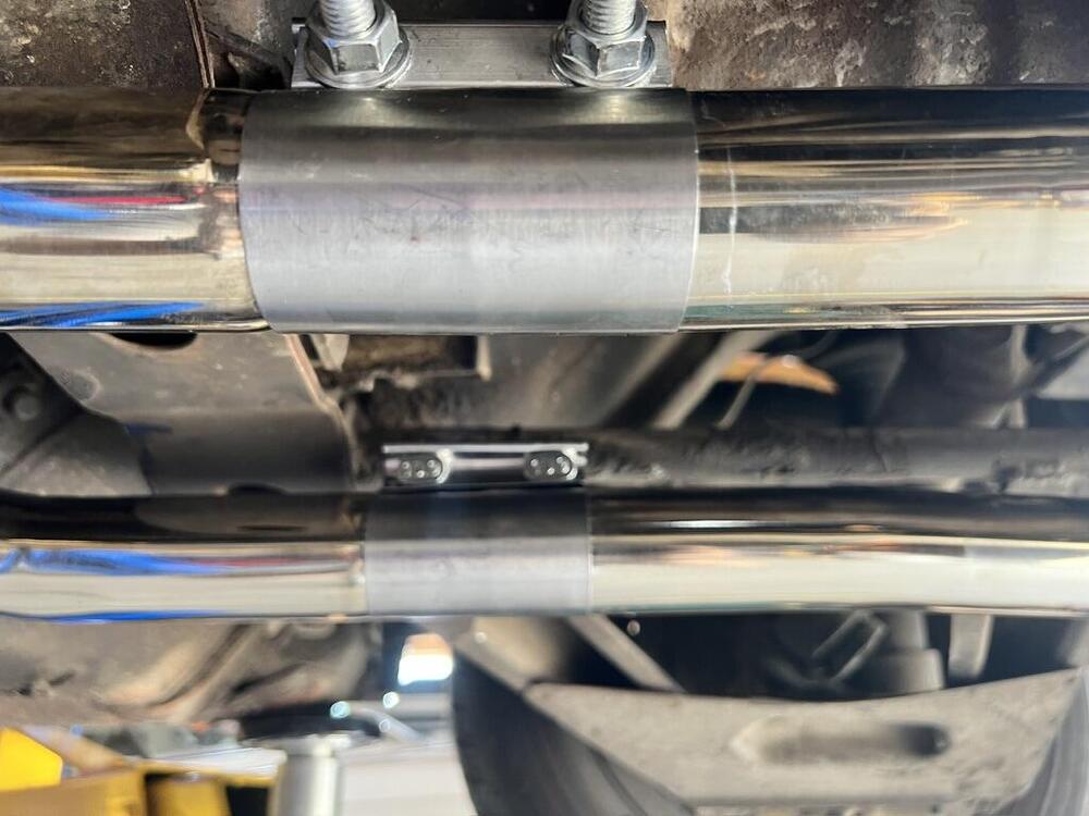

I launched the supplied hangers and went with some 304 Stainless sleeve clamps... this worked much better than I expected and the resonator and exhaust sections are virtually welded. The old clamps allowed some flexing of the joint and it leaked almost immediately. RC is getting this feedback as well...

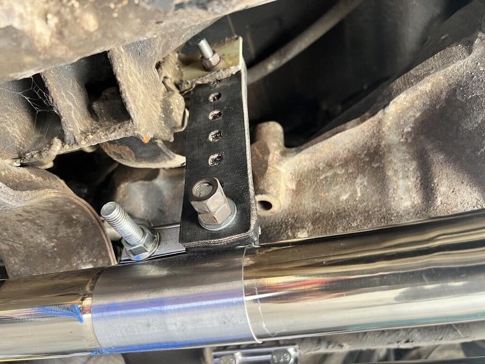

I used a rubber mount attached to the factory '73 exhaust support... all very solid and muffler is hanging in the proper place from the factory hangers.
Completely leak free and solid now. Overall I'm delighted with this exhaust and these clamps make it perfect...

@L24ITS Looks great, do you have a link to what you bought for those clamps?
Not sure if I can post a link... I searched on Amazon and found 1 3/4" clamps, $12 for 2 from Zorvello.

I noticed you used some angle iron straps to get to the support over the diff. Did you find the bolts that came with it were long enough to accommodate the hanger? I would like to use the hangers that came with this setup but swap out these clamps for the ones provided. Just not sure it will all line up. I probably wont get to this for a few months as I'm moving out of my house and storing the car for a bit.
I think the forward bolts could be made to work, but didn't see the benefit. With those stainless sleeves in place, the mid pipe and muffler sections are as solid as a single piece. I did use the stock hanger location for my '73 with a new strap. My muffler is hung from factory mounts with new straps as well. It's solid as a rock in my case and those fiddly early hangers seemed more likely to screw up a nice, solid, interference free installation... so I didn't try very hard to make them work.
I have several hundred miles on the RC exhaust now and love it more with every drive... Hope it all works out for you.
