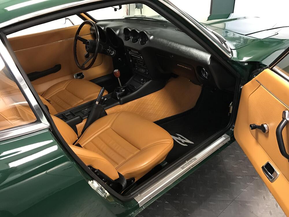

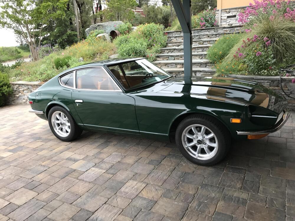

Thanks, I fully restored the interior and the engine bay but still need to do the undercarriage stuff. Its far from perfect but I'm really proud of all the work I did as a DIY kind of guy. I'm still learning so much about the car and this place and others like it is the reason why. Thanks to all that have helped me on the way.
SN 486 that's amazing, I'd love to get something that low and do it proper now that I've been through this one. I'm pretty good at the assembly side of things but wouldn't have the skills to do a bare metal ground up restoration not yet anyways :-)

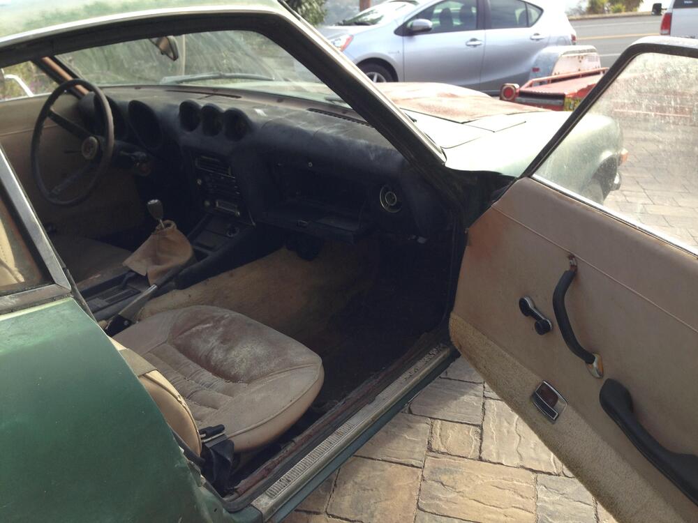

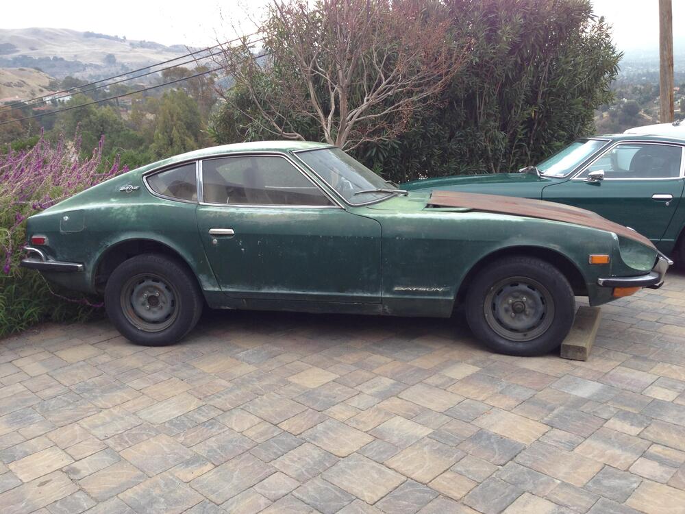

#486... 3 yr rotisserie restoration with new or made "new" again parts. I've been playing with 240z cars for a long time, but only did this level of effort for an amazing example of a sub-500 car. There's a big surge in suppliers since I did this project (finished in 2017). Great time to restore a Z car these days.
Enjoy the Ride!
WOW! awesome job, looks amazing.
