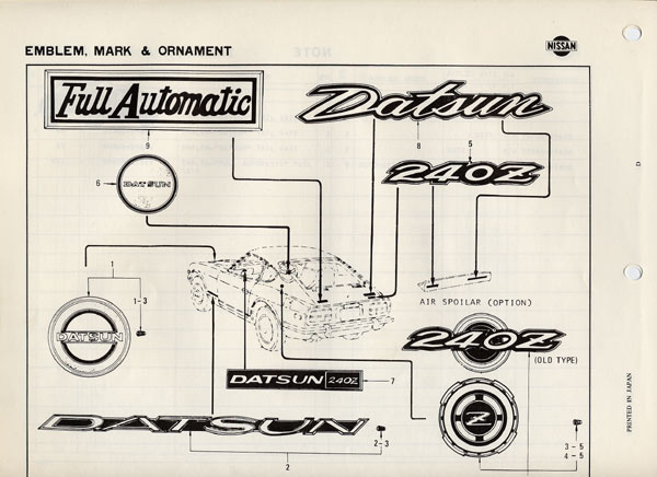

There were lots of emblems that were fitted on the left hand side of the hatch - but from what people have been saying in the above posts, it looks like the USA / North American market cars were not usually fitted with them.
However, if an original "HLS30" USA / North American market car turned up with one on it I would not be surprised. I've been told some very interesting ( and sometimes very funny ) stories about production hiccups and parts supply problems by an old friend who used to work in the Factory at the time. Very very occasionally the 'wrong' part would be fitted to a car ( not matching its standard spec ) and the quality control guys would not pick it up, or be forced to get around the problem in some other way. Seeing as just about all other markets from the USA / North American market had options / specs that included the attachment of the left hand side hatch emblems, it would not be all that surprising that one of the hatches with the pre-drilled holes were to be attached ( by accident? ).
Its pure speculation that this might be the reason for the holes in SledZ's hatch - but as emblems DID exist in other markets, there's always a possibility that one might have have been put on at the Factory or by a previous owner.
Here's a scan of the UK market S30-series parts list. It shows the "Full Automatic" script tailgate / hatch emblem, and gives the part no. as 90809-E7925, fitted from 02-70 up and superseded 76807-E4600:
Alan T.
