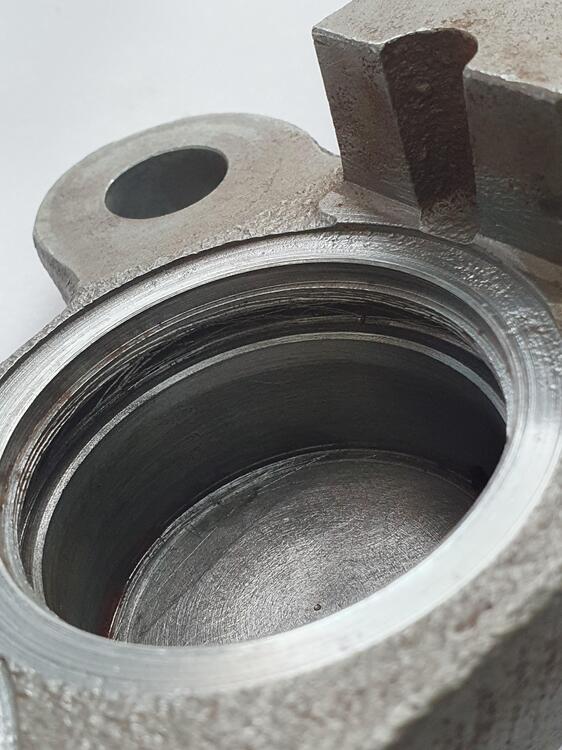

Raw caliper casting (dirty!), showing the internal groove for the main fluid seal and the small counterbore which the dust seal retainer ring fits into:

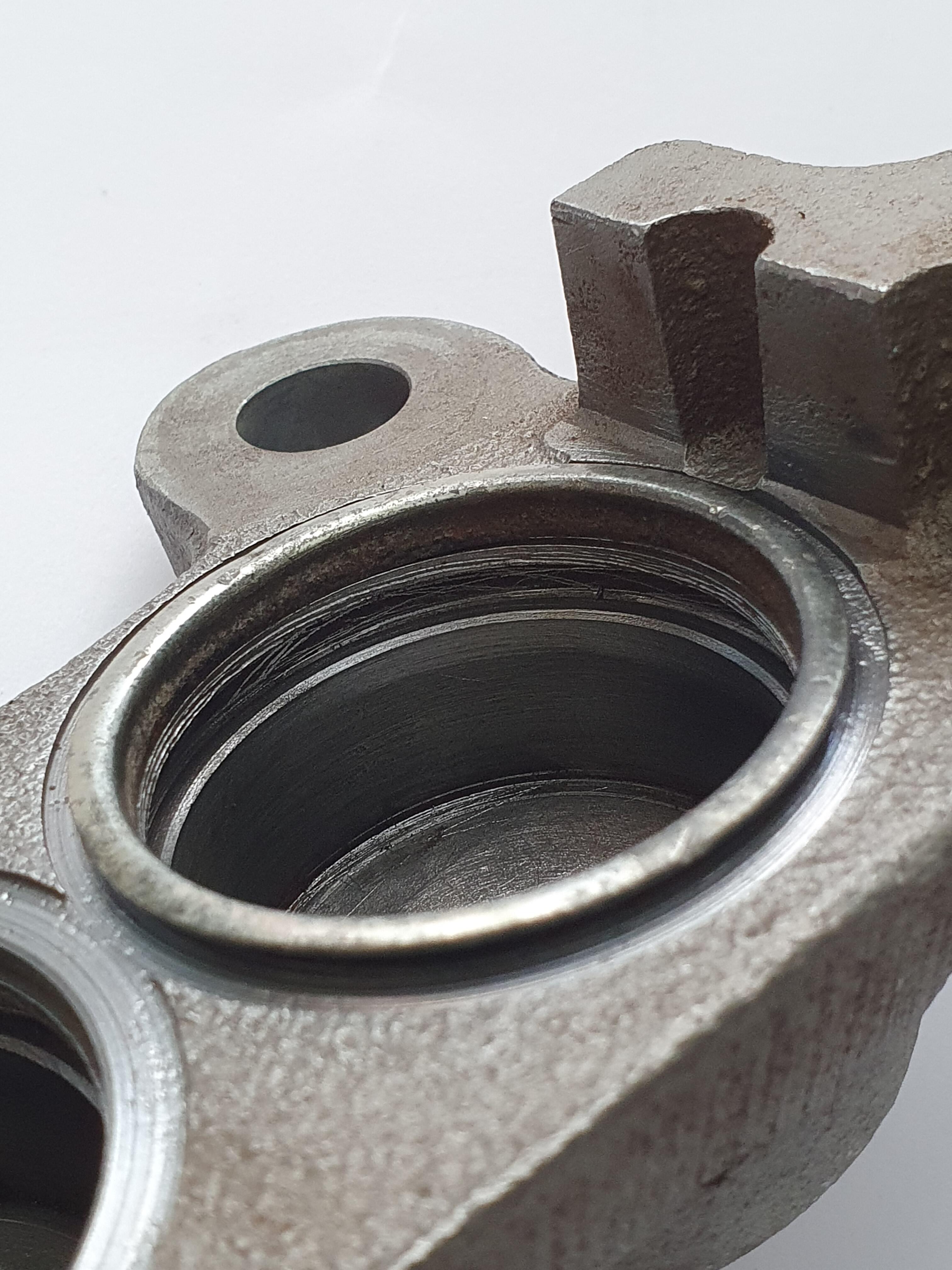

And here's a (typically rusty...) retainer ring roughly sitting in the counterbore in the caliper casting:

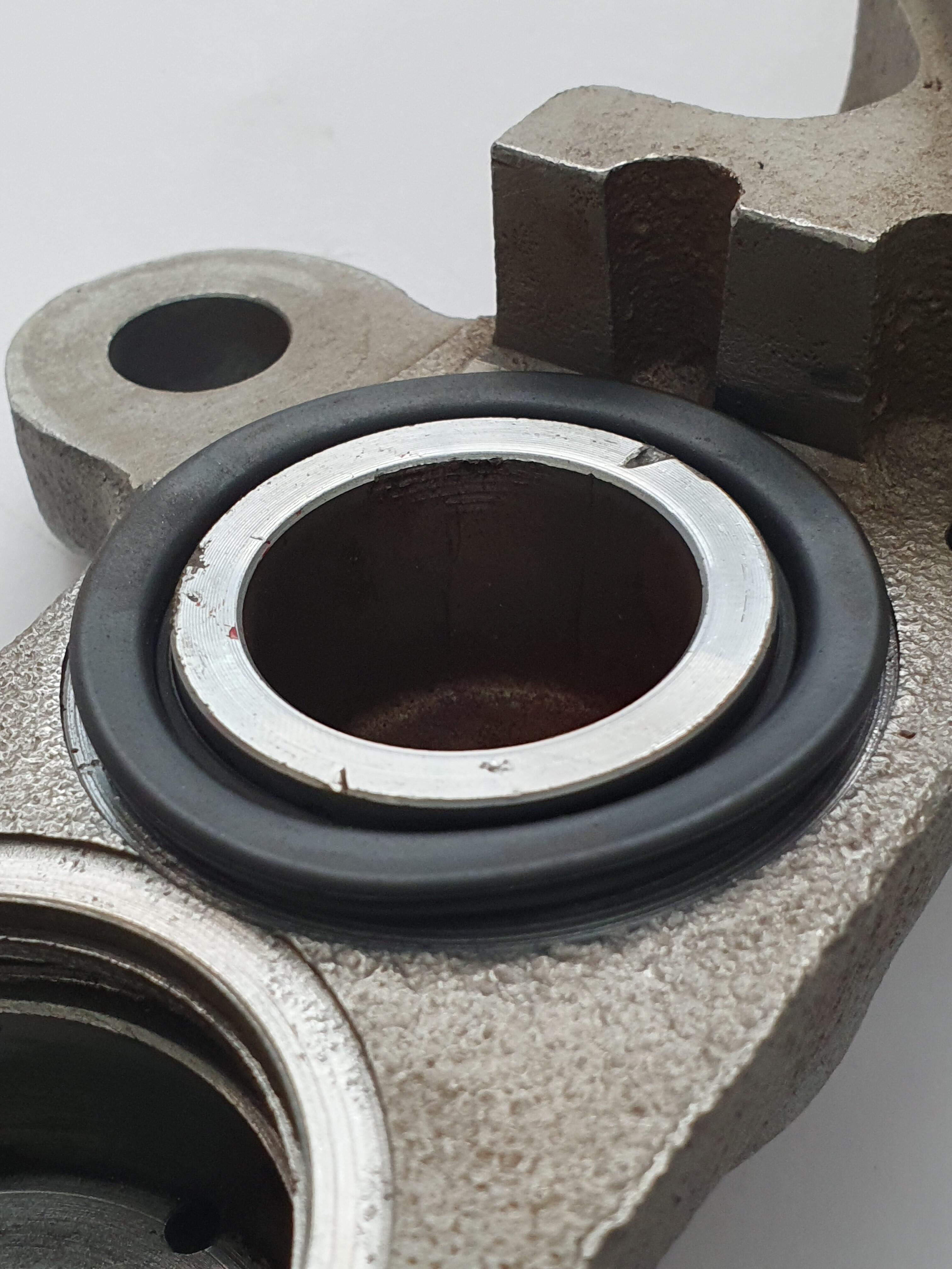

And here is the rubber dust seal, roughly installed on the lip of the retainer ring and with the piston in situ:

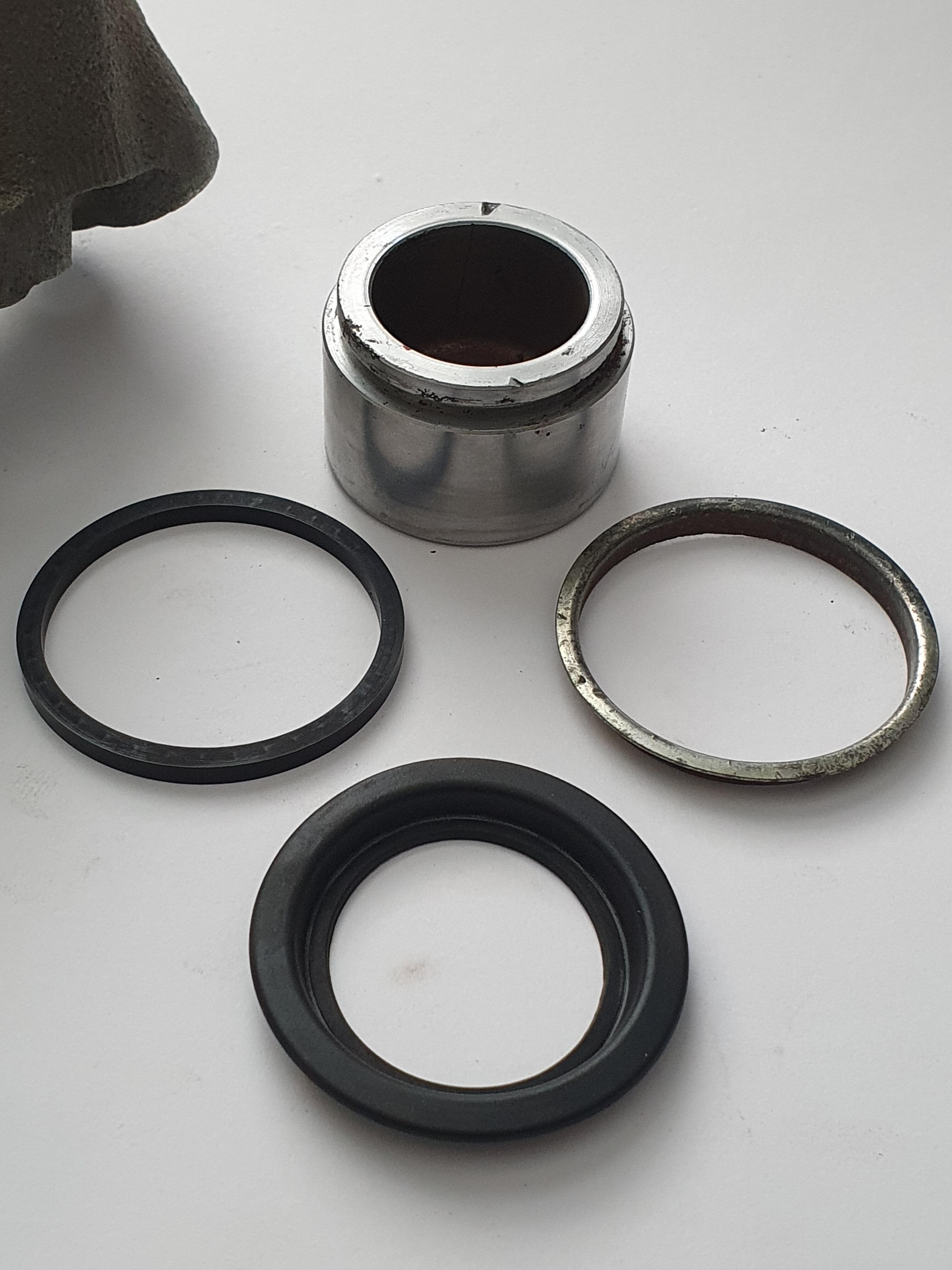

The four component parts: Piston, rubber dust seal, steel dust seal retaining ring and rubber fluid seal:

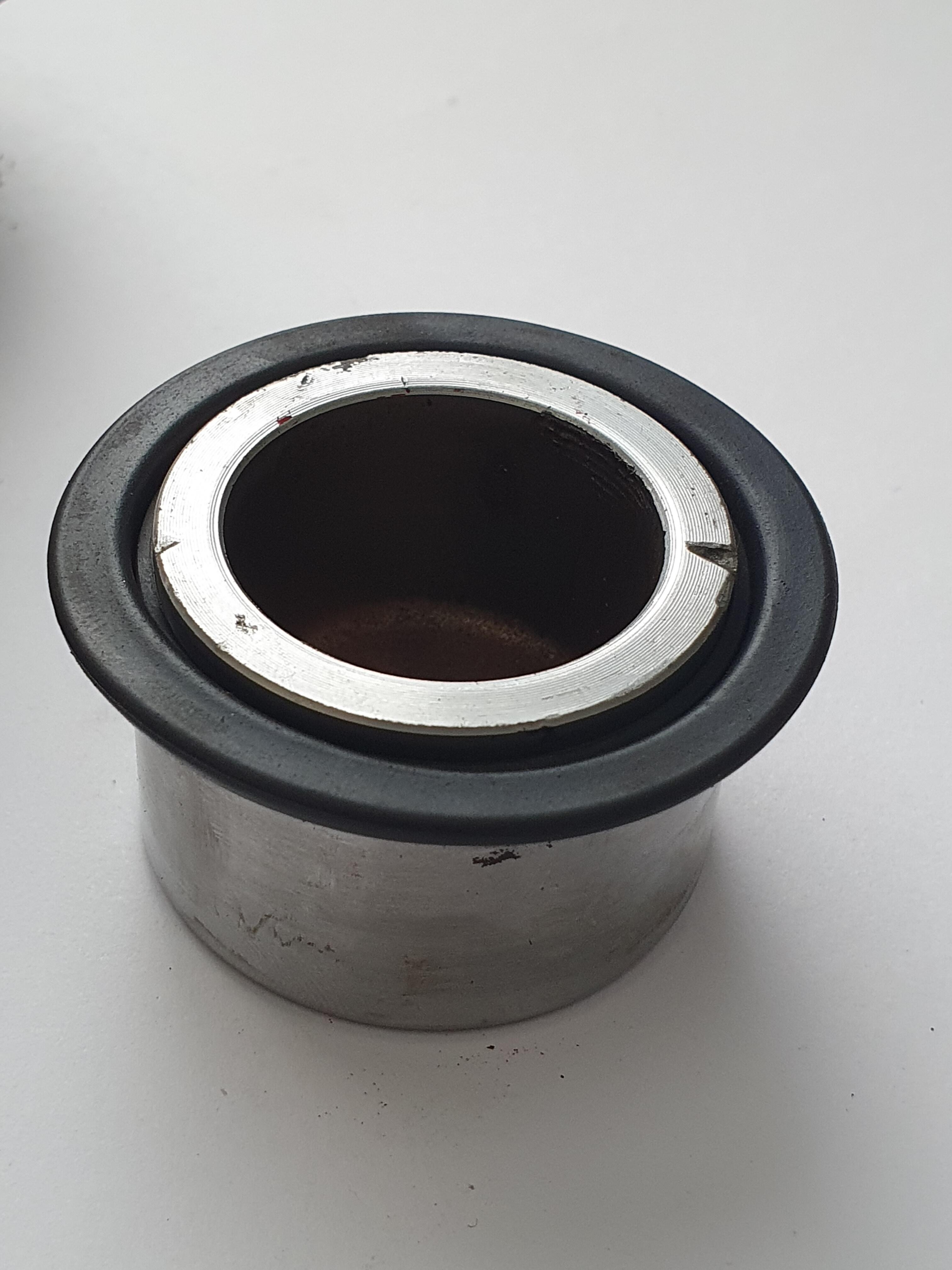

Note that the inner lip of the rubber dust seal slots into the groove in the piston, so it is fixed to both the caliper casting (via the steel retainer ring) and the piston, making a firm seal which still allows the piston to move:
