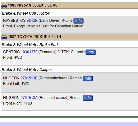

August 1, 20241 yr Author comment_667814 When installing the Toyota 4x4 brake components shown on the list below, are any spacers needed? The holes are in the right place to mount the caliper but it doesn't seem to be lined up correctly. Is the mounting bracket for the Mk63 different? Edited August 1, 20241 yr by Jeff Berk Link to comment https://www.classiczcars.com/forums/topic/69054-help-id-brake-calipers/?&page=2#findComment-667814 Share on other sites More sharing options...

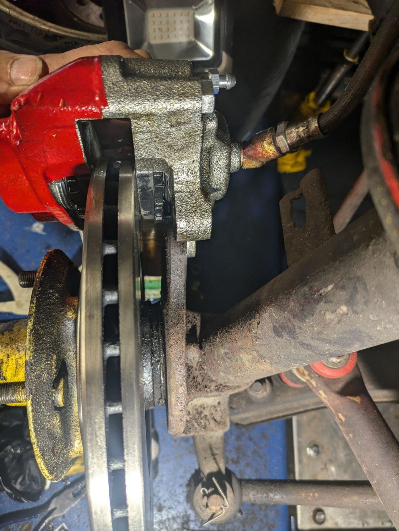

August 2, 20241 yr Author comment_667817 It looks like my caliper needs to move inward about 5mm. I wonder if I did something wrong when I repacked the bearings. Link to comment https://www.classiczcars.com/forums/topic/69054-help-id-brake-calipers/?&page=2#findComment-667817 Share on other sites More sharing options...
August 2, 20241 yr comment_667821 Do you have more pics at different angles? Link to comment https://www.classiczcars.com/forums/topic/69054-help-id-brake-calipers/?&page=2#findComment-667821 Share on other sites More sharing options...
