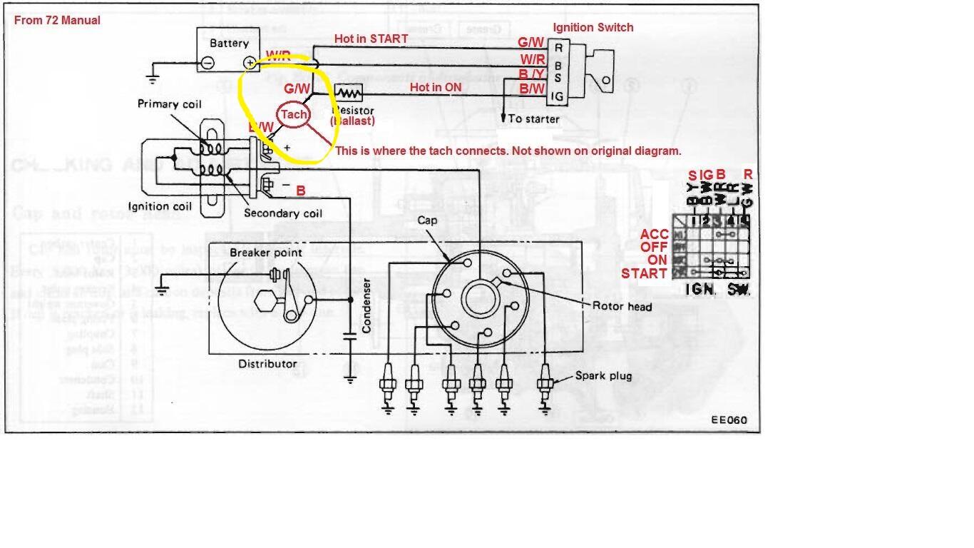

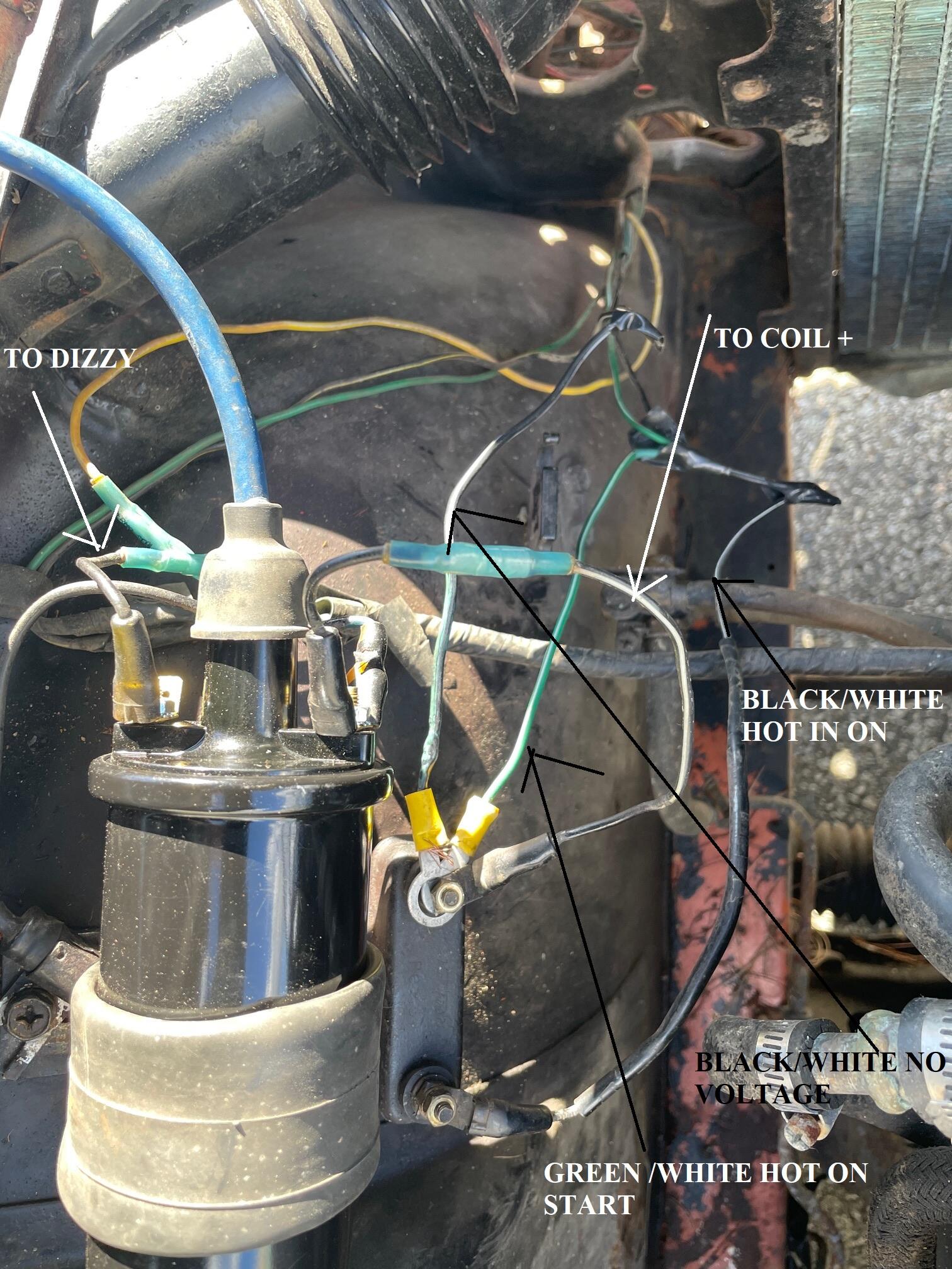

May 2, 20241 yr Author comment_664767 After another attempt to get spark it has not worked. I have clearly followed instructions on how to wire the coil and still no spark. ( I tested for spark by holding the center plug wire coming from coil to engine block ) Here is how the coil was wired. 1. Green and white to one end of resistor ( this wire did get power on start position when tested ) 2. Black and white that got power in on position to other end of resistor . 3. Black and white that got no power to resistor with green white. 4. Wire from resistor with green/wht and black white to Coil + This should have worked as all diagrams show this set up. Once again am I missing something here?? The only other note I can mention is I saw the video on how to wire the coil and the green/wht and one of the black/wht should create a complete circuit - to figure out which black/wht go where - which I did not get. The video also showed another way to fugure that out which was to find the one with voltage. That’s how I figured out which black/wht went where.. still no spark. I assume any car battery should work as I don’t have a spec battery. I have battery from another type of car but it is cranking the starter motor, so I assume that would still make spark… I tried looking under the tach but you cant see anything under there.. any other ideas?? i even tried bypassing resistor to test - still nothing... something is wrong in the yellow circle area.. as only green.wt goes to resistor.. i have now followed those instructions and possibly wrong..please clairify the correct wiring.. Edited May 2, 20241 yr by Shawninvancouver Link to comment https://www.classiczcars.com/forums/topic/68934-73-240-no-spark/?&page=4#findComment-664767 Share on other sites More sharing options...
May 2, 20241 yr Author comment_664776 any ideas?? i think the black wt i have going to resistor with the green/wt should just go straight to the + on coil,, is that correct??? Link to comment https://www.classiczcars.com/forums/topic/68934-73-240-no-spark/?&page=4#findComment-664776 Share on other sites More sharing options...
May 2, 20241 yr comment_664777 The way you've got them stacked, it shouldn't matter. Post a picture of the starter connections and where they go. Also the ground at the firewall near the battery Link to comment https://www.classiczcars.com/forums/topic/68934-73-240-no-spark/?&page=4#findComment-664777 Share on other sites More sharing options...
May 2, 20241 yr Author comment_664778 Hi. I don’t have a photo of the starter. But I know it’s pos from battery to starter motor and neg from battery to ground on engine block. How does the starter fit into this ? And it’s the “ stack” of wires on resistor totally wrong??? also no photo of ground at firewall. Link to comment https://www.classiczcars.com/forums/topic/68934-73-240-no-spark/?&page=4#findComment-664778 Share on other sites More sharing options...
May 2, 20241 yr Author comment_664779 Ohh photo of starter. If you can zoom up on it. Link to comment https://www.classiczcars.com/forums/topic/68934-73-240-no-spark/?&page=4#findComment-664779 Share on other sites More sharing options...
