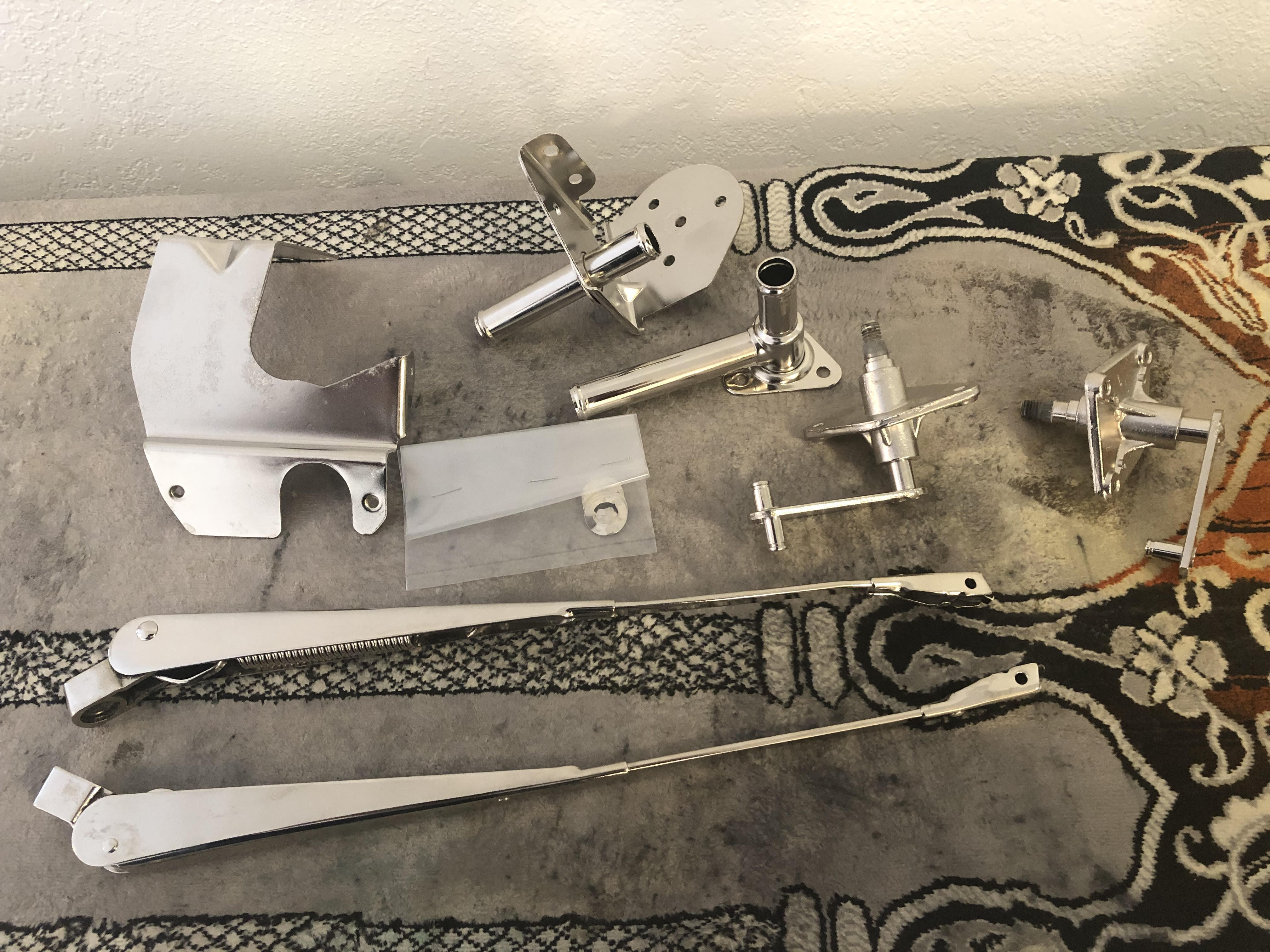

Got back few parts nickle planted. Pivots work pretty smoothly. I got an old one from ebay as well so I have an extra wiper linkage with pivot arm assembly. Will be putting on ebay once it is assembled. Let me know if anyone is interested.
Also decided to nickle plate my water cork assembly.
