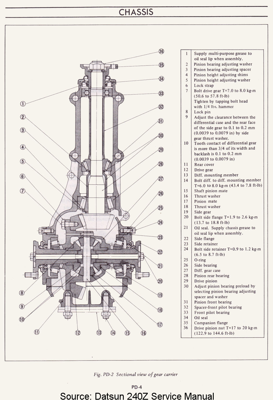

So the shims your are changing on the pinion are #4 on this diagram?
The side shims are #9 & #18?
If so adding shims is going to reduce lash because the pinion gear is conical and as it moves further back in the case lash is going to go down, but that's going to move the contact pattern on the ring. I'm not sure that I would hold to this instruction about overall thickness. You've got a new center section and new bearings. It's possible that a minor manufacturing tolerance has changed the overall thickness needed. I would be passionate about keeping the original contact patch in the same place though.

Yes to the question about the pinion shims and washer (4 and 5) - this differential only had one pinion washer and no shims at that location.  I am stacking the .001" shims at item 4 location.  Oddly, the side retainer shims do not appear to be in that picture.  The side retainer shims can be seen in this picture.
9 and 18 are probably in the stock carrier, which I am not using - I have replaced with the Quaife unit:
Note that I have not and will not be touching #30 in your picture.  Therefore, the "stack" of parts between the front and rear pinion bearings is staying the same.  I was able to achieve correct pinion bearing pre-load with about 124 ft lbs of torque on the pinion nut (a couple of times).  So, I am hopeful that none of those parts needs to be changed.
