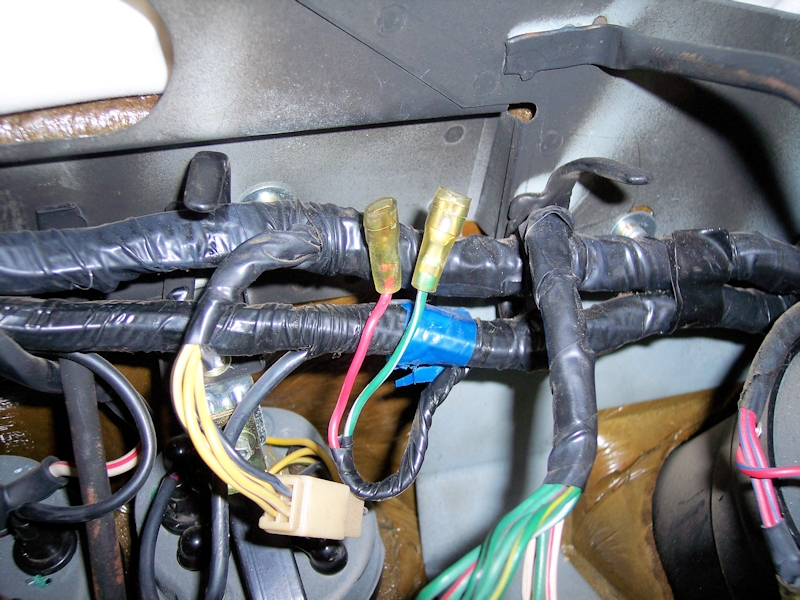

Posted June 11, 20232 yr comment_654229 I have a 1970 240Z which has some unoriginality to it. In other words: PO(s) did a lot of work to the car, including stuff like disconnecting the wiper fluid pump, etc. Anybody know what this single-wire connector might have run to? It's on the firewall side, just before the main cable bundle goes through the firewall to the cabin, and before the (I believe) windshield wiper motor wires split off. I can't make it out on the Engine Compartment Harness diagram in the FSM. Link to comment https://www.classiczcars.com/forums/topic/68379-mystery-connector-on-firewall-side-1970-240z/ Share on other sites More sharing options...

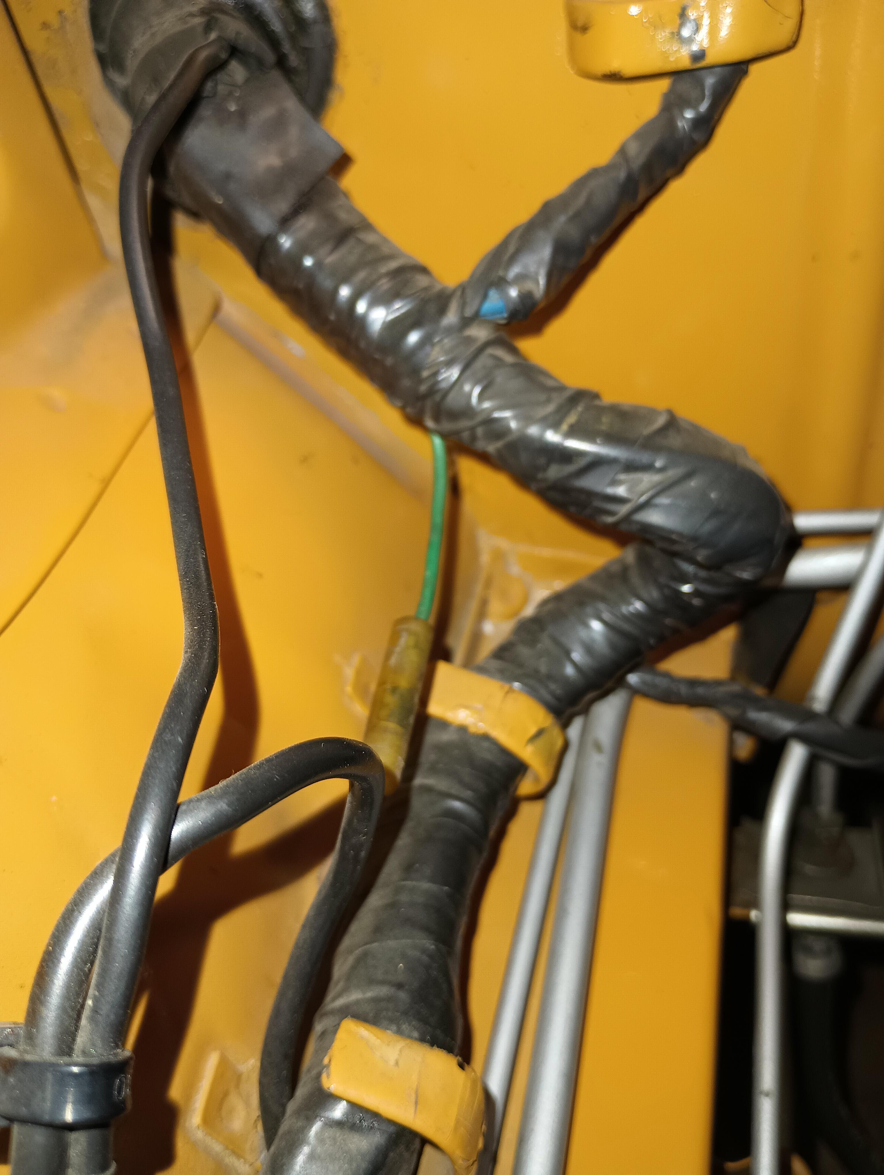

June 11, 20232 yr comment_654233 That connector is idle on my car also, a solid green wire. if the wiring harness was common to the auto transmission car, given the location it might be part of that function. Link to comment https://www.classiczcars.com/forums/topic/68379-mystery-connector-on-firewall-side-1970-240z/#findComment-654233 Share on other sites More sharing options...

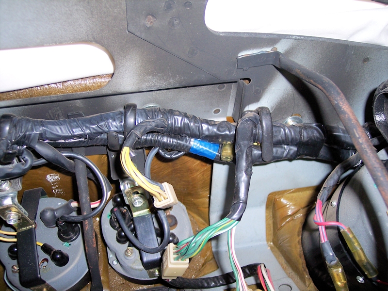

June 12, 20232 yr comment_654252 On my 12/70 car that wire was wrapped under blue tape on the harness like the wire in the bundle in the cabin for an electric fuel pump. The wire has power when the key is in the run position. It was perfect for me to use for my fan relay when I converted to electric fans. Link to comment https://www.classiczcars.com/forums/topic/68379-mystery-connector-on-firewall-side-1970-240z/#findComment-654252 Share on other sites More sharing options...
June 12, 20232 yr comment_654255 9 hours ago, w3wilkes said: On my 12/70 car that wire was wrapped under blue tape on the harness like the wire in the bundle in the cabin for an electric fuel pump. Not to hijack the OP's thread but here is one more Nissan blue tape "Easter Egg", this one is for the fog light circuit. Edited June 13, 20232 yr by jfa.series1 Link to comment https://www.classiczcars.com/forums/topic/68379-mystery-connector-on-firewall-side-1970-240z/#findComment-654255 Share on other sites More sharing options...
