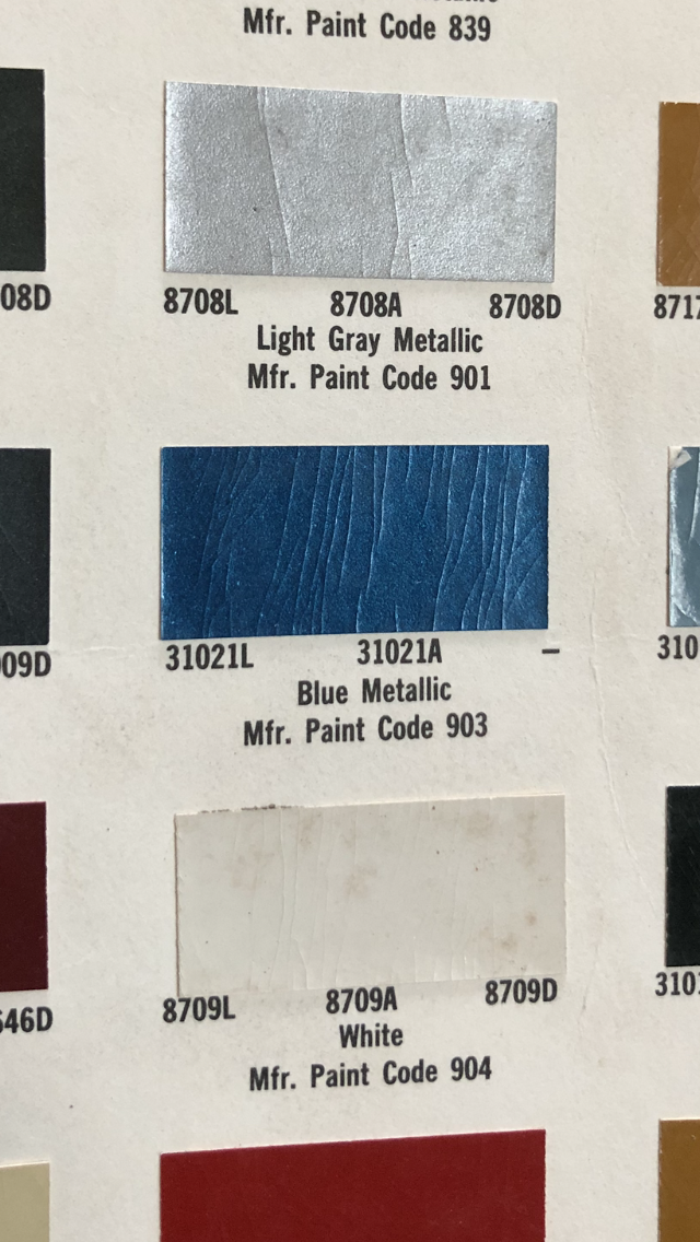

I saw the BAT 71 240Z, I really love the car’s preserved condition and the silver color. The original 901 silver something looked different  from very shiny silver nowadays. I like it. Here is a sample paint tips of Dupon. I will be happy if I can use the tips for painting my cars back to the original.
