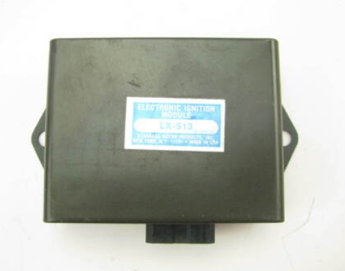

The ignition module is by the fuse box.  They're expensive.  I found an eBay ad with a picture but I have no idea where these guys would get new modules.  Also don't know if the electronics still age when not used.
Don't get carried away.  Only posting this for the picture and for anyone else who might need one and want to take a gamble.  Seems too cheap to be true.
Put "NEW - OUT OF BOX Ignition Control Module For 1978 Datsun 280z 2.8L S30"  in the eBay search box.
https://www.ebay.com/
Interesting, That seller https://www.ebay.com/str/sparksurplus has over 110K items for sale, and over 2300 Datsun items that look pretty nice. Reasonably priced too. For all Datsuns.
I do not know the seller at all or purchased anything. Just an observation.
I think I have one of those ICM's too. Just not sure of the car it is from.
The 75-77 models have a screw panel for the connections.  78 is the only one with the plug connector.   I think that all of the plug connector Z ignition modules are the same.  The eBay price is stiff competition though, compared to what they used to go for.
The picture looks right.  Wonder where the warehouse of old new ignition modules was, that these Spark people found.

I got home last night. This morning I started my car. It ran much better I am not sure why though. The tach would slowly fluctuate between 750-900 RPM. It would also freely rev like it should.  Also it was not smoking. Go figure. The next time I go to start it will act up. I have an intermittent issue somewhere. I did unplug the fuel pressure regulator and it appeared to be dry. I bought the ignition control module on ebay.  Thank you again for your help.

Thanks- I ordered the ignition module from them. Hopefully will fix it or maybe some part of the issue.

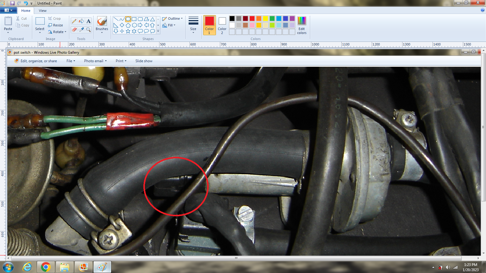

I unplugged the cold start valve and it made no difference-I live in Florida so I don't think it is ever needed hear. Where is the auxiliary air regulator? Thanks for your post!
After reading more it sounds like you're onto something electrical related? I was just thinking of some easy things to check first. Here's the AAR plug-in and one of the best helps I've gotten for my '77 280. Good reading with lots of photos. Hope you get it figured out soon.
