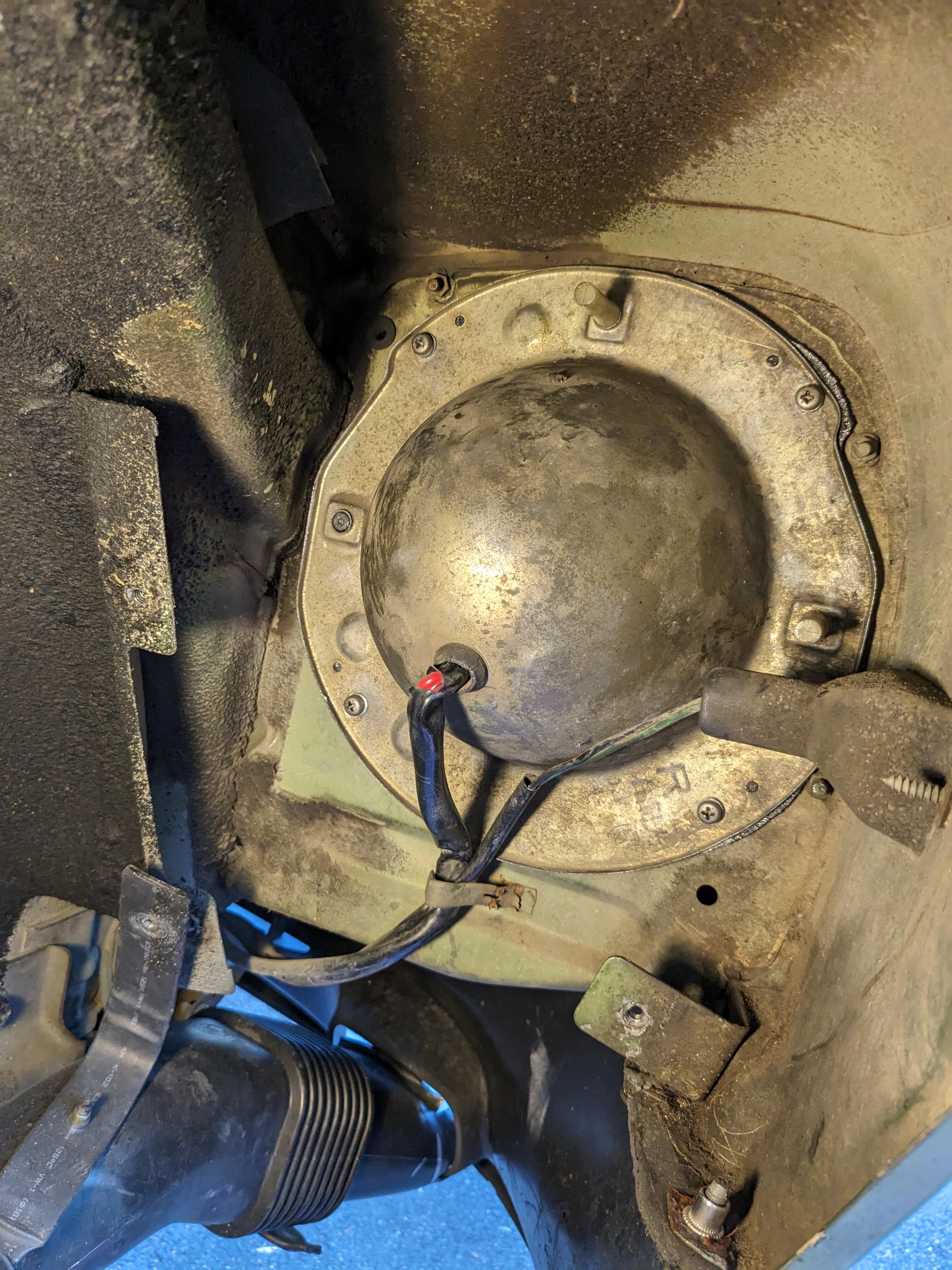

I put in my old Hella H4's (from the X1/9) with the LED bulbs Steve recommended. One of them has water damage, so I ordered the Kioto H4 housings while they are still available, at such a good price.
housings came out smoothly, no snapped or stripped hardware. I didn't order new gaskets, so I cleaned & lubricated them for reinstall

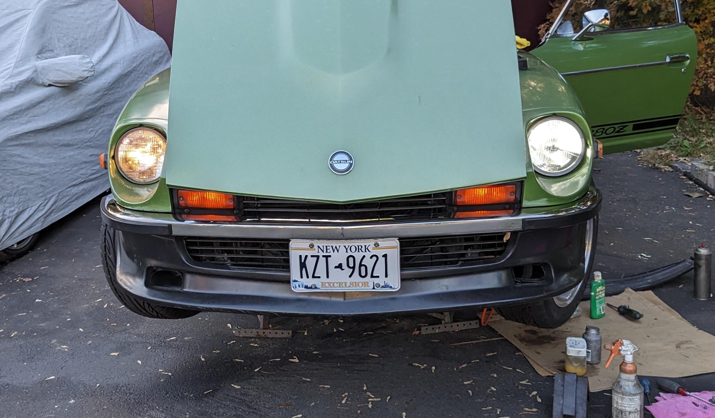

Comparison of sealed  (low) beam to LED
Edited by HusseinHolland
9 minutes ago, SteveJ said:
I hope you enjoy your night driving, @HusseinHolland.
Thanks Steve - I actually need it for the drive to work 🙂 - I teach high school, so I'm out the door by 6am.
