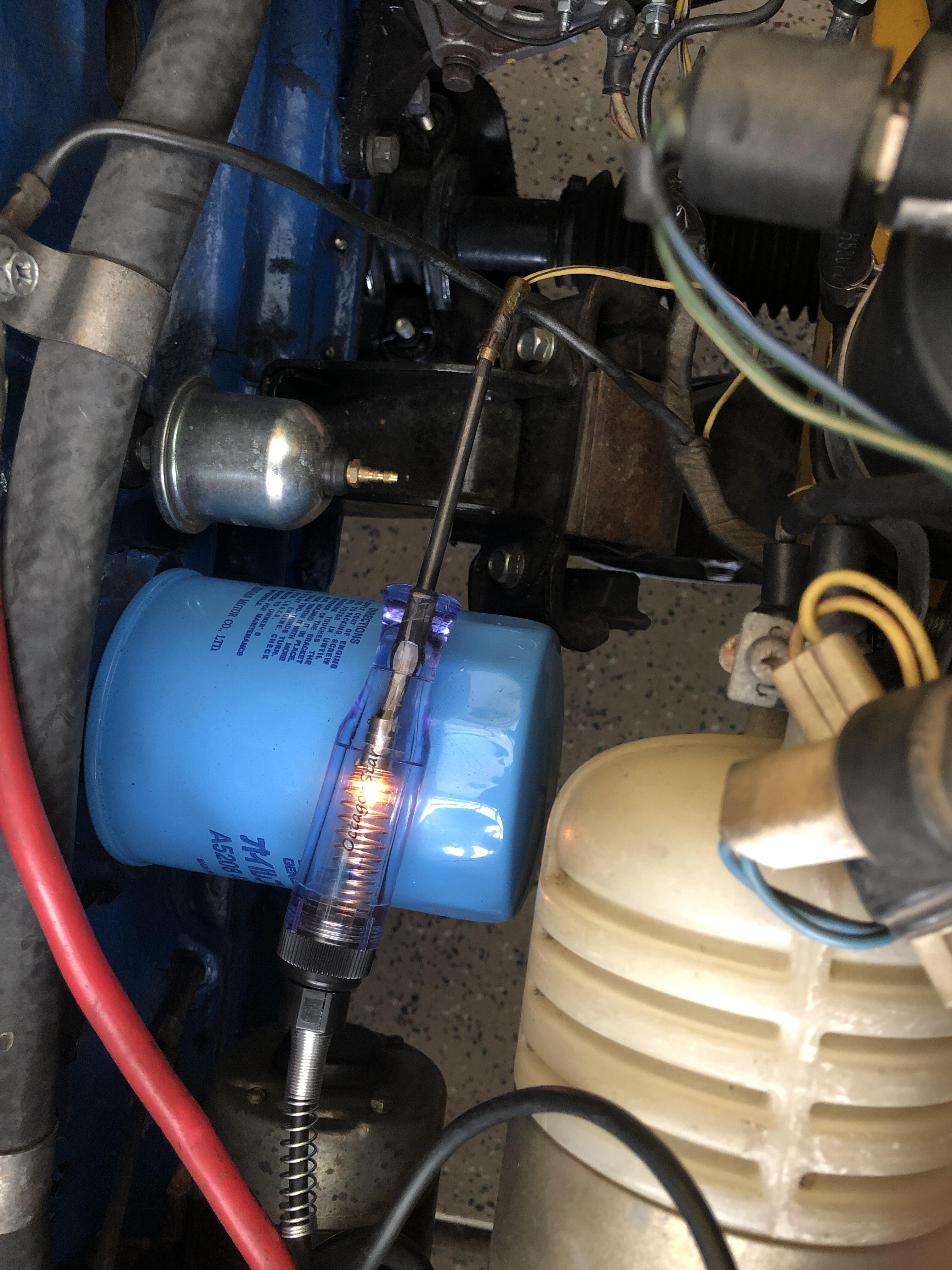

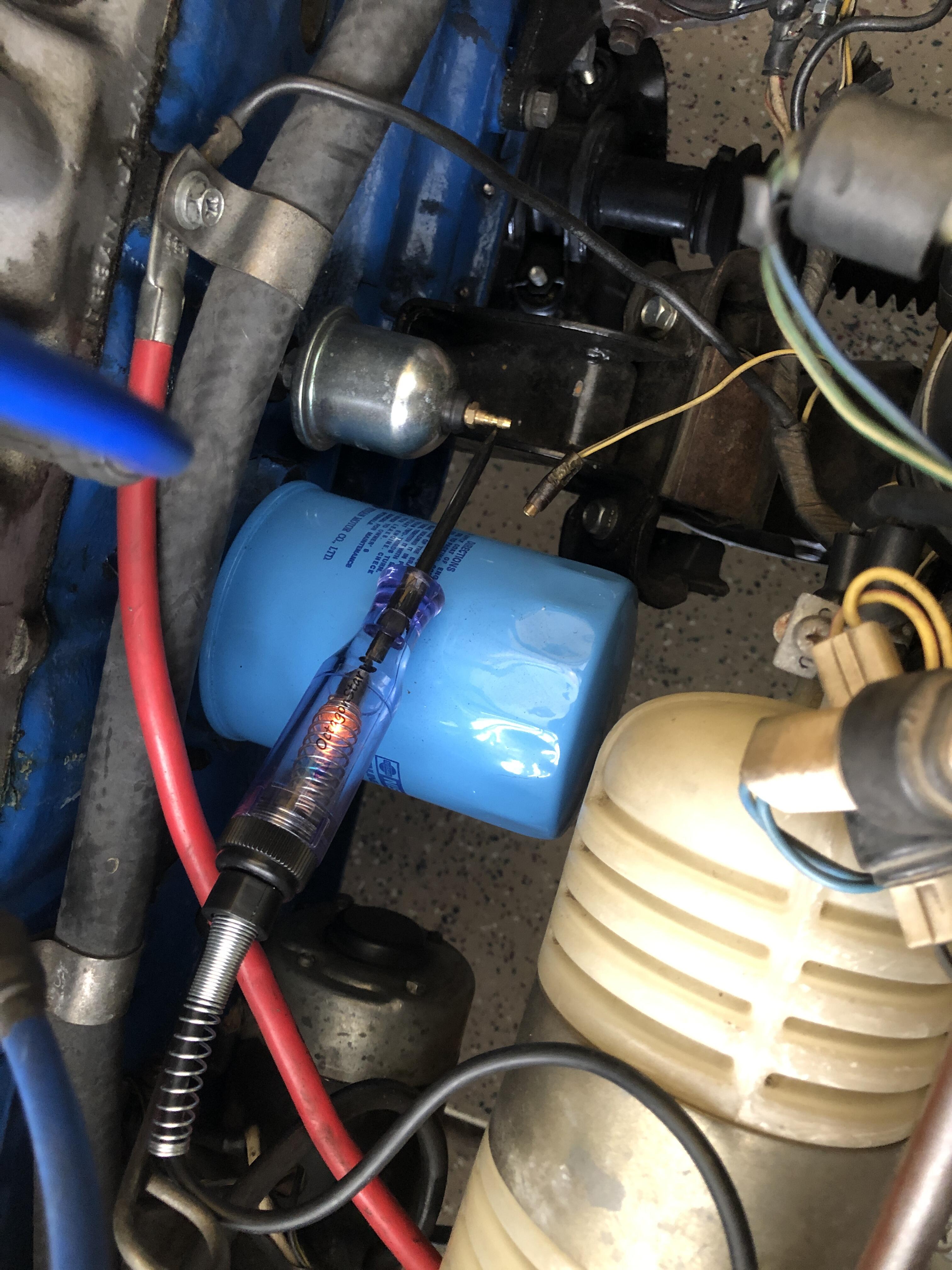

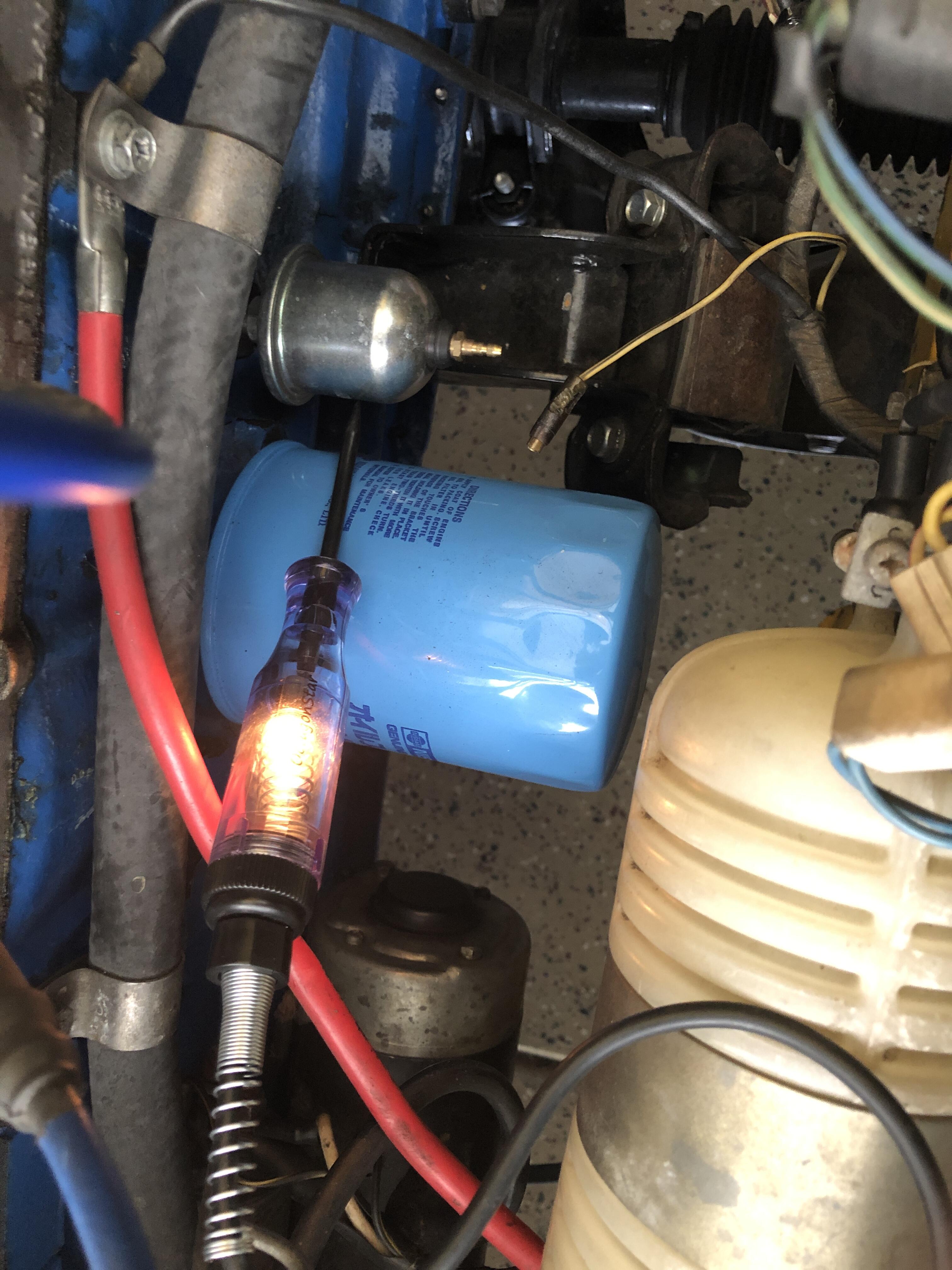

Not sure how the oil sender unit should function… below are some photos at various points.   The light is dimmed at the bullet pin.  I also had a video showing the light is blinking constantly at the tip.  Will attach the video later.
Yes.  I read that post.  The gauge works.  Ground the wire and within seconds the needle pegged to the right.
definitely there’s resistant in the sender unit.  The test light blinking but dim compare to the chassis.   I did rev up the engine but test light behave the same.  I wonder should the sender varies when engine is rev up?!.
how do I measure resistance on the sender while engine is running?  Just connect ohm meter to the sender pin and to chassis ?

Using Light to test and notice the light strobing
Using voltmeter to measure the resistance.
The fluctuation of the test light is right in line with the operation of the oil pressure metering circuit. If you measured voltage to ground where you put the test light, you would see fluctuating voltage.
It would be easier for you to read the ohmmeter at the 200 ohm setting, but it appears as though the sender is working. It was disconnected from the wire from the gauge, wasn't it?
