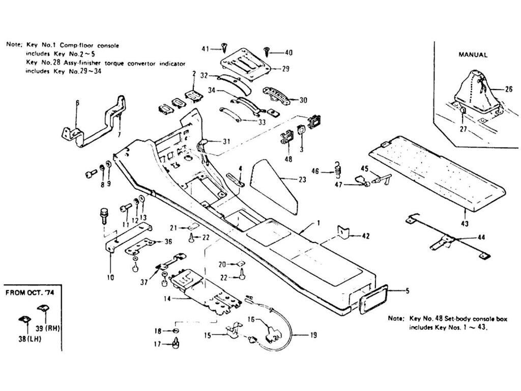

It is not shown in the parts breakdown above and it has nothing to do with the console or the radio. In fact, if the center console is removed, that bracket stays with the dash. It does not come out with the console.

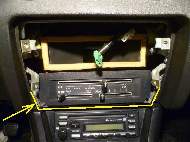

Here's a couple pics showing where that bracket goes:

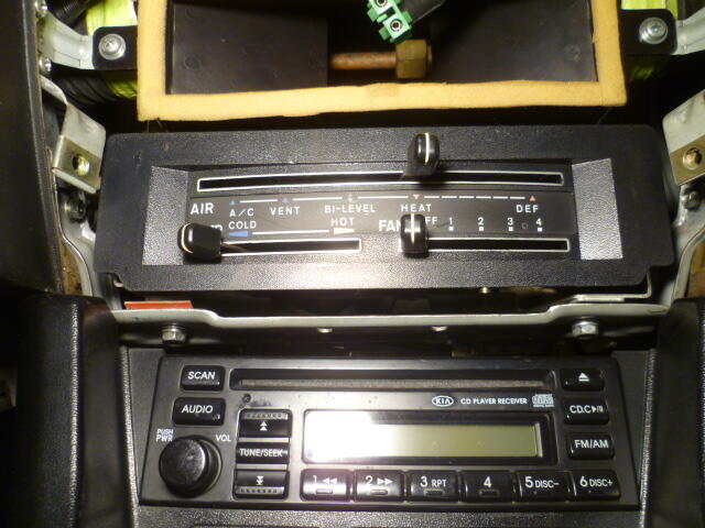

And here's a closer-up trying to get a shot of the mounting hardware:
Hope that helps!
