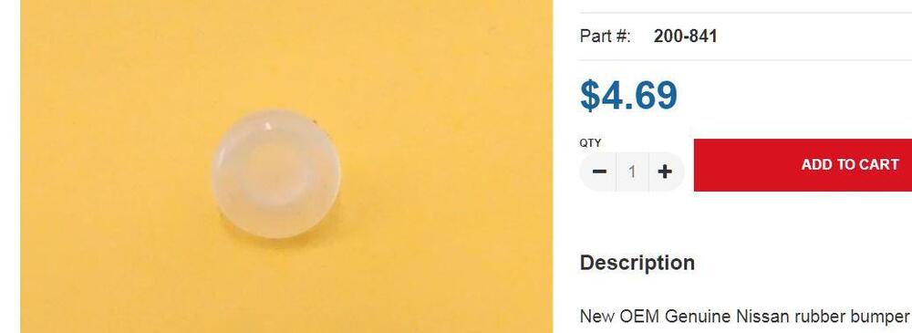

May 17, 20223 yr Author comment_640499 Upon manually pressing the brake light switch the lights does go off. I do see some plastic on the floor and a hole in the brake padel lever where the switch pressing when u release the pedal - is there a replacement part to fill that hole gap? Also, i did check the battery and it is fully charged and it does not what so ever crank the engine. Like I said i parked the car overnight and it was cranking up fine. Cannot thing of thing that can go wrong overnight. While ignition at start i should see 12v at the solenoid wire signal terminal correct? I can probably start from there. Any other advice? Link to comment https://www.classiczcars.com/forums/topic/67485-help-rear-red-lights-on-and-no-power-to-starter/#findComment-640499 Share on other sites More sharing options...
May 17, 20223 yr comment_640503 A photo of the gap would be helpful. Yeah you can use a voltmeter on wire that goes to the stator, yellow wire IIRC. Link to comment https://www.classiczcars.com/forums/topic/67485-help-rear-red-lights-on-and-no-power-to-starter/#findComment-640503 Share on other sites More sharing options...
May 17, 20223 yr comment_640504 This is likely what will fix your brake lights on constantly.  Zcar Depot   Link to comment https://www.classiczcars.com/forums/topic/67485-help-rear-red-lights-on-and-no-power-to-starter/#findComment-640504 Share on other sites More sharing options...
