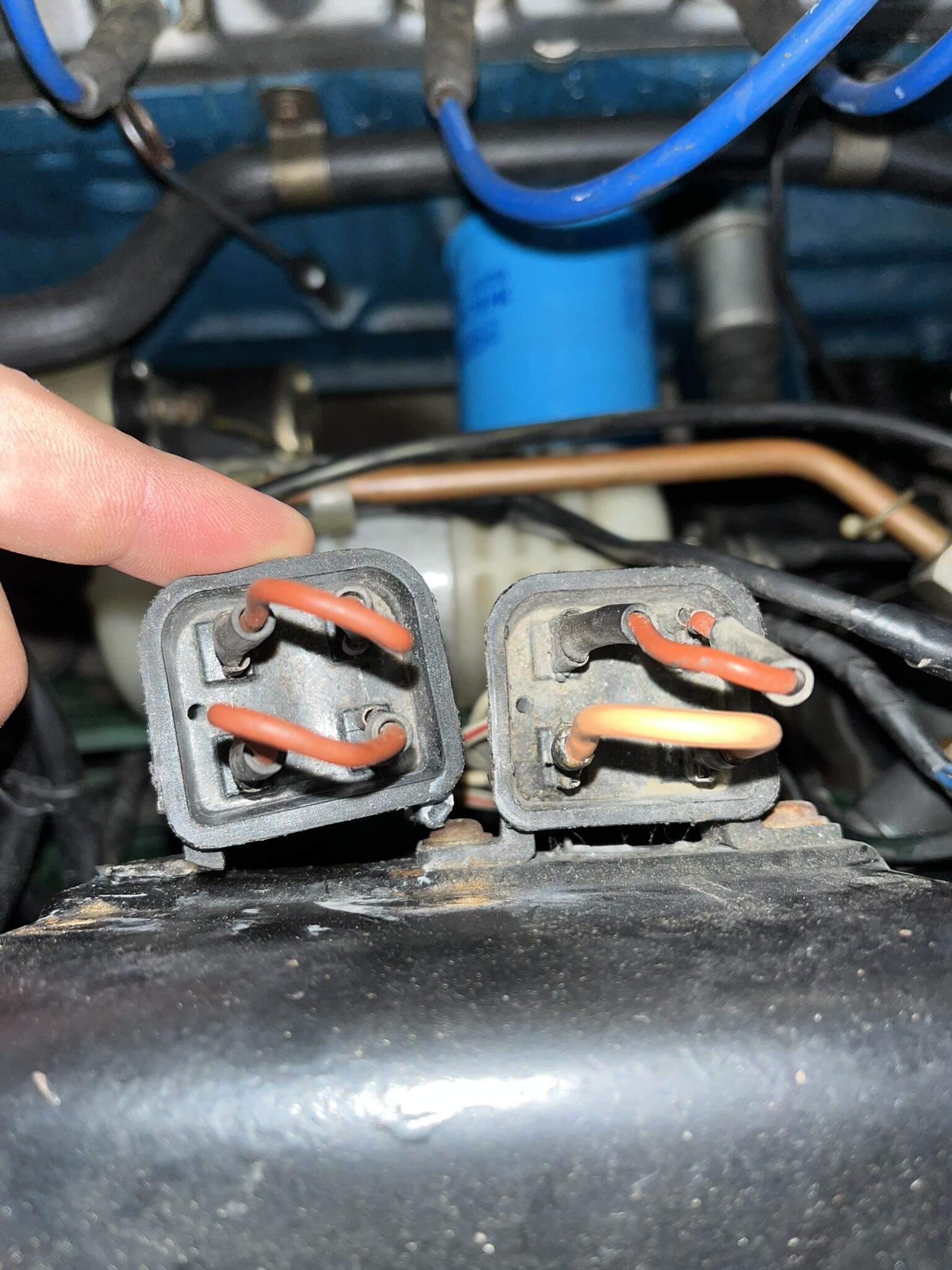

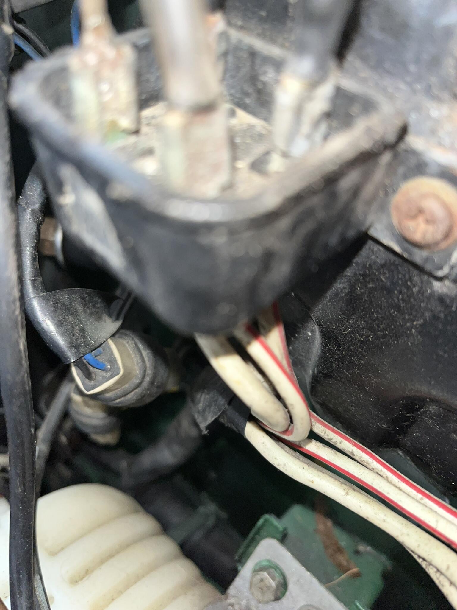

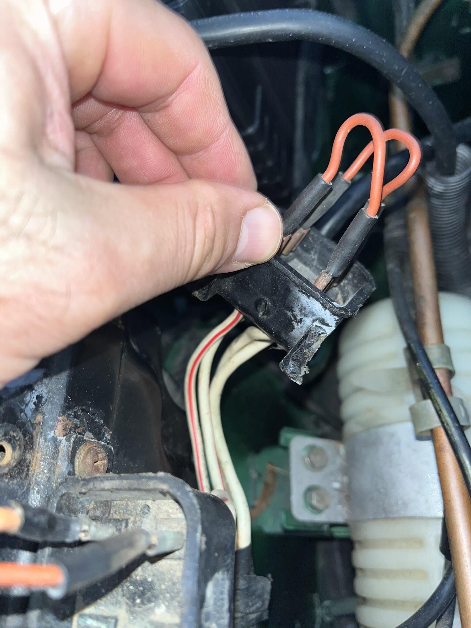

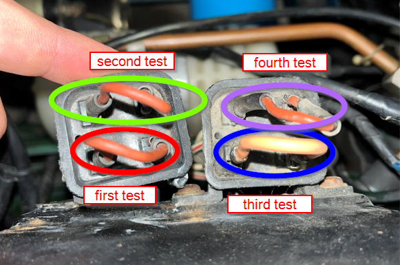

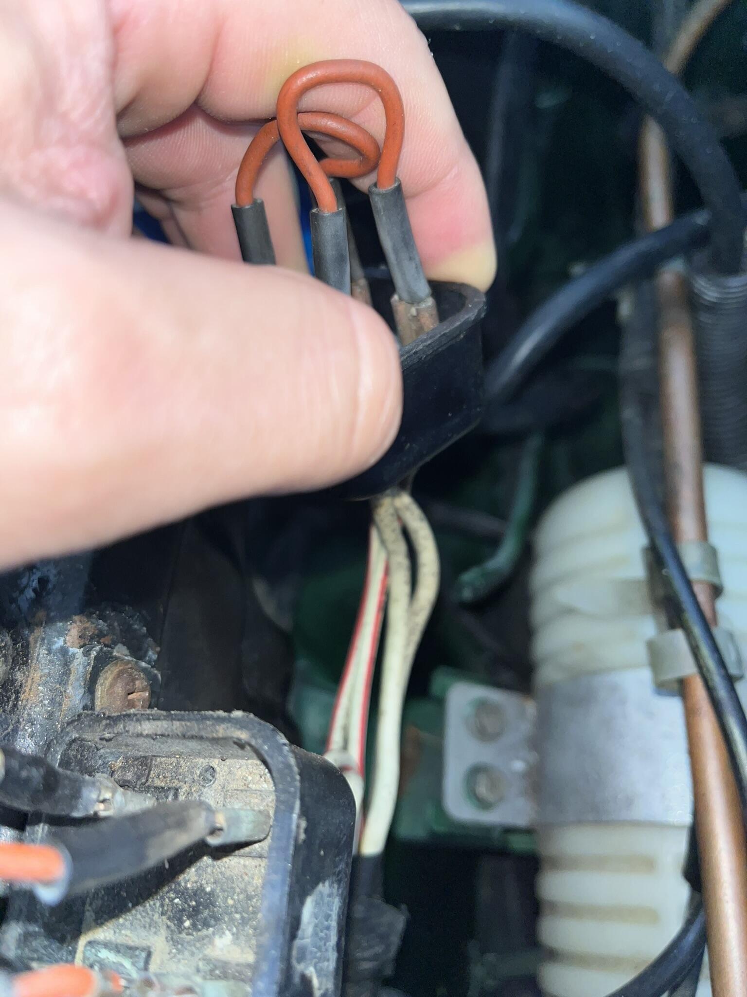

April 19, 20223 yr Author comment_639472 SteveJ, I got all the items and did your test. I tested the light on the battery first to make sure it worked. I then went one by one on the fusible links and it did not light up for any of them. I attached some pictures of the fusible links in case it helps. The light is not on in the car and the clock never worked. I did not always have this battery issue. Link to comment https://www.classiczcars.com/forums/topic/67400-280z-starter-draining-battery/?&page=2#findComment-639472 Share on other sites More sharing options...
April 19, 20223 yr comment_639477 I double checked the testing with an 1156 bulb using my parking lights and headlights (all LED). The improvised test light only lit up when I turned on the headlights. My more conventional test light (similar to this - https://www.harborfreight.com/612v-circuit-tester-with-5-ft-lead-63603.html?_br_psugg_q=circuit+tester) lit up with only the parking lights. That means I might have steered you toward an inconclusive test (false negative). You could re-test with a purpose built test light like I linked or with an ammeter. Just because the clock isn't running doesn't mean it's not drawing current. It might be drawing more current if the motor is trying to overcome increased friction. Link to comment https://www.classiczcars.com/forums/topic/67400-280z-starter-draining-battery/?&page=2#findComment-639477 Share on other sites More sharing options...
