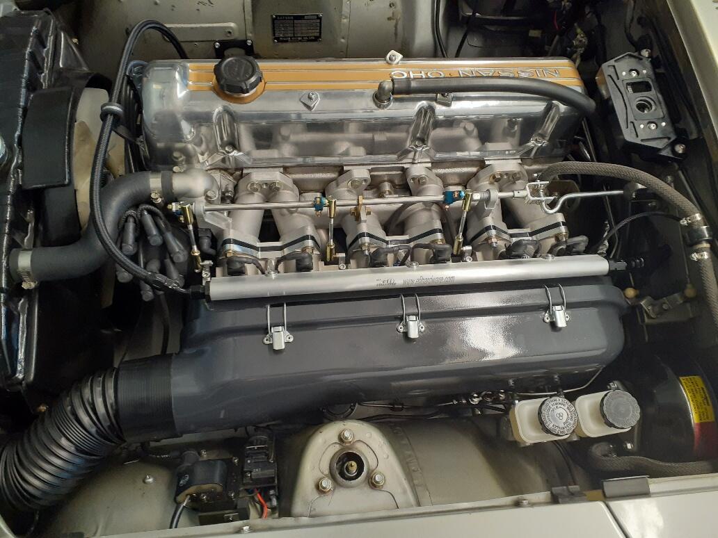

The EFI set-up is complete. Worked with Haltech remotely engine is running but chasing down a vacuum leak. Also having a weird issue with the electronic distributor connection to the ECU. Losing the grounds randomly.
First questions: Need to add a grounding strap from the chassis to engine block. Why, attempting to move my star ground (all required ECU ground connections) to another point (currently chassis).  Where is the best connection point? The engine bay harness is a stock 73 240Z. Is the chassis ground under the battery box off the harness a good point for a chassis to engine block strap? The FSM manual will not help with this issue, adding ground connections.
Second question: Also running a single coil with igniter (no problems), all the stock 240z coil, distributor, resistor wires have been terminated and secured. Harness is still intact on left front fender. Is the green/white wire (ground) a usable ground wire in from the old harness for a chassis ground?

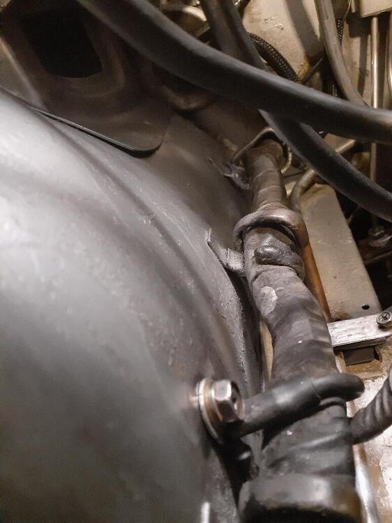

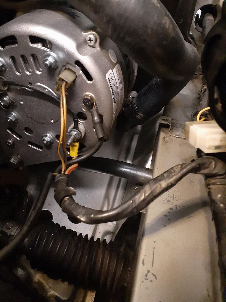

Alternator has been upgraded with MSA 60 amp with harness adapter. See pic of wiring, assume the ground wire from the stock harness is linked the chassis ground below the battery. I'm not seeing a ground wire to the engine block from the alternator. Not seeing any ground wires to the block other than the battery to starter.

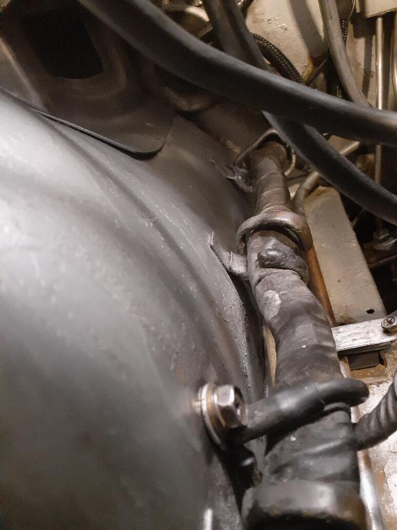

What is the resistance from battery negative to the grounding screw in the photo?
How about resistance from battery negative to the grounding post on the alternator?
Again, if you have the stock connections on the battery, you have a large gauge wire to the starter and a smaller gauge wire (around 10AWG or so) going from the battery negative to the firewall. If you don't have the second wire, your grounding could be compromised.
The starter is firmly bolted to the bell housing which, in turn, is firmly bolted to the block. The cable is the weakest link in that chain. The next weak link is corrosion on fasteners or between components.
Also, don't be afraid to take a resistance reading between the engine block (unpainted surface like the bolts around the timing chain cover) and the shock tower studs. Have the meter on resistance, not continuity. You want the number, not a buzzing.

VM set 20k omhs and neg battery post. All connections, chassis bolt (in pic) and on the firewall, alternator neg, block, started neg cable bolt all zeroed out. Since the engine will not start, The only dynamic test I can do is ignition on, fuel pump running.
Same VM setting 20k
Chassis bolt below the battery, 22, alternator neg bolt 24, block 20, star grounding connectors, 12.
When I touch the signal ground wire for the distributor connector with the ignition on, bounces, 4-24 randomly. Is this common for a signal ground?
One main ground wire from the ECU to the battery - (input)  All signal ground wires for the components are ECU outputs and are tied in the main harness to pin 10 battery - input.
Those readings seem high, though it could be, in part, due to technique.
