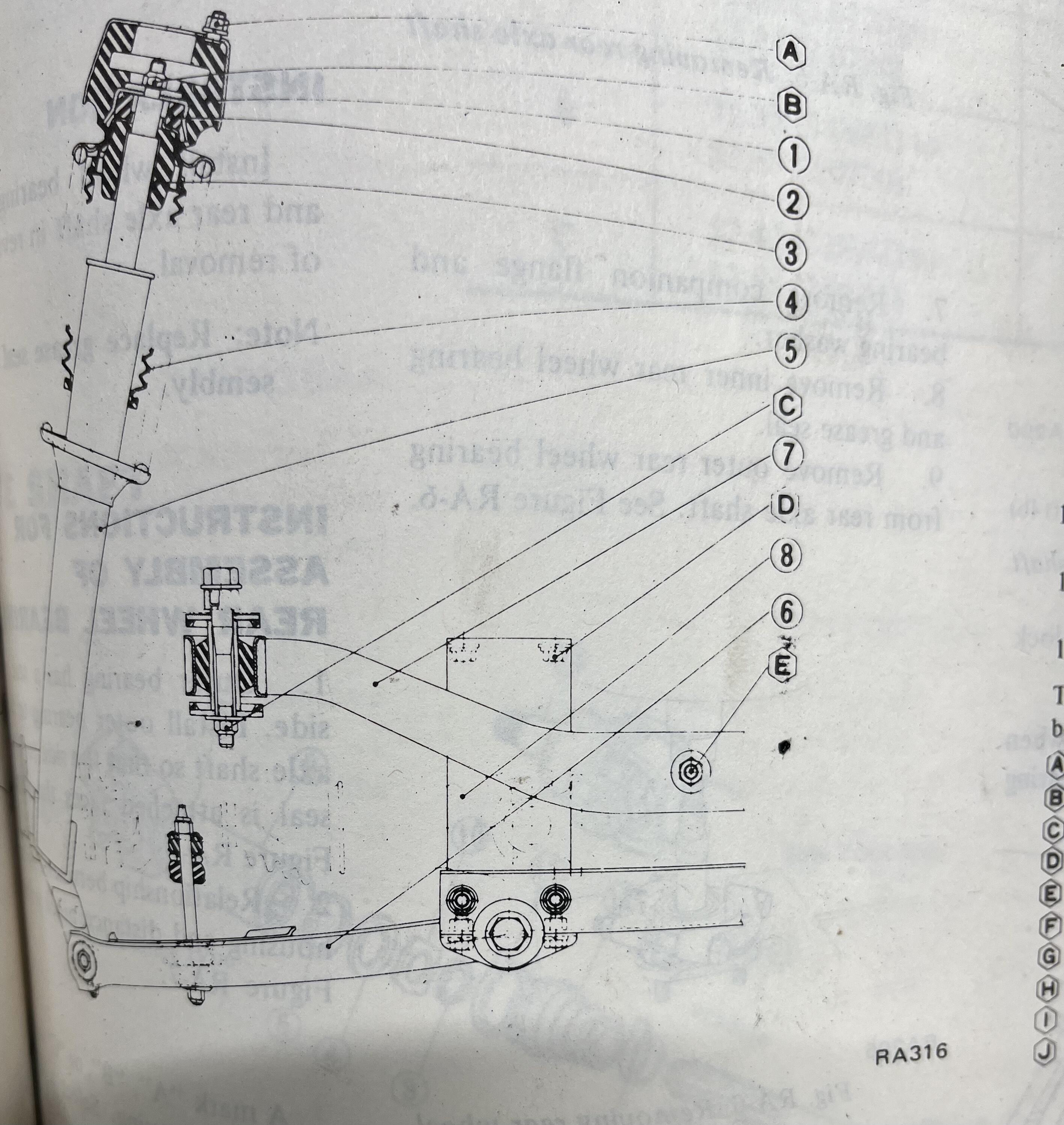

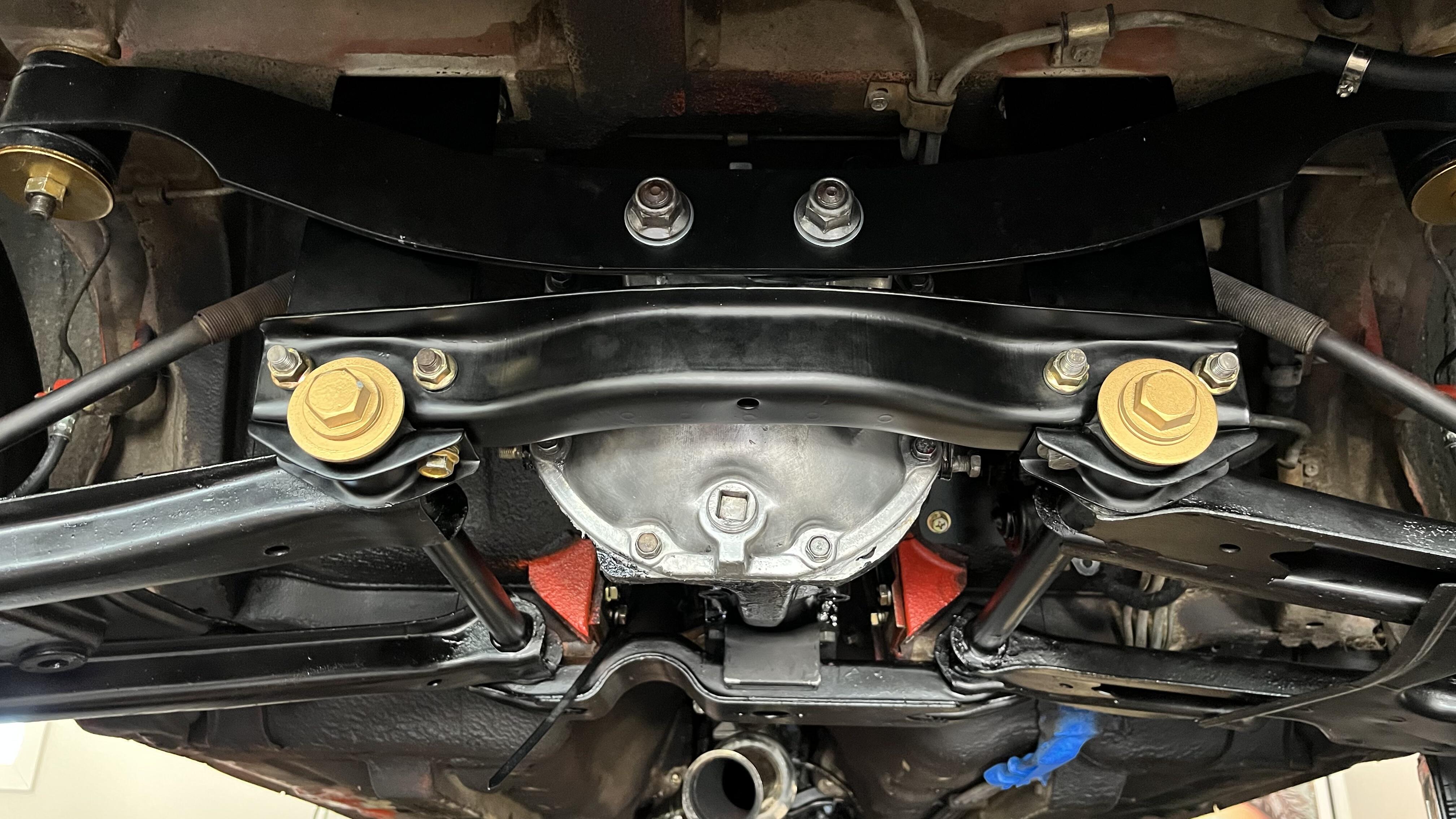

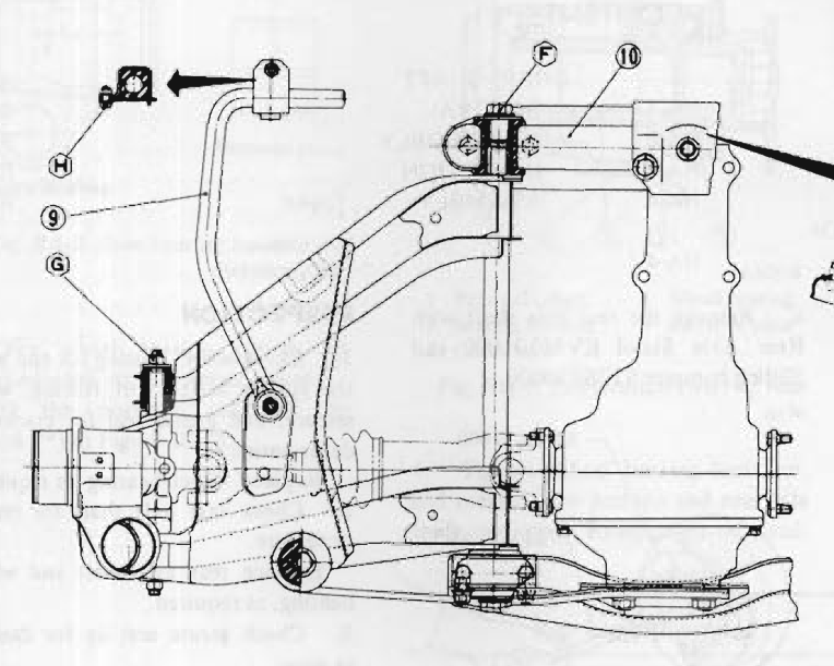

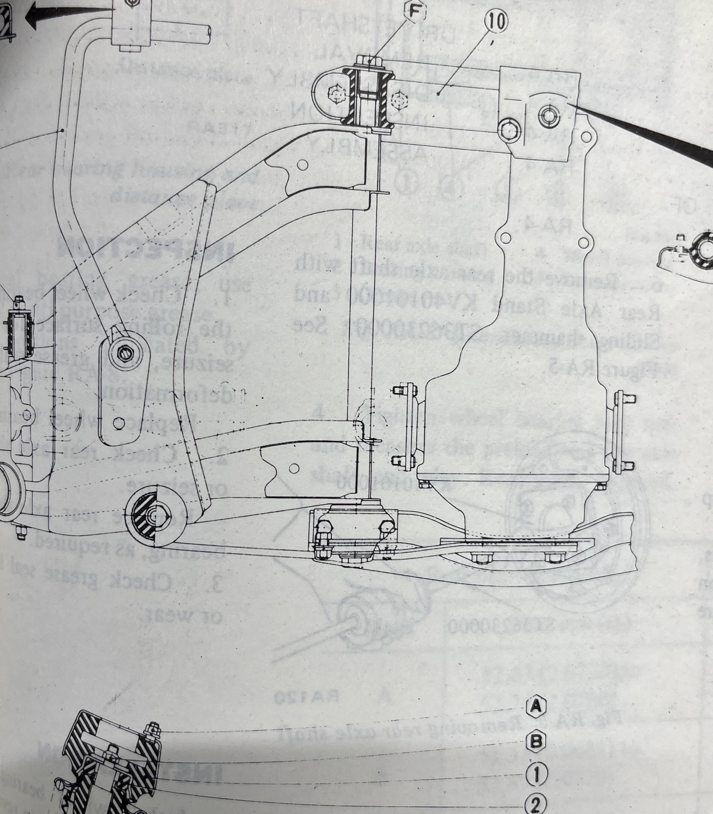

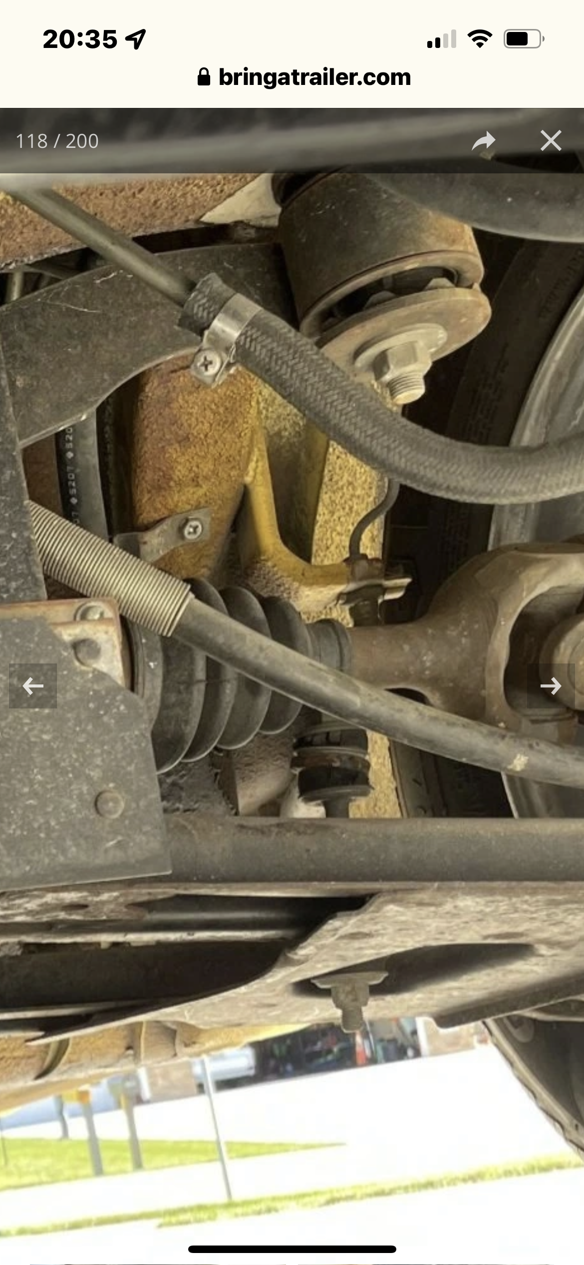

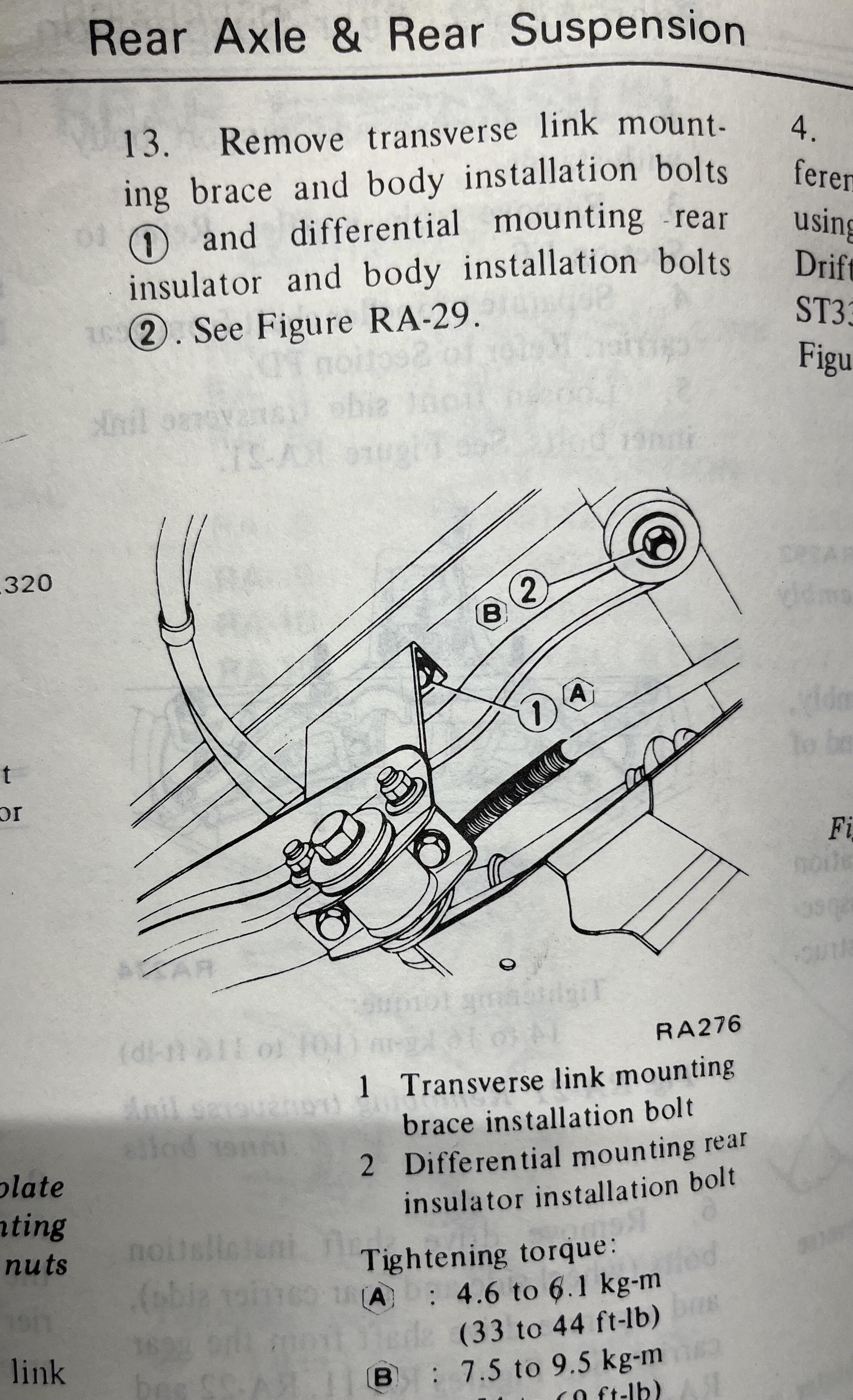

April 24, 20223 yr Author comment_639684 Okay, I need an assist. Got the bushings installed on my mustache bar. Now I’m confused after 4 weeks which way it goes back on. I went to the FSM and there is a discrepancy in that publication showing 2 different install directions. Looking from the back to from the loops (with the bushings) face forward or aft . I thought forward and then found two diagrams in the FSM that conflict which each other? This determines if the bar goes in front or behind the rectangular brackets hanging. See the attached diagrams from FSM. First shows mustache bar behind brackets and loops facing the back of car. Last two pics show the exact opposite. Am I missing something here? I can’t be the fist guy confused here? It came off as in last two pics but recall mine wasn’t seated properly either so I think a PO was messing down here before. Link to comment https://www.classiczcars.com/forums/topic/66453-77-280z-restoration/?&page=8#findComment-639684 Share on other sites More sharing options...
April 24, 20223 yr comment_639685 The bar is installed with the loops facing toward the front of the car. You must have had too many umbrella drinks on your vacation.... lol Link to comment https://www.classiczcars.com/forums/topic/66453-77-280z-restoration/?&page=8#findComment-639685 Share on other sites More sharing options...
April 24, 20223 yr comment_639688 I have seen both kinds of bars. Forward and rearward bars. I would think it would depend on what bar you actually have. Did 280's come with factory supplied rear sway bars? Link to comment https://www.classiczcars.com/forums/topic/66453-77-280z-restoration/?&page=8#findComment-639688 Share on other sites More sharing options...
April 24, 20223 yr Author comment_639690 37 minutes ago, S30Driver said: The bar is installed with the loops facing toward the front of the car. You must have had too many umbrella drinks on your vacation.... lol I agree with you, but clearly the first drawing shows it the opposite direction. Maybe R180s use less space so it could go the other way??? I did have a lot of umbrella drinks on vacation so if this is the only bad outcome, I can live with that!!! Link to comment https://www.classiczcars.com/forums/topic/66453-77-280z-restoration/?&page=8#findComment-639690 Share on other sites More sharing options...

April 24, 20223 yr comment_639694 Picture 123 here might show what you want. Seems to have all of the stock parts, including the damper weight. Browse the other 280Z listings to be sure. https://bringatrailer.com/listing/1977-datsun-280z-71/ Link to comment https://www.classiczcars.com/forums/topic/66453-77-280z-restoration/?&page=8#findComment-639694 Share on other sites More sharing options...
April 25, 20223 yr Author comment_639699 So, the link sent by ZedHead shows a setup like first FSM drawing. That 1977 Zapp car has a 4 speed and what appears to be a R180. Could this be the difference? Right now I’m installed like drawing 2 & 3 and how it came off the car. This pic below is from the Bat car. You can clearly see the loops on the bar is facing rearward. Link to comment https://www.classiczcars.com/forums/topic/66453-77-280z-restoration/?&page=8#findComment-639699 Share on other sites More sharing options...

April 25, 20223 yr comment_639704 I was on sway bar also. The mustache bar (aka transverse link) is installed oppositely for the R180 and R200. The FSM only shows the R200 for the 280Z. For some odd reason they ignore the R180 in the RA drawings for the 280Z, even though they include it in the Prop and Diff chapter. This is R200 from the 1978 280Z FSM. This is R180 from the 1973 FSM. Link to comment https://www.classiczcars.com/forums/topic/66453-77-280z-restoration/?&page=8#findComment-639704 Share on other sites More sharing options...

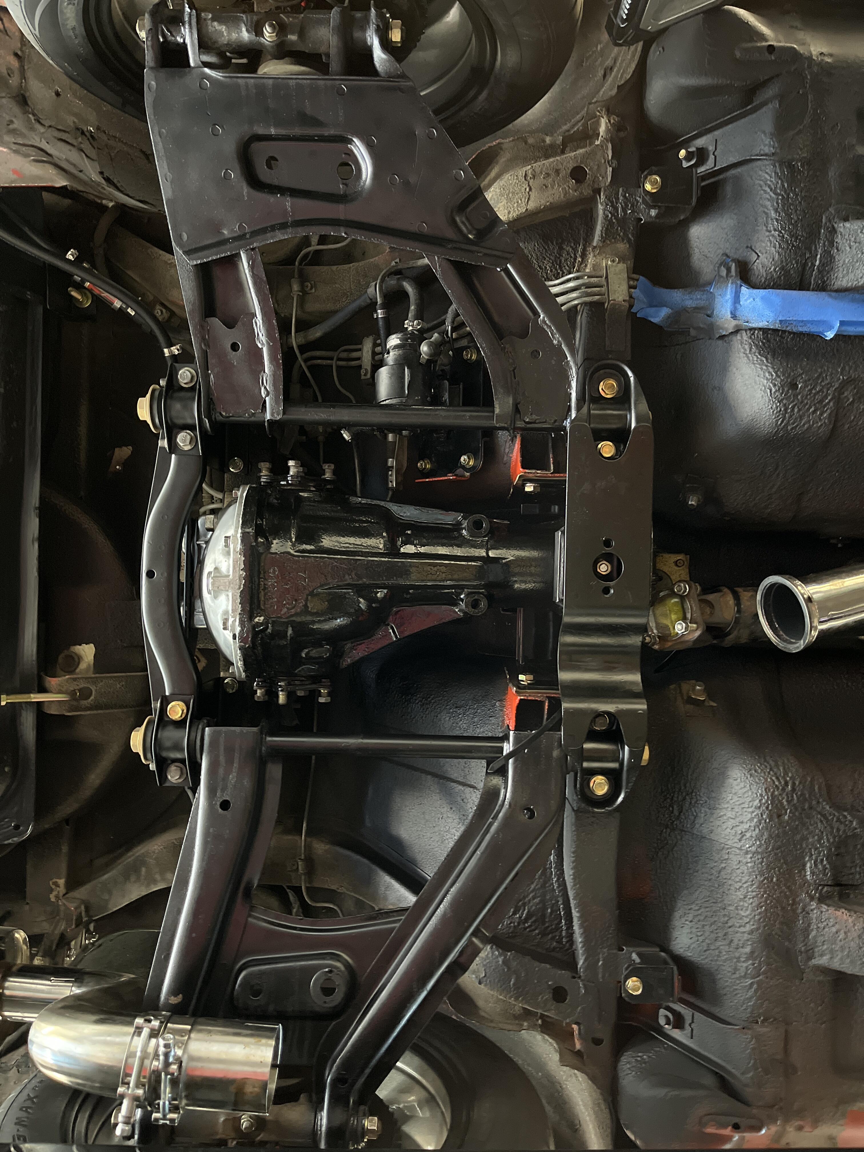

April 25, 20223 yr Author Popular Post comment_639715 I wouldn’t wish this job on my worst enemy. It is very challenging to put this differential in alone. It weight upwards of 80lbs I’d guess and holding things in position while trying to get bolts in and tightened is no easy task. I really hope I like this 3.7 differential because it will take a lot to send me back in there. Link to comment https://www.classiczcars.com/forums/topic/66453-77-280z-restoration/?&page=8#findComment-639715 Share on other sites More sharing options...
