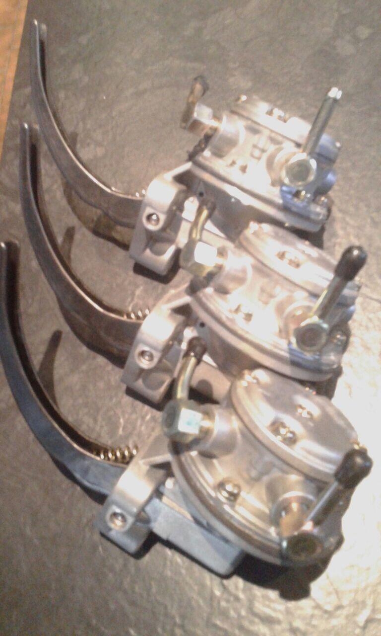

Same here yesterday!  I (softly) hit the fuelbowls with a hammer and there it go's!  At first it starts and dies after 20 seconds (about.. )  Haha i suspected bad (worn) needle-valves OR a to low pressure fuelpump.. i think i have to put on one of my new nissan pumps..
I got one for sale still orig. (nissan 6 cyl. pumps.) in the box.
When there is no fuel in the filter it looks like a defect pump to me.. i got fuel in mine but still had the problem of dry floatchambers..
