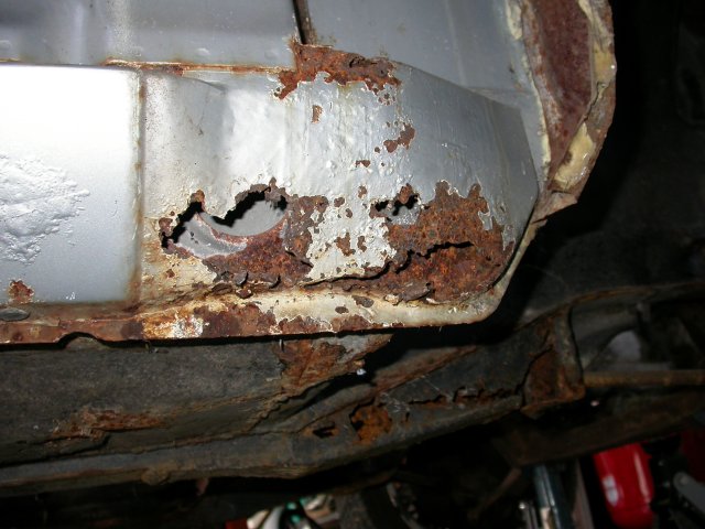

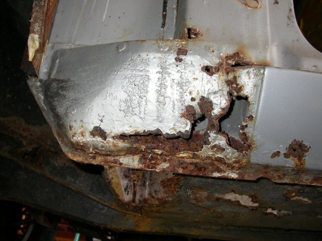

Well, I knew I had rust problems, but I found some nasty stuff today. I finally pulled the front fenders. I knew that the PO had replaced the fender with factory parts, and they still looked good. No rust apparent at the rocker on them. There were a few rust bubbles on the rocker itself, but not too bad. So, here's a pic of what I found under the front fenders. The rocker ends are pretty much gone. Don't know how you can see this area without pulling the fender, but if you see ANY rust on the rockers, beware of this area.
First, the passenger side:
Very common place for rust. Good pictures and a warning to go with them.
Looks like your rails and pans are pretty much gone too. Got some fun work in front of you, but at least there are replacement parts available for what you have shown.
If you look in My Gallery you'll find a couple pictures of my under fender area with an extended hose. That's what you have to do to extend the cowl drain so that it doesn't dump all the crud and water into this area of the fender.
Unfortunately, that's the MAIN reason this kind of rust happened.
2¢
