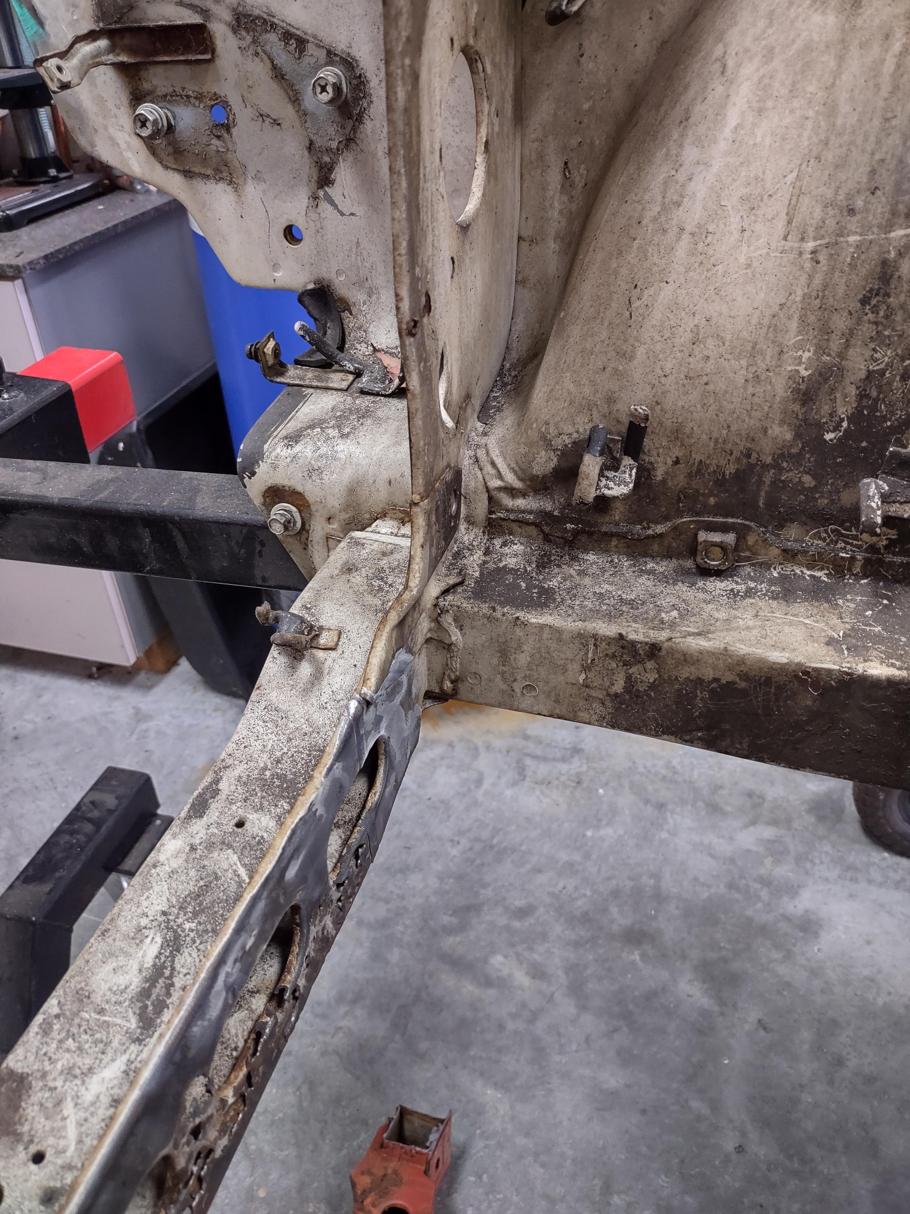

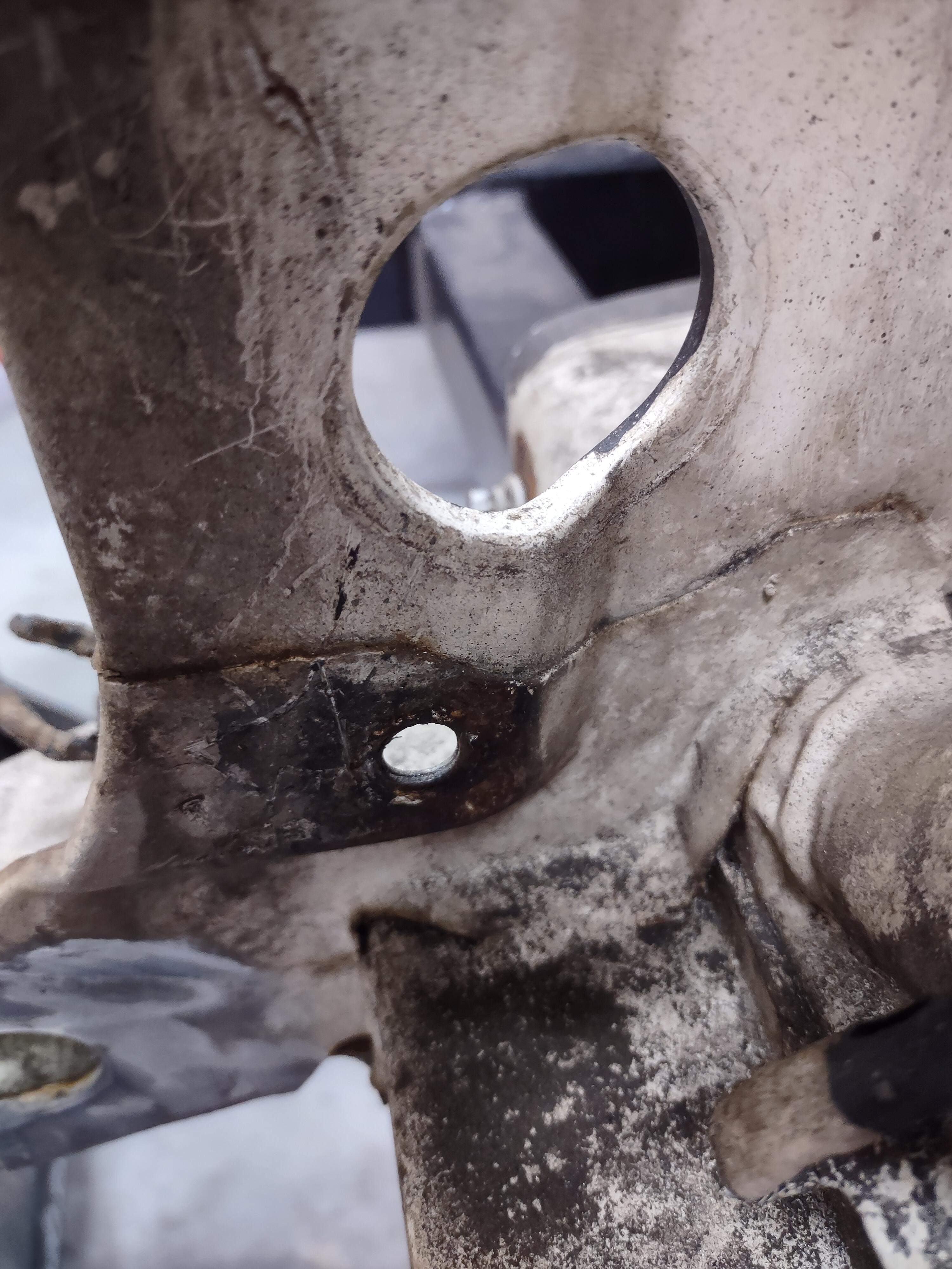

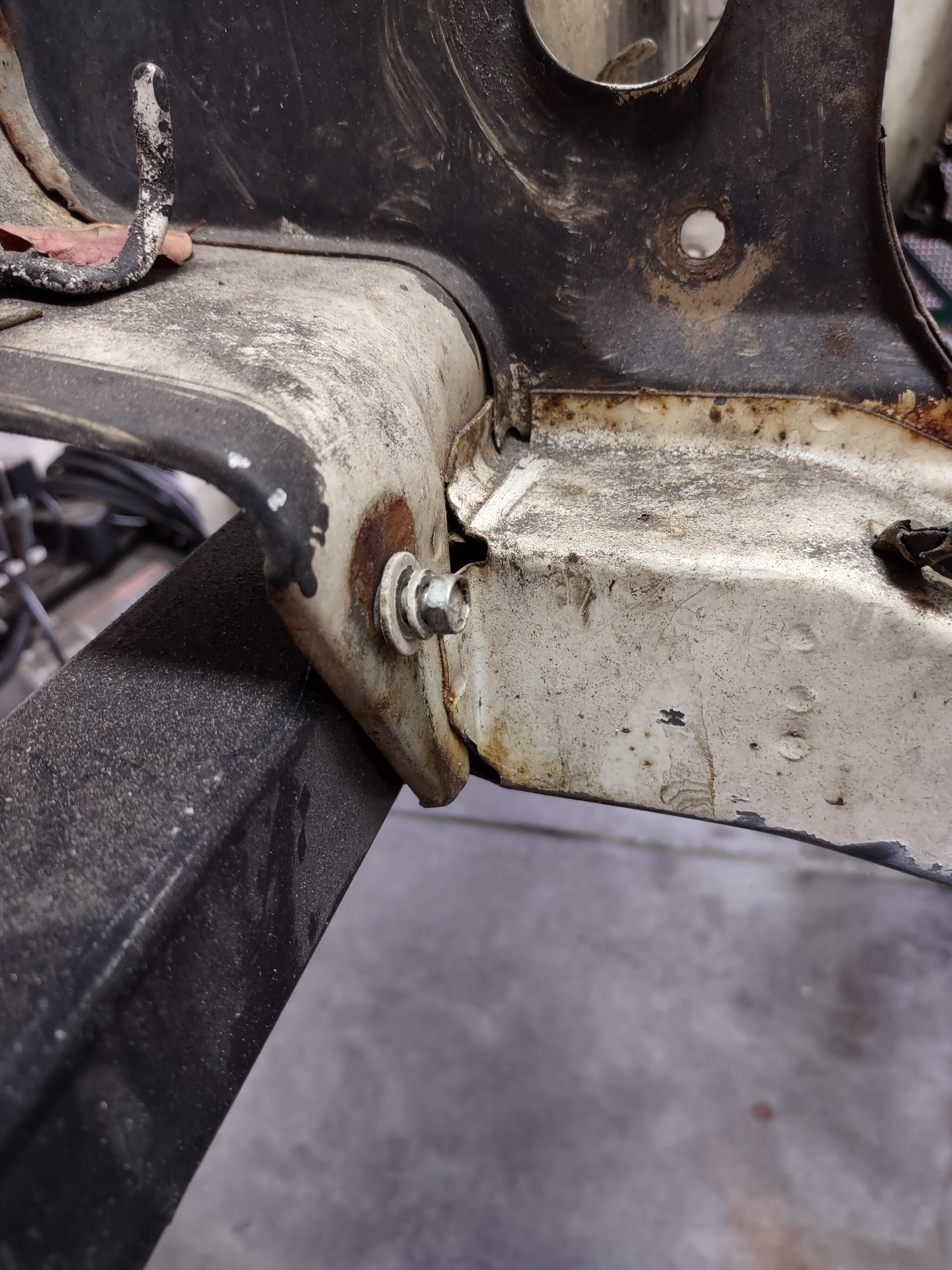

Anyone like to discuss disassembly technique where the frame rails and lower radiator supports are welded together?
It looks like a necessity to dissemble the lower radiator support at the very least to get new frame rail up in there. Lucky for me I need to replace the inboard (rear) lower radiator support piece that has the lightning holes in it anyways.

I would think its like the other panels of the car, a couple of spot weld removers and a spot weld chisel (I like Lisle 51900) to start the party.

I agree with heyitsrama, spot weld cutter(s) and a spot weld chisel or panel knife.  I had to remove the entire radiator core support from my '72 when I crashed it back in 2010.  Took a while and a lot of swearing, but it came out.  I also had to remove the right front frame rail as that was bent too.

Did you add supports anywhere when you removed the rails and radiator support?
CD871F:
I got both L and R frame rails and the radiator core support from a rear-end-totaled junkyard car and, after checking them out and cleaning them up, had a professional body guy weld them back into the car.  He had to fiddle with the inner fender too as it had gotten stretched in the crash.
I am a neophyte welder like you and would never attempt such an intricate and exacting procedure while learning.
