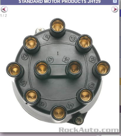

I did not know this.  I've seen the Z series in the wrecking yards but never noticed that it was tilted the other way.  Wonder why they did that.  They have two spark plugs per cylinder also and 8 terminals in the distributor cap.  It's an odd engine.  Apparently they were called NAP-Z here in the states.

Note: All USDM gasoline Z20, Z22 and Z24 engines were known as NAPS-Z (NAPZ or NAPS-Z Nissan Anti-Pollution System), NAPZ motors had dual spark-plugs (two per cylinder) except the pre-82 versions and latest versions of the Z24i as fitted to the Pathfinder. All NAPZ engines sold in California reportedly had dual plug heads regardless of the year.
Edited by Zed Head

The NAP-Z is a North American Production Z series engine. Not sure why they made an American dedicated Z series.
It's tilted to reduce height for the 720 trucks etc. Some people say it is to clear the brake booster, but I think that is more a  coincidence on the RHD cars. The brake booster is on the other side in LHD cars.
