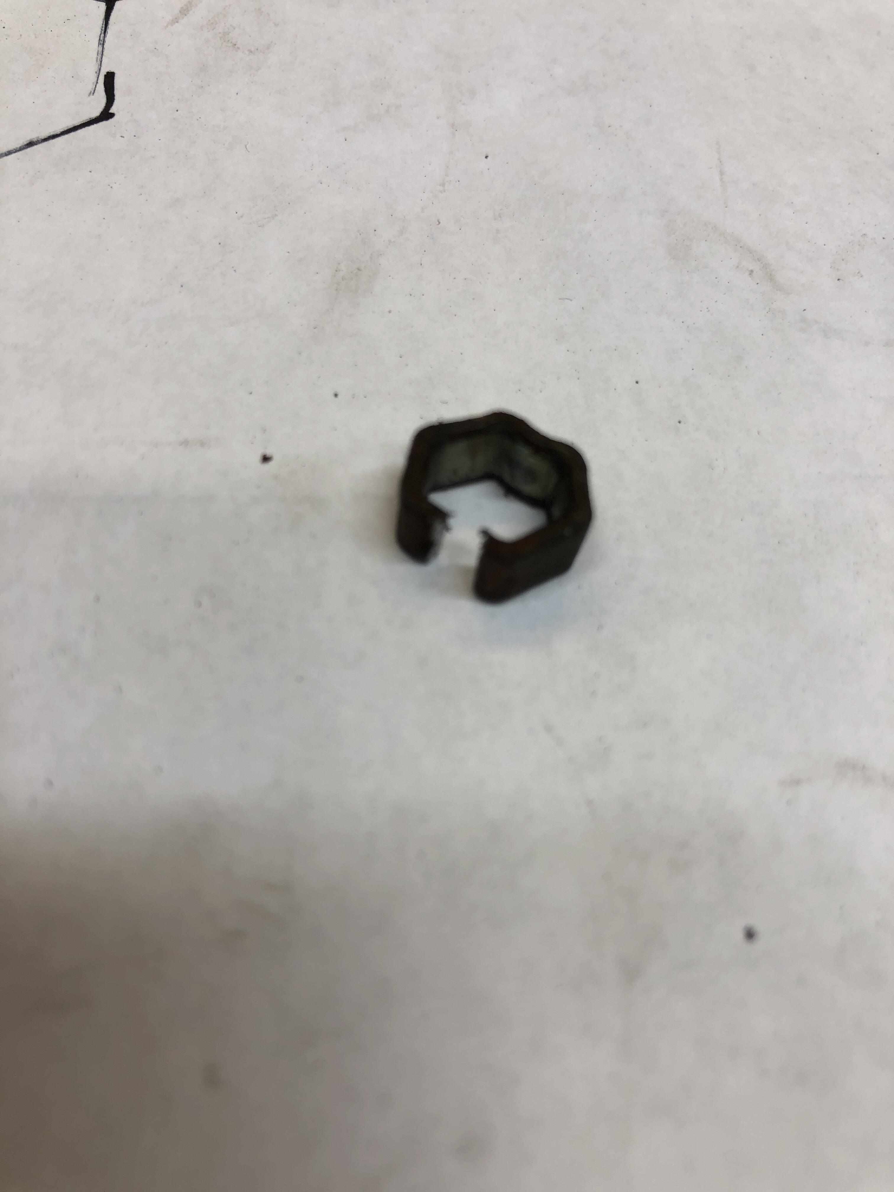

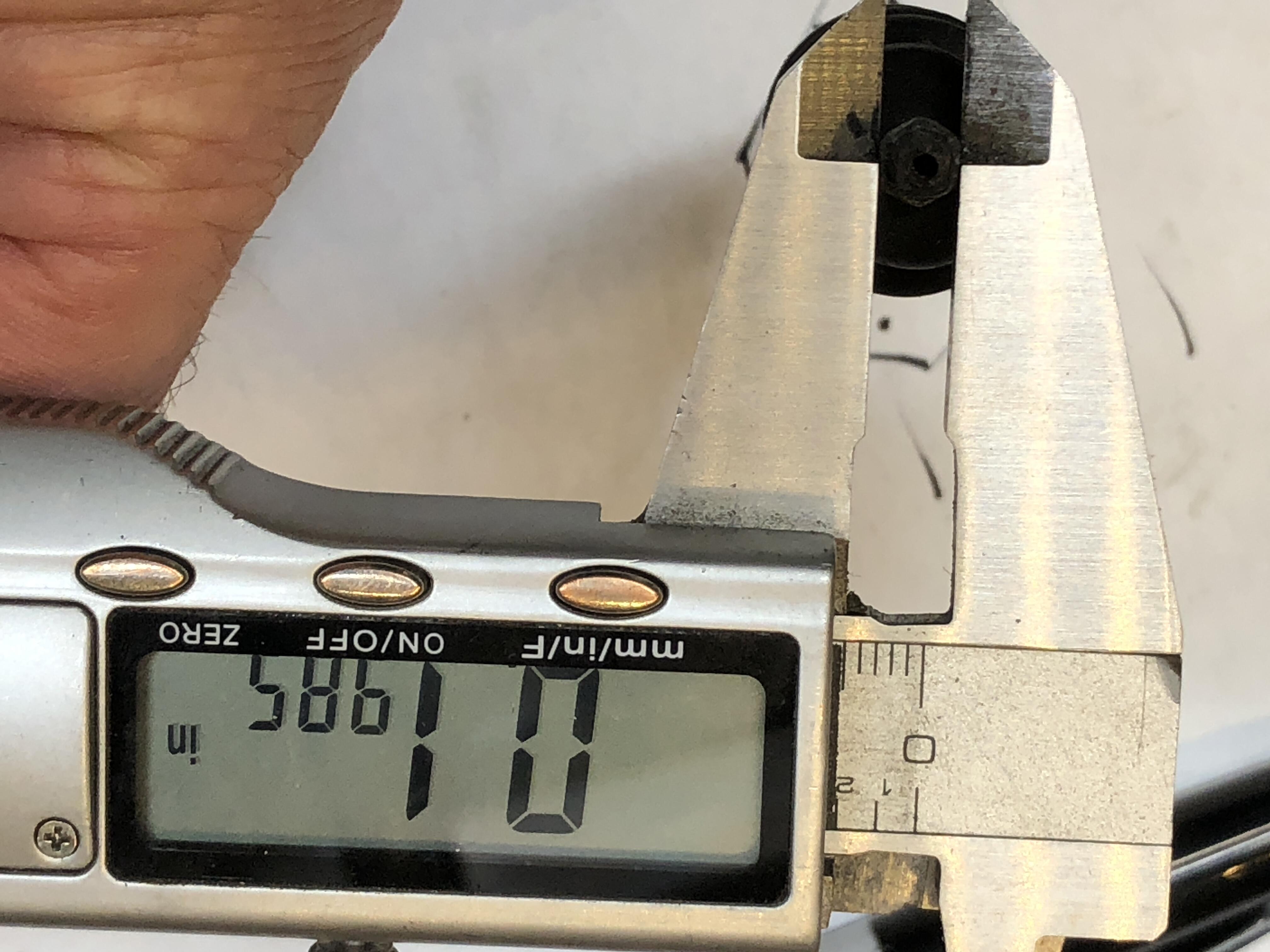

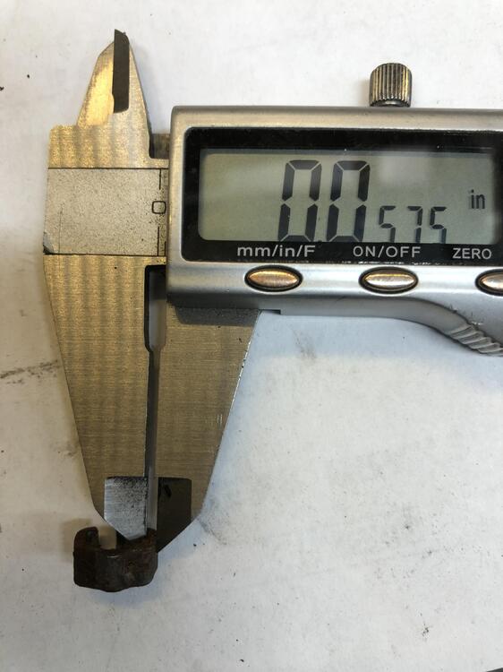

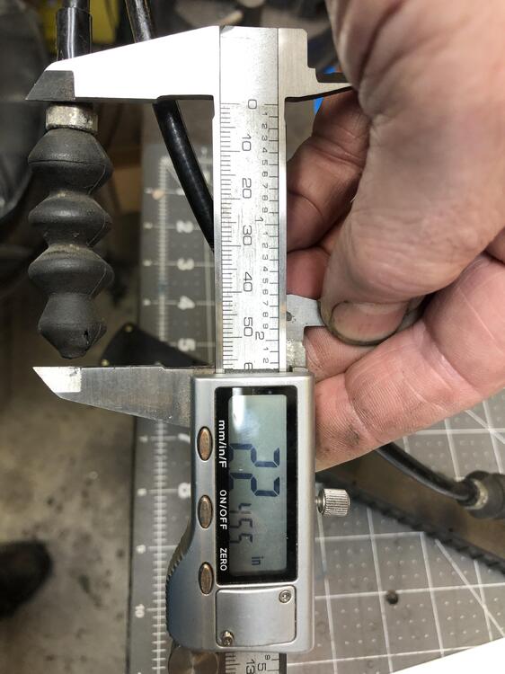

Thanks for the measurements.  The boots I have a bit small.  They are not as wide at the fat part of the bellows and they are only 1.6 inches long from end to end.  I put one on the cable and the id on each end is a good fit.  I think it is 1 mm id on one end and it is 6 mm id on the other.
Maybe the info here will help someone else, as my carbs don't utilize the later style cables with boots.

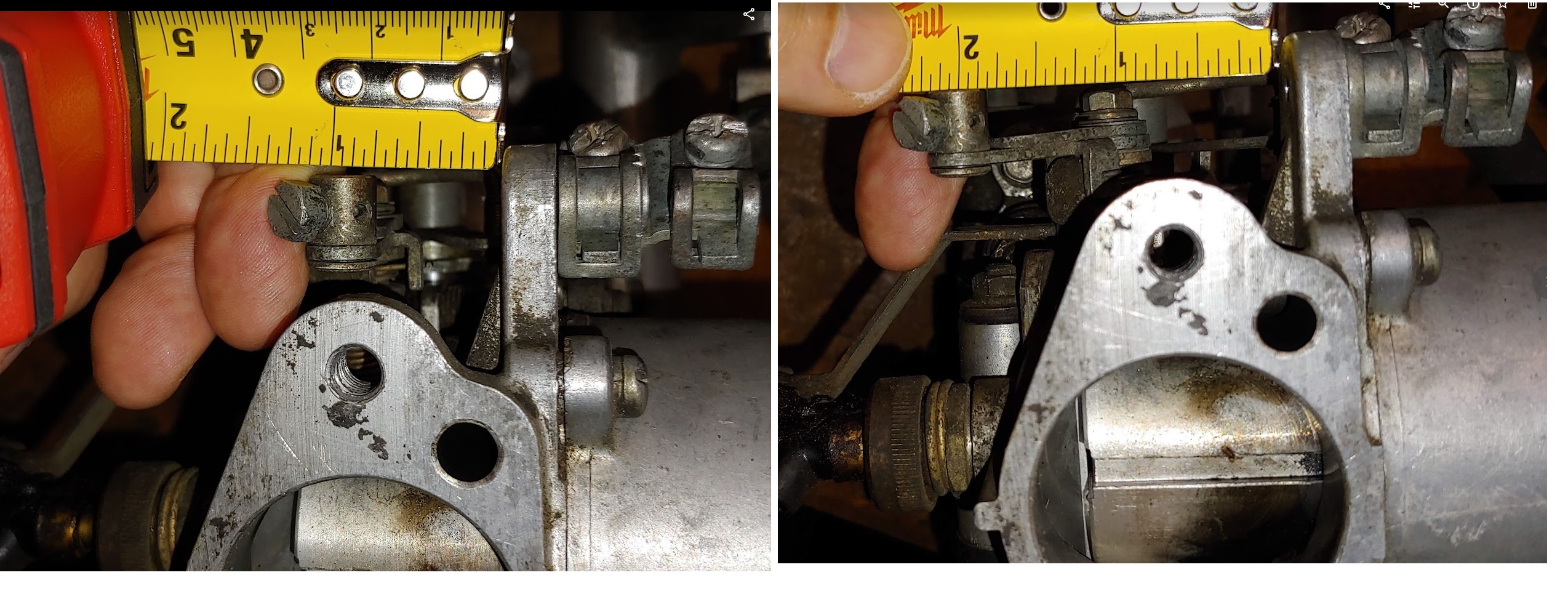

I'm also of the opinion that your car did not originally have bellows, as they appear to have started for the 1972 model year in 9/71. I have never seen what are called complete assemblies (early type) offered for sale with them. Not saying there is anything wrong with adding them.
Here are some measurements that might help with adding them, for anyone who is interested. The travel required for full motion of the choke linkage is 1-1/8" and the compressed length of the bellows must be 3/4" or less. This is based on open and closed measurements I just took from my carbs, and I also checked at the choke lever on a drawing from a parametric 3D model I created a few years ago.
Hope this info helps anyone trying to add bellows,
Cheers Mike
