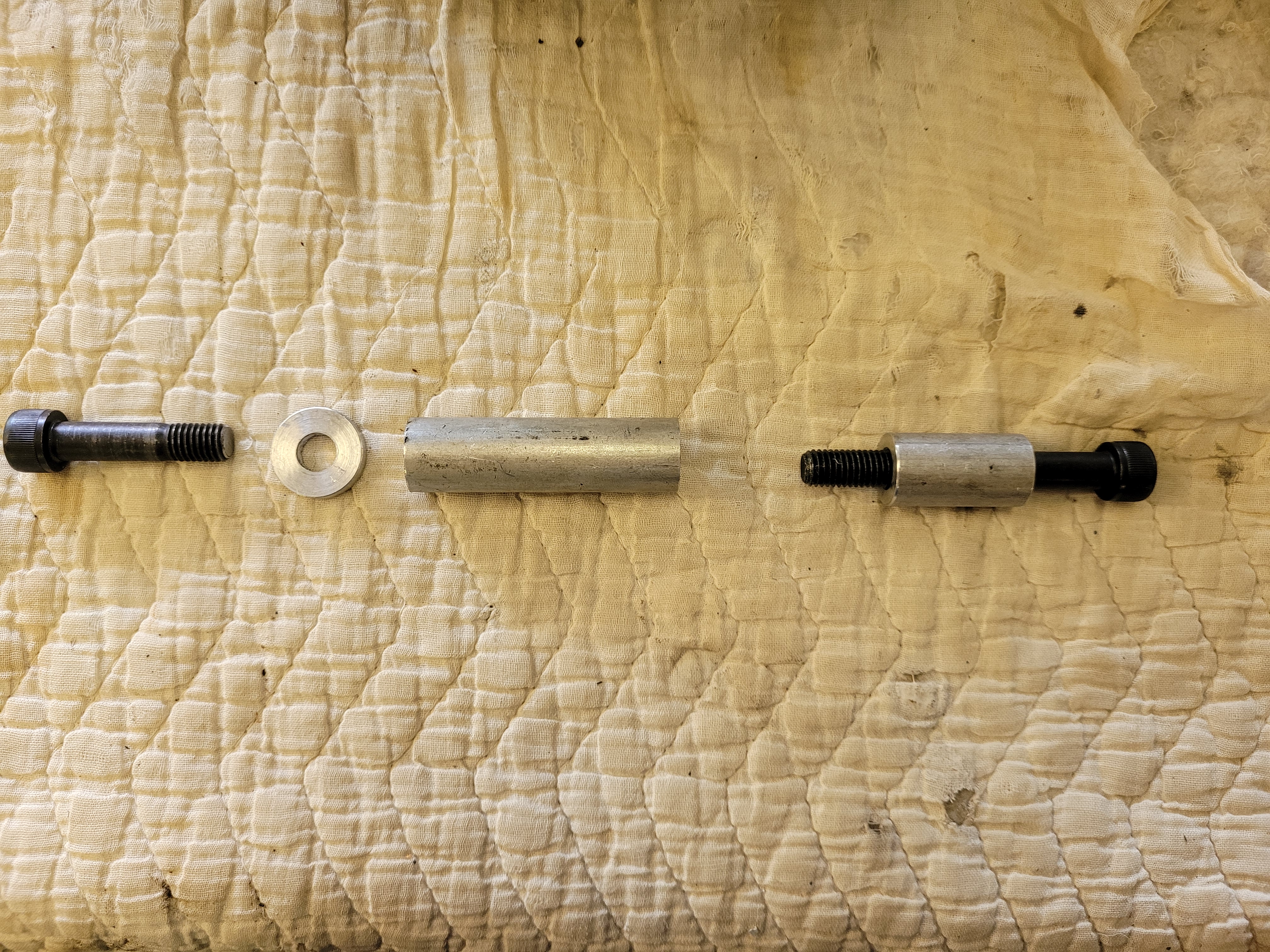

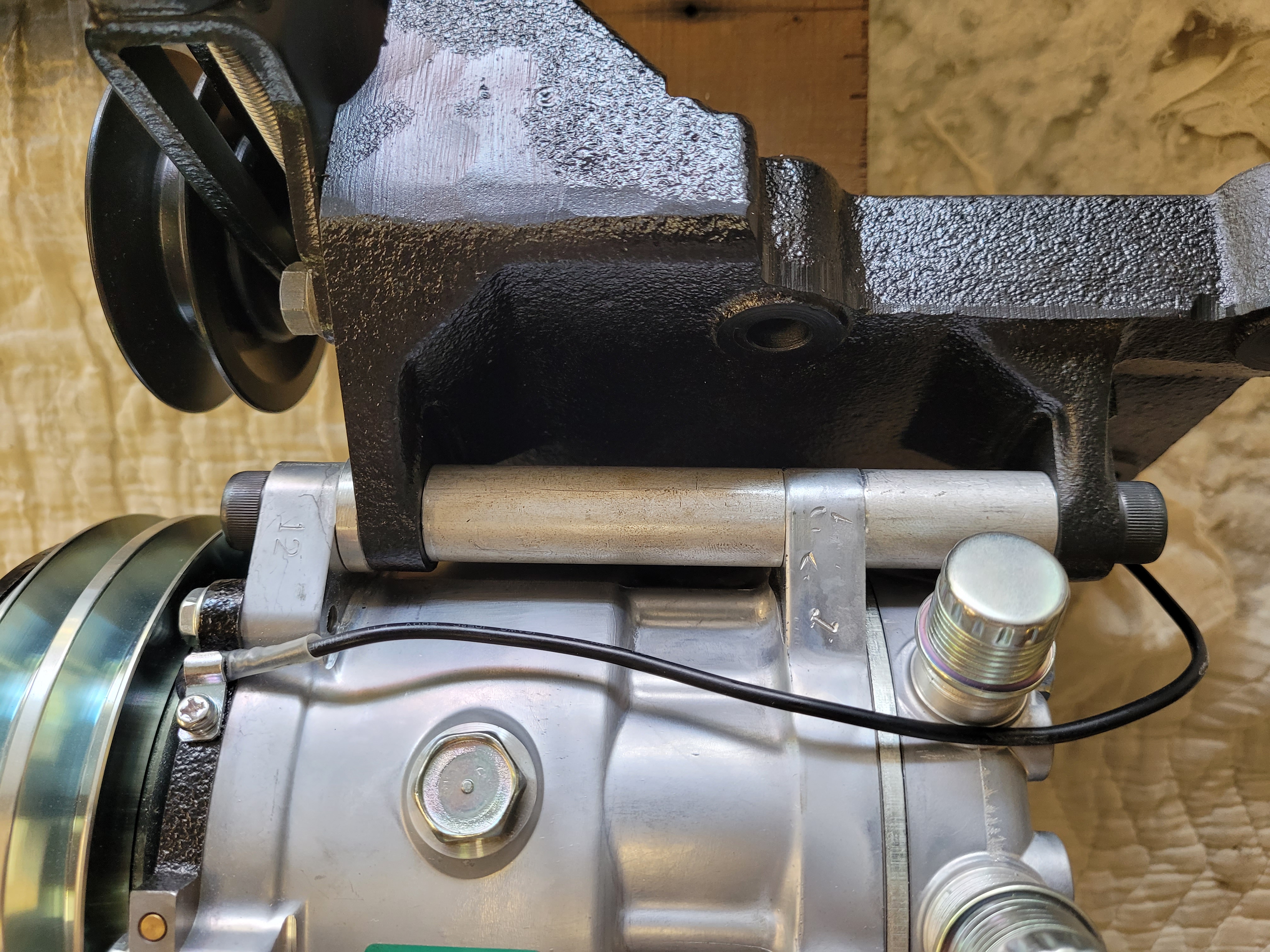

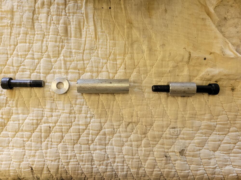

Please  ignore the two picture below if the show up. I somehow got them on this post and I can't figure out how to edit them out.
Edited by Cruzzar
Tried to remove pics
