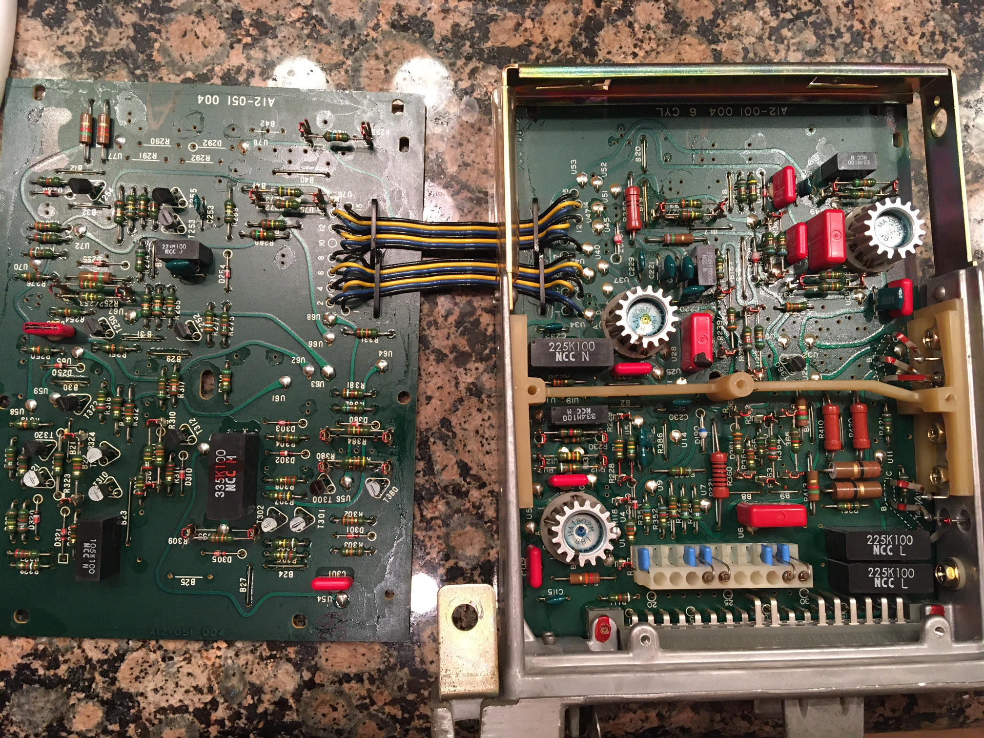

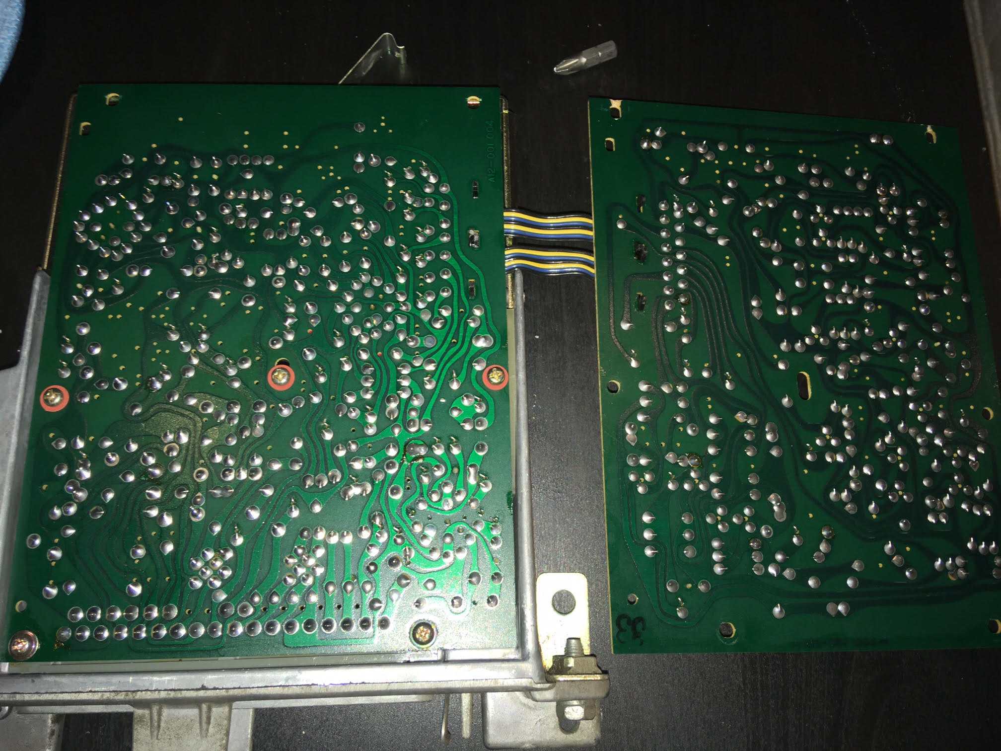

If you really wanted to test it, I would think it would prob have to happen very regularly, Have it opened up like above, have a test stand, and while the engine is running you could try thermal shocking it with some dust off to see if you could find a place on the PCB that reacts.

I will say I did not have the negative terminal REALLY cranked down as I was taking it on and off when working on it.  When I got home I popped the hood to look and the terminal was on there.  Before I removed the ECU I pulled the terminal off and it required some strength to do so but I still could.  The terminal and connector are in great condition.
